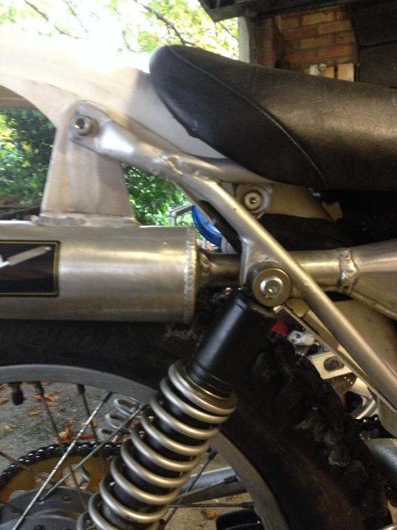

the rear shock upper mounting point

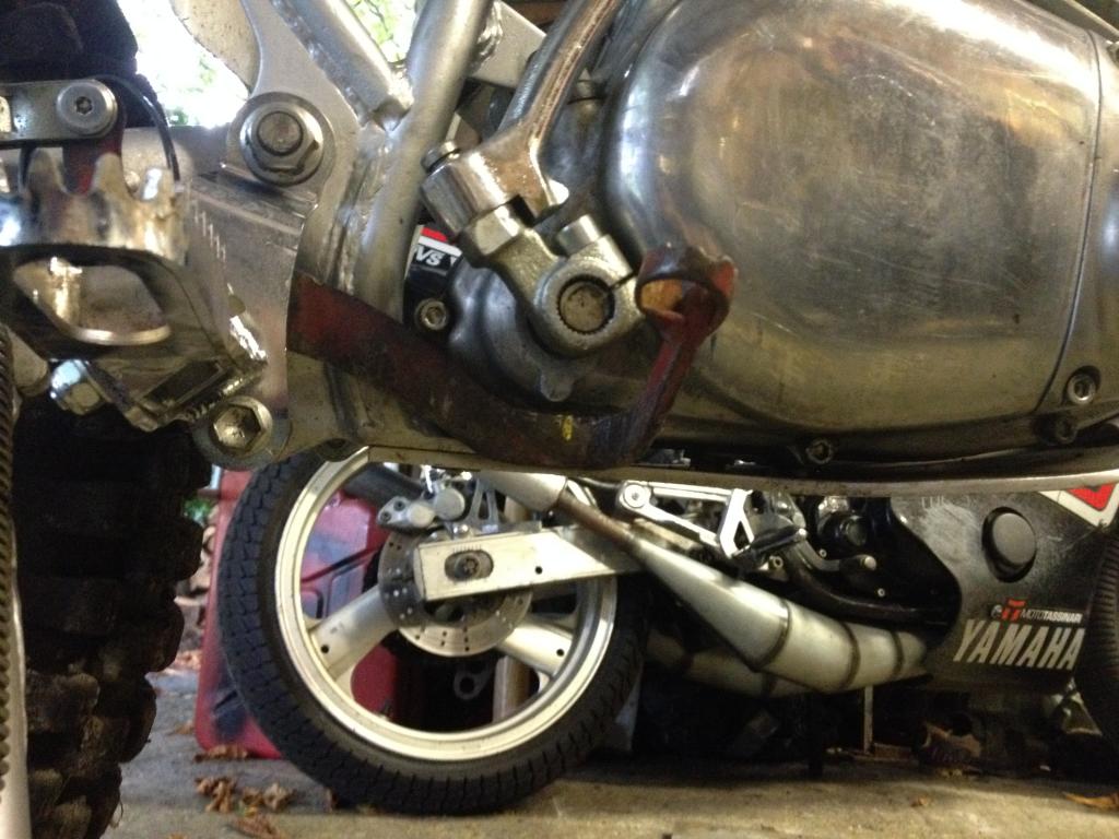

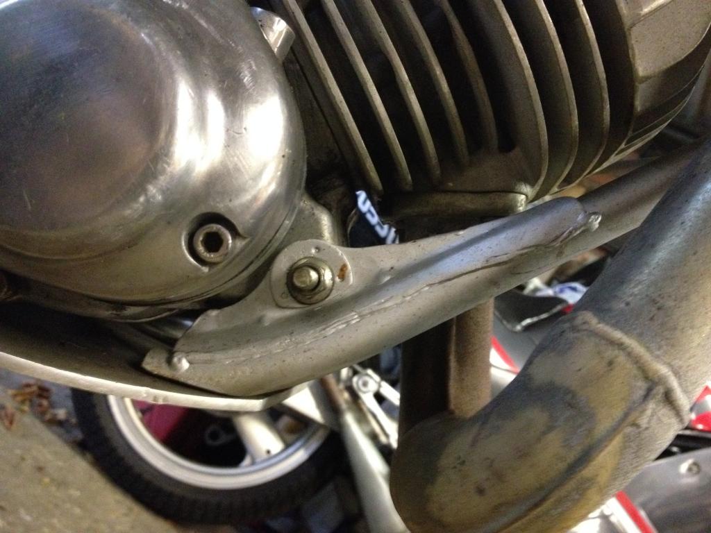

the front and rear bash plate mounting areas

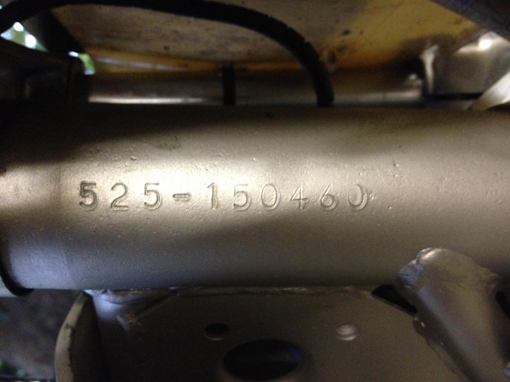

plus for your interest (?), the frame (which is the same as the engine!!
I notice that our rear shock mounting point is different....

Well.. the rear loop has been cut off and replaced with two end sections from another frame(the owner admitted doing this)the rear top shock mount is under the frame rail not through the rail ,the welding on the sump guard rear mounts did not look good
the rear silencer was off a maico motorcross bike .But it did have a alloy majesty tank and new genuine kickstart and
gear lever .Sorry if that's not what you wanted to hear but its only my opinon if you like the bike that's what matters
