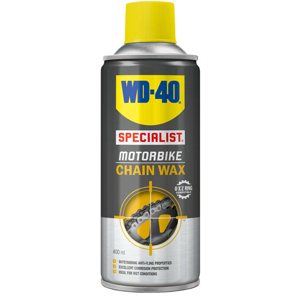

sawtooth Posted October 16, 2014 Author Report Share Posted October 16, 2014 (edited) Right, think I've found what I need: WD40 Chain Cleaner WD40 Chain Wax Cleaner cleans really well and the wax is very durable and does not fling, especially if left to cure over night. Just under £10 a can for 400ml so not too bad. Edited October 16, 2014 by sawtooth Quote Link to comment Share on other sites More sharing options...
