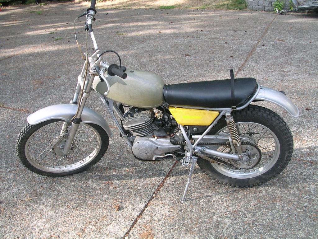

thats_a_five Posted July 31, 2014 Report Share Posted July 31, 2014 On the left side of your bike just below the red cover is a sight glass. That is for the 2 stroke oil. Pull the cover off and the plastic tank can swing out for filling. The throttle cable has a Y joint in the middle with one side going to the carb and one side going to the oil injection pump (on the right side inside the clutch cover you can see this cable going into the housing on your bike). You put straight 2 stroke oil in the oil tank and straight fuel in the fuel tank. No premix needed. For best grip, you want to run the tires really soft - In my modern bike I run 6 in front and 4 in rear. With older bikes, the tires can come off the beads at those low pressures. On my TY I run 7-10 in front and 7-8 in the rear, depending on trail conditions. Be sure to run rim locks and take the nuts off the valve stem. Reason: as the tire slips around the rim, it will pull the tube with it. If you leave the nuts on it will eventually tear the stem from the tube which is virtually impossible to repair. Of course that will happen at the farthest point from the tuck on Sunday when no cycle shops are open. With the nut off, you can see the stem start to lean and then get sucked into the rim, giving you a warning to reposition the tire and tube before it tears the stem off. 1 Quote Link to comment Share on other sites More sharing options...
pat_56 Posted July 31, 2014 Author Report Share Posted July 31, 2014 (edited) That's_a_five, I Like the look of those pegs, I think I can make that happen to mine. Hmm, Don't think I've seen that tank on a TY before? nice how your seat fits the frame so neatly. The whole package kind of has a Euro vibe, up to the tell tail Yamaha exhaust guard. Your bike looks well set up and personalized, I think I can identify with your comfort level with having tailored it to your needs but it has been a long time since I have had a machine that fits that bill for me, I find it takes time and miles to build a relation ship with a machine although I am rather fond of my Ninja 900. Oh ya, riding around will certainly occupy the bulk of the remainder of this year, we have endless trails starting a few hundred yards up our street. As Spencers comfort level picks up I will gradually lead him into mildly irregular terrain and there is a favorite little grove with lots of tree roots and a few small flat rocks that we used to trek around in as a slow control exercise which challenged his Honda 70 because of the small wheels. I am not nearly as daring as my desire to be would suggest, at my age I have a keen appreciation of how badly I land and how much it hurts that keeps the fulfillment of my stunting fantasies well in check. FYI, the little shot of me doing the stopie that comes up as my profile is photo shopped - My right leg is on the ground and I blotted it with a photo editor, the little bike wasn't even running. I looked in the little tool box, it only has a spark plug in it but the spark plug is in a very old box marked Genuine Yamaha Parts. Tonight I made an air filter from a foam lawn tractor filter I stitched the sides with my sewing machine, turned it inside out and ran a bead of silicone over the seam. I stretched it over the original filter basket and the edges shrank over the open end nicely so they folded under when I put it in place, coated with oil of course. I will order a couple originals this week. I tried to take a link out of the chain but found it would not have been long enough if I had by about 1/8 inch so it looks like Chain and sprockets will be on the early list too. I also installed new fuel line and a filter. Then puddled around on it for 5 or 10, the little thing works quite nicely. Later, Pat Edited July 31, 2014 by pat_56 Quote Link to comment Share on other sites More sharing options...
pat_56 Posted July 31, 2014 Author Report Share Posted July 31, 2014 On the left side of your bike just below the red cover is a sight glass. That is for the 2 stroke oil. Pull the cover off and the plastic tank can swing out for filling. The throttle cable has a Y joint in the middle with one side going to the carb and one side going to the oil injection pump (on the right side inside the clutch cover you can see this cable going into the housing on your bike). You put straight 2 stroke oil in the oil tank and straight fuel in the fuel tank. No premix needed. For best grip, you want to run the tires really soft - In my modern bike I run 6 in front and 4 in rear. With older bikes, the tires can come off the beads at those low pressures. On my TY I run 7-10 in front and 7-8 in the rear, depending on trail conditions. Be sure to run rim locks and take the nuts off the valve stem. Reason: as the tire slips around the rim, it will pull the tube with it. If you leave the nuts on it will eventually tear the stem from the tube which is virtually impossible to repair. Of course that will happen at the farthest point from the tuck on Sunday when no cycle shops are open. With the nut off, you can see the stem start to lean and then get sucked into the rim, giving you a warning to reposition the tire and tube before it tears the stem off. The oil injection was disconnected when I got the bike and I have no plan of putting it back in use as I don't know exactly why it was disconnected in the 1st place. So it looks like Pre Mix is the way I am going to roll. Wow, I had no idea the tire pressures were run that low! Good tip on the inner tube, I will check those wheel related items out tomorrow. The tires have lots of tread but lots of cracks besides. They hold air well but if they start to become a problem I will replace them with a good set. Quote Link to comment Share on other sites More sharing options...
thats_a_five Posted August 1, 2014 Report Share Posted August 1, 2014 When I bought the bike, about 4 year ago, it ran great but needed a lot of love to get it into good riding condition. The long seat was an option from Yamaha when it was new. They sold that seat and a kit of parts to reposition the footpegs, shifter and brake pedal for using the bike as a trail bike. It’s funny but after riding modern trials bikes with no seats for so long, I forget I can sit when I ride the TY. The bike came with the metal tank that was damaged and poorly repaired and rusty inside. It also came with the plastic unbreakable tank. That was an aftermarket tank in the 70’s. I put one just like it on the Honda enduro bike I was riding back then after playing trial rider and dropping the bike with the tank right onto a sharp rock. I could fix the metal one but since this is used as a “buddy bike” and “new rider test bike” I leave the plastic because it makes the bike pretty bullet proof. I recently made some lower peg mounts and extended the swing arm. Super stable now. Fun bike. Front brakes are still more of a suggestion to the wheel to slow down. LOL. That’s why I did that funky bend on the lever so I can use 2 fingers and pull it all the way to the bars. I don’t dare ride a bike with 900 cc’s. I know I would want to use all that throttle. You are so very lucky to have all those trails close to your house. I just drove 120 mile round trip today to build 2 sections for an upcoming trial in September. I laughed out loud when you explained that stoppie pic. Quote Link to comment Share on other sites More sharing options...
thats_a_five Posted August 1, 2014 Report Share Posted August 1, 2014 Yes, a lot of guys disconnect the auto-lube and run pre-mix. I think the mix should be about 50:1. Search the Yamaha forum for oil or pre-mix. I am sure you will get a lot of info that others have posted about what they like and use. For trials, most people go to a smaller front sprocket. Before you throw out the existing chain and sprockets, search the Yamaha forum. You don’t have to change them all at the same time unless they are really badly worn. Smaller front sprocket makes it easier to ride slow and may give you that 1/8” you need to remove one link from the chain. Cool, original plug in original box. Collector’s item? You gonna get your boy on it this weekend? Bill Quote Link to comment Share on other sites More sharing options...
pat_56 Posted August 1, 2014 Author Report Share Posted August 1, 2014 As a matter of fact The boy just asked if we could go out tomorrow as I was logging onto the computer! I have read about someone who used an 11 tooth on front, a 51 on the back and liked it. Currently it has a 13 front and 51 rear. The front is in pretty good shape so must have been replaced. I think it was just used for a trail bike. I plan to order a 12 for the front, a 51 rear and a new chain, keep the 13 for a spare and trash the rest. I don't know what it is about the 11 tooth but it just looks so tiny and low in circumference, it may not be an issue but there are so few teeth engaged at a time? Just my O.C.D. coming out I guess. Any way, 1st gear is so low that I can't imagine requiring less speed than what it currently has so; I will try the 12 and keep the 13 which looks like new in case I want to go back (for all the difference it will make). I have had my 900 doing about 140 mph which is red line in 3rd gear and just basically what it whips up to when enthusiastically passing a car or two on the 4 lane. Hitting it in 2nd gear while doing 60 (be careful or the wheel may lift) takes you to just over 100 mph, give 3rd and 140 is a second and a half away. From a stop she will hit 140 in 10 seconds, that's a quarter mile. Red line is 12,000 RPM for a claimed and doable (I am told) top speed of 187 mph which is where the rev limiter kicks in. Transmission is a 6 speed, bike weighs about 400 making 150 hp crank and 130 hp at the wheel.... and that's Nothing! BMW has a bike making 197 rear wheel hp! However top speed is limited the same as mine and it is only about 1/10th of a second quicker than mine in the quarter mile, it is however infinitely more sophisticated. Also, the BMW speed limiter can easily be bypassed giving it a top end of Well over 200 mph... Where as mine is geared so red line makes the rev limiter kick in (in theory) at 299 kilometers per hour which is where all the manufacturers have agreed to limit their bikes for some time now. So in the case of my bike 299 kmph / 187 mph is all it can do - adequate for commuting I guess. You can change sprockets but then it will not pull red line in top gear, so to me my bike has achieved ultimate balance with no excess: Red line is all she can pull at top allowable speed. The Kawasaki in fact was the 1st mass-produced land machine on the planet to get under 10 seconds in the quarter mile straight out of the show room with stock tires, under a professional driver, even beating out larger displacement bikes for several years to come. If you are sharp and can hang on to it, she is capable of 0-60 mph in under 3 seconds, and it only takes 1st gear (actually 1st will do 75 mph). I however am not that "sharp". 1st gear it will lift the wheel at just over 1/4 throttle, wheelie violently at over 1/2 throttle and punch you in the face with the windshield if you snap it open (or break loose and smoke on down the road). All the above is just bragging rights. Having it I feel I own a piece of Iconia (my word for owning an Icon). The 900 was a signature number for Kawasaki from the 70's and my bike is from the last year they made an ultimate performance 900 which was 2003. It is comfortable and rock solid. In the later years of production it lost to the competition on the track but was unanimously recognized as the best rocket bike for the street, of all the open class super bikes. Alas, people buy numbers and sales suffered until finally Kawasaki made a whole new bike; the ZX10R which shared nothing but a name with the ZX9R. It was faster and better on the track but not as good a street bike. If I was younger and still progressing I might not feel sad, but in a strange manor I really identify with this bike, it maxed and is holding fast. No matter who do what comes next it will always be the 1st to do what she did, set the standard for many years and still is still one Heck of a machine! 20,000 miles and still on the original chain and sprockets adjusters have moved only 2 marks, chain and sprockets are showing no ware. I bought it unseen from Ontario 6 years ago. I flew up to get her, threw my leg over the saddle and my 1st test drive was just over 1000 miles long - and I enjoyed every step of the way. Highway mileage is over 60 mpg. Quote Link to comment Share on other sites More sharing options...

copemech Posted August 4, 2014 Report Share Posted August 4, 2014 If that tank is cherry or repairable by a dent guy I would shelve it for a Sammy Miller glass tank/ seat so the kids can have a go! Just sayin' Quote Link to comment Share on other sites More sharing options...
