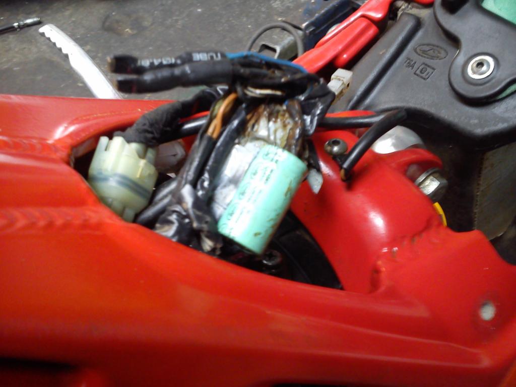

Fan was running erratically last night at a trial. Would run, then stop, then slow, then run etc
Bike was getting very hot so called it a day to save damage
I've had a look on Tc forums and seems to be capacitor ?
Assumption correct?
If so, exactly where is it located, and likely source for new one?
Many thanks
John
Link to comment
It's located in the wiring loom near the carb, I think it's to the left hand side tucked in near the frame, If I remember correctly. The capacitor you need is 4700uf 25v, Or you can use a high voltage, On our bike we have a 35v one fitted, Only difference is the fan spins a bit quicker, You can buy them from Maplin or eBay, Or any decent electrical shop, They are about £1
If it is the capacitor that has gone wrong, The fuel tap won't work on the correct position (Upwards) either, Check for this.
Link to comment
took capacitor off tonight and one of the terminals had snapped off - so hopefully an easy fix !
Got to say all of the wiring was soaked tho - so better waterproofing to try when I rebuild !
thanks for the help
cheers
John
