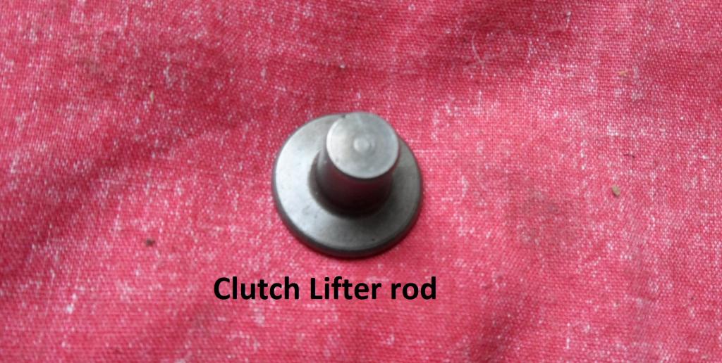

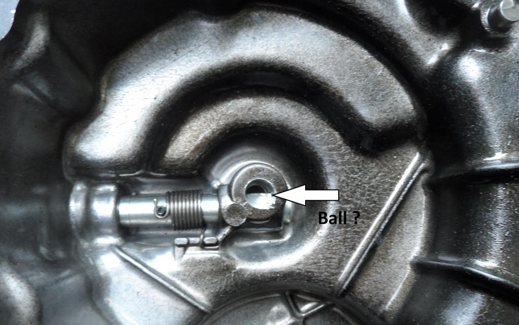

sicco Posted July 13, 2014 Report Share Posted July 13, 2014 Today i removed my clutch assembly. After reassembly i think i'm missing a bearing ball witch should sit between the Lever clutch and the clutch Lifter rod. Can anyone confirm that there should be a sort off bearing ball in that space. I'm afraid it's rollled in the engine. Quote Link to comment Share on other sites More sharing options...
zerorev3rev4 Posted July 13, 2014 Report Share Posted July 13, 2014 is there enough space for a ball ,i think you need to look at a parts manual , but personally it doesnt look like there would be enough space and the markings left on the pusher dont look as if a balls made them as it would have a shiny indent in the centre Quote Link to comment Share on other sites More sharing options...
windwelder Posted July 13, 2014 Report Share Posted July 13, 2014 Hi, No ball fitted just the mushroom against the flat of the shaft. The mushroom doesn't spin as the outer edge of the mushroom presses against the inner race of the bearing mounted in the centre of the clutch. Quote Link to comment Share on other sites More sharing options...
