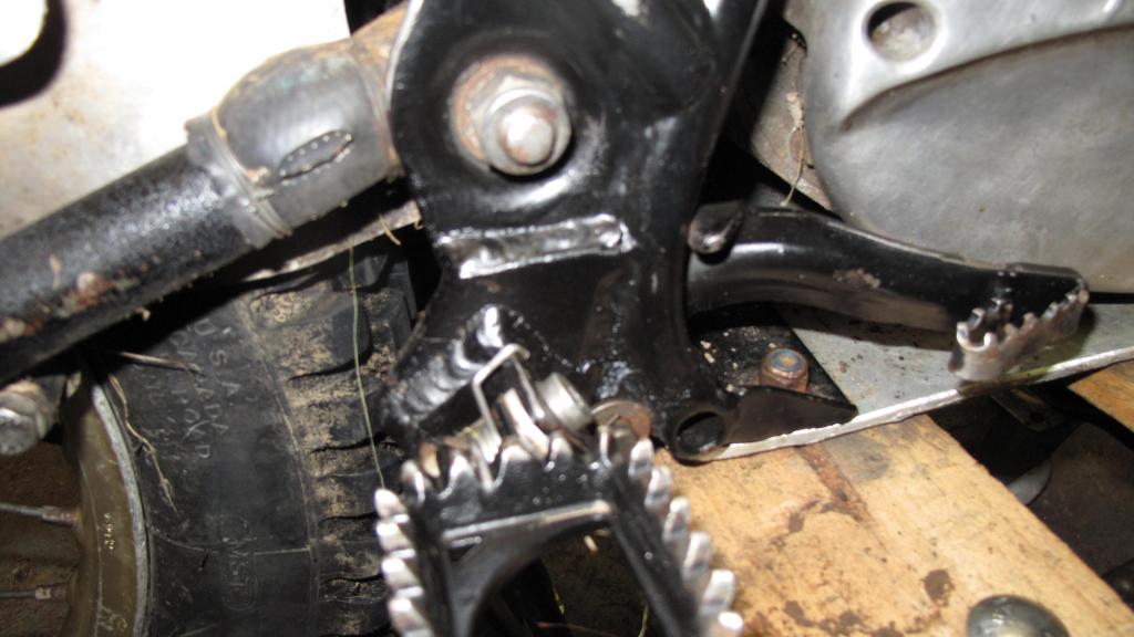

wobbler Posted August 14, 2014 Report Share Posted August 14, 2014 exhaust picture ....it just screws straight in John - the footpeg pictures + S3 hardrock pegs 1 Quote Link to comment Share on other sites More sharing options...
johnmartin247 Posted August 14, 2014 Report Share Posted August 14, 2014 Thanks Wobbler, will modify the second bike foot pegs as i have just got the first frame back from the powder coaters, I believe that kawasaki kdx200 pegs fit the existing brackets with a little grinding. I hope. Quote Link to comment Share on other sites More sharing options...
wobbler Posted August 14, 2014 Report Share Posted August 14, 2014 John - I wanted mine down and back. I'm sure you could do something with a Montesa 315 or beta hanger. Cheers The Wobbler Quote Link to comment Share on other sites More sharing options...

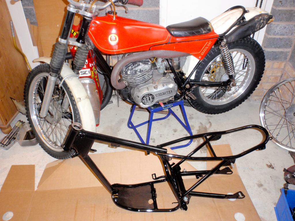

johnmartin247 Posted August 14, 2014 Report Share Posted August 14, 2014 Just been given some S3 pegs to try to see if the could be made fit, good news is that it looks positive that they can be adapted. Here is the frame sitting beside bike number two. Quote Link to comment Share on other sites More sharing options...
mags Posted August 14, 2014 Report Share Posted August 14, 2014 That fresh frame looks like the start of something fantastic to me!! Beautiful! Mags Quote Link to comment Share on other sites More sharing options...
johnmartin247 Posted August 15, 2014 Report Share Posted August 15, 2014 Keep tuned in Mags as that is my intention, pictures will follow as it progresses. Quote Link to comment Share on other sites More sharing options...
