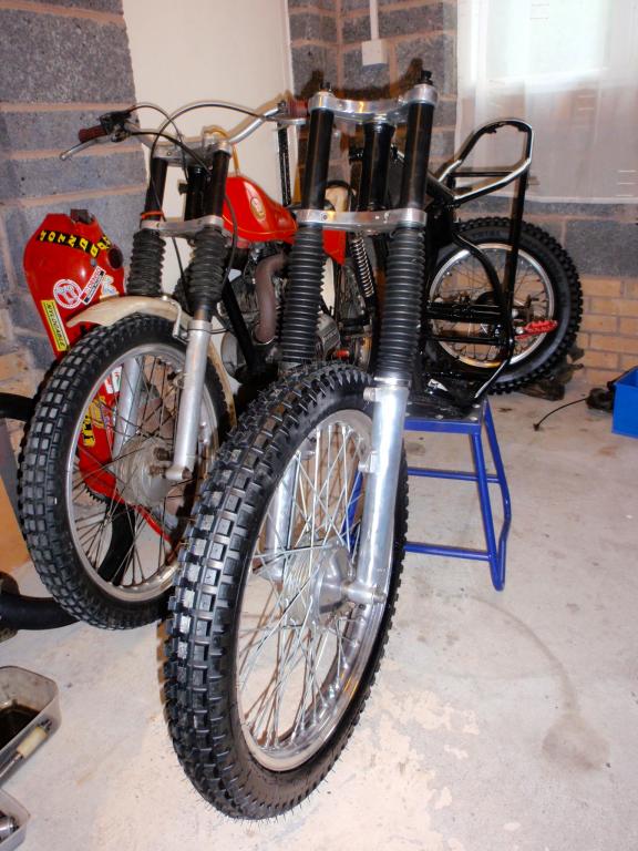

johnmartin247 Posted August 16, 2014 Report Share Posted August 16, 2014 Forks rebuild for me tomorrow, all stripped,cleaned and polished, just had to get the fork oil this evening. Quote Link to comment Share on other sites More sharing options...
pro sport Posted August 16, 2014 Report Share Posted August 16, 2014 Whilst working on my Mk4b today I noticed the spacer on the front engine mounting point on the frame but like Steve's it is on the left lug which would move the exhaust nearer the down tube - but I have plenty of clearance like john's photo's ? ? ? Steve, your barrel look to be the correct type ! John you have done the same as me with the foot pegs , a little bit of grinding on the mounts and the lugs on the pegs, just got to sort out some return springs for them..... But it saves welding plates on for the bracket type foot pegs generally available. Will post some photo's of my refurb in the next few days when it's back together. Cheers Dave 1 Quote Link to comment Share on other sites More sharing options...

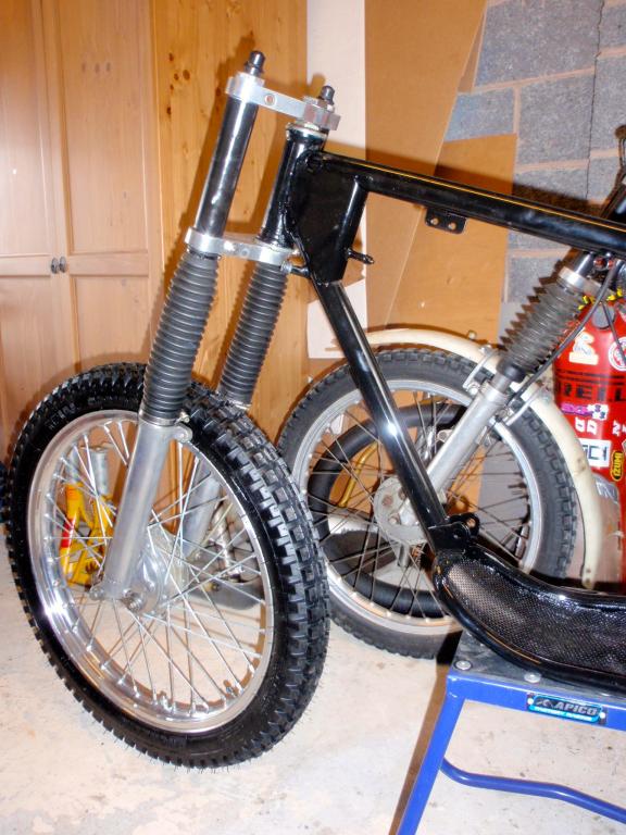

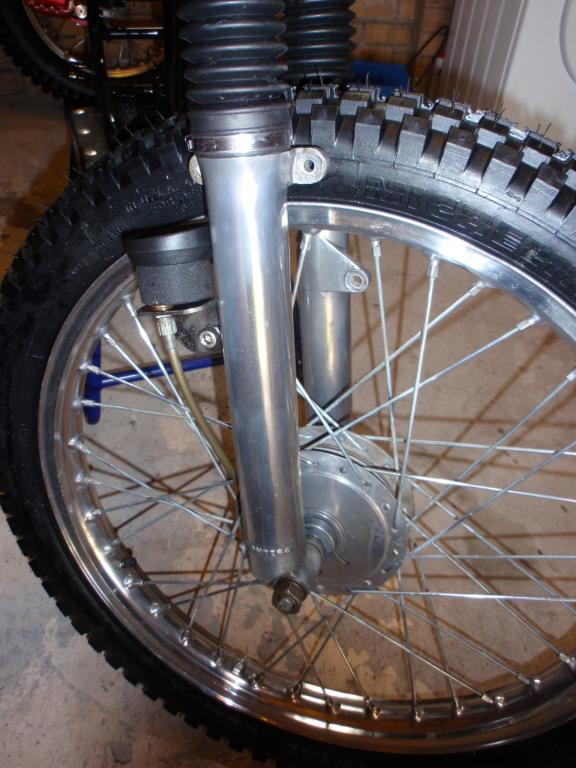

johnmartin247 Posted August 17, 2014 Report Share Posted August 17, 2014 Had a busy morning rebuilding forks but can tick that job off the list, now fitted along with front wheel. 1 Quote Link to comment Share on other sites More sharing options...
wobbler Posted August 17, 2014 Report Share Posted August 17, 2014 John - great job , but you'll need sunglasses on its that clean !!!! Keep the updates coming !!! I'm trying to get some heads up on how to get a better clutch set up !!' Any help welcome . Cheers The Wobbler 1 Quote Link to comment Share on other sites More sharing options...

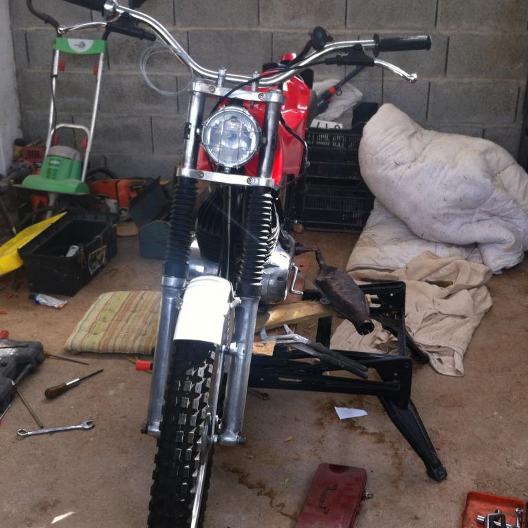

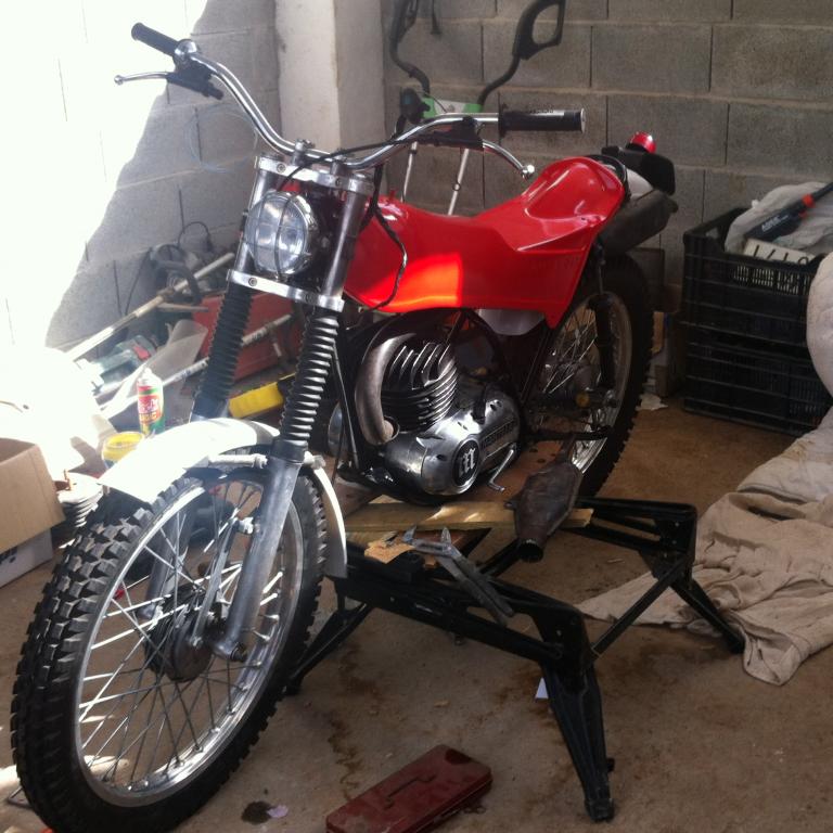

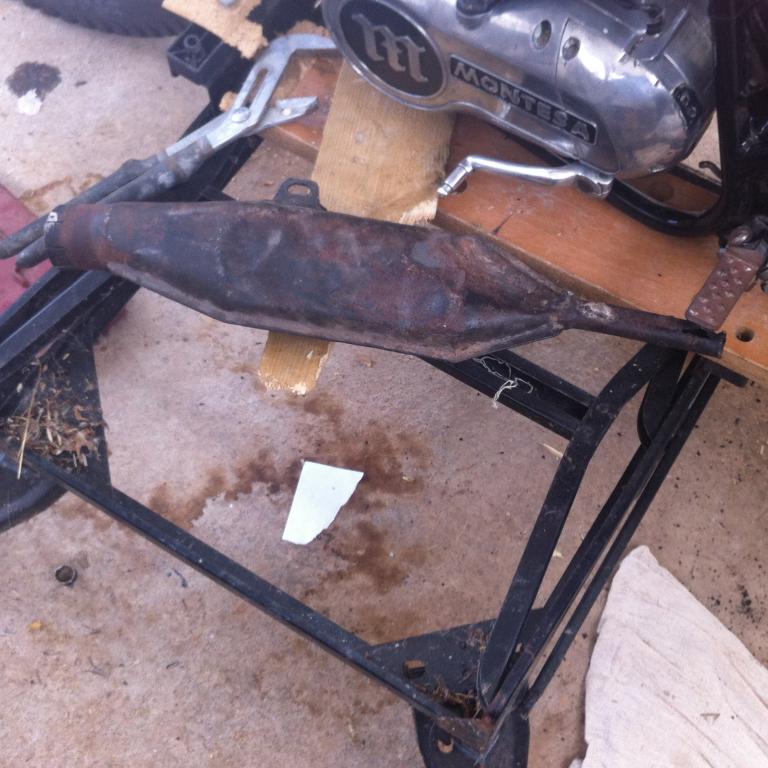

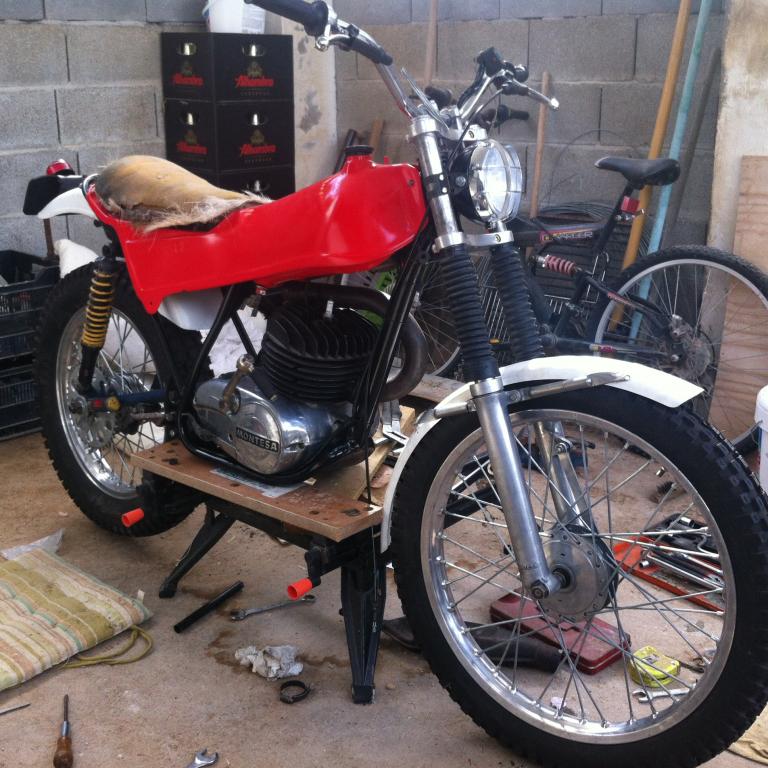

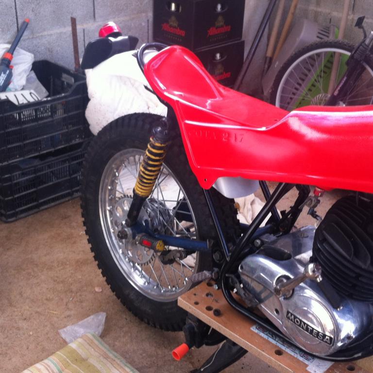

quo 1 Posted August 18, 2014 Author Report Share Posted August 18, 2014 Hi Busy day on the dry build, I now have a better iidea of what i need, carb, ive found new Amal on a spanish website,but the seller wont answer emails By the way how much is the mikuni option and where can i buy it? seat which i cant seem to find anywhere.any ideas anyone ,shocks etc There is a new speedo, but it looks like its off a different model,the hole for the cable is round while the cable is square. The header pipe is fitted but i had to lift the engine up out of the mounts slightly,its just touching the frame with the engine back in situ, its something i can live with, On the picture of middle silencer,is this the correct piece?,I bought header pipe and this off ebay in England and a mate brought it over, the headers ok,the silencer looks it been used as a anvil. Also im not happy with the paint job on the tank, so ill flatten that off and re do, Sorry if ive bored you Cheers Steve 1 Quote Link to comment Share on other sites More sharing options...
johnmartin247 Posted August 18, 2014 Report Share Posted August 18, 2014 Hi Steve, carb can be got at www.inmotiontrials.com £135.00, are you sure about the speedo as most have square drive inner cables and the round hole may square off inside, as far as the seat goes I have not seen them any where, one of my bikes has the same seat and tank unit, the other is the small seat/tank unit. Your build is looking good, keep up the updates, I have been polishing the engine block and casings this afternoon and painted the cylinder head yesterday but it looks more like a matt finish than the silk finish that i thought i had bought, can always go over it again. Cheers John. Quote Link to comment Share on other sites More sharing options...
