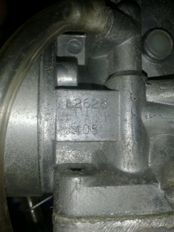

quo 1 Posted August 19, 2014 Author Report Share Posted August 19, 2014 Steve, have a look at amalcarb.co.uk the 626 type seem to be for Triumph and BSA from what i can see, you want a 627 1973 onwards. Cheers John. Hi John i had 627 wrote down,thought it might be for later models but suitable steve Quote Link to comment Share on other sites More sharing options...

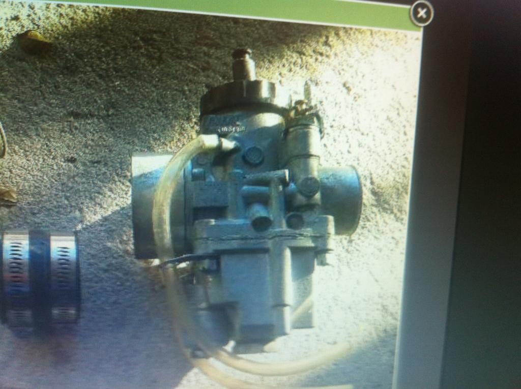

quo 1 Posted August 19, 2014 Author Report Share Posted August 19, 2014 sorry its 625, cant find it on Amal website,but looks like a mk11 concentric, which seem to be universal,you just re jet and get correct manifold kit. is 25mm big enough?,the lad selling it says it is for a 247. I appreciate everyones help. i dont want to buy wrong parts Quote Link to comment Share on other sites More sharing options...
quo 1 Posted August 19, 2014 Author Report Share Posted August 19, 2014 sorry its 625, cant find it on Amal website,but looks like a mk11 concentric, which seem to be universal,you just re jet and get correct manifold kit. is 25mm big enough?,the lad selling it says it is for a 247. I appreciate everyones help. i dont want to buy wrong parts these pics are the sellers off the website Quote Link to comment Share on other sites More sharing options...

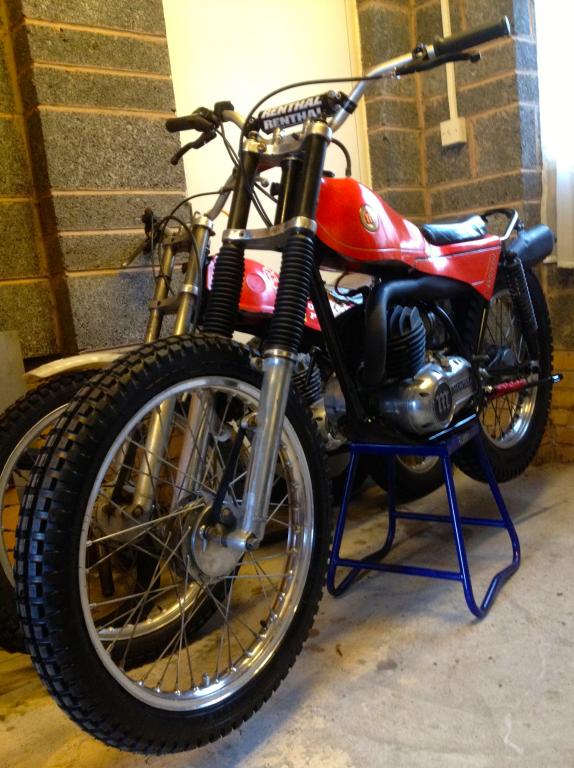

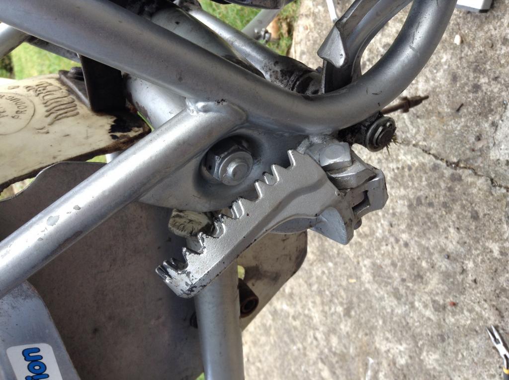

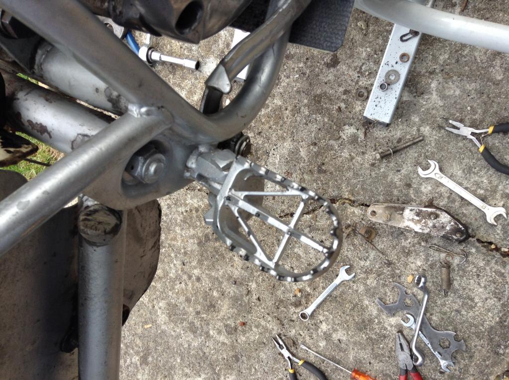

pro sport Posted August 19, 2014 Report Share Posted August 19, 2014 Hi John These are the footrests that I fitted , fair bit of grinding on the original lugs ot make them fit. Just need to sort return springs ! as you will see from the next photo 1 Quote Link to comment Share on other sites More sharing options...
pro sport Posted August 19, 2014 Report Share Posted August 19, 2014 (edited) These pegs can tilt up out of the way and they tend to stick up, I would hate for it to stick up mid section and when I went to put my foot back down on it and it not be there......... Finished my off season refurb so posting a photo on the 'show your mont thread' Edited August 20, 2014 by pro sport Quote Link to comment Share on other sites More sharing options...
johnmartin247 Posted August 19, 2014 Report Share Posted August 19, 2014 Hi Dave, I had a look yesterday at the return springs from the original pegs, it was not going to be a straight forward job looking at it, so I will come back to that job later when every thing else is done. cheers John. Quote Link to comment Share on other sites More sharing options...
johnmartin247 Posted August 19, 2014 Report Share Posted August 19, 2014 (edited) these pics are the sellers off the website Steve, just checked both my bikes and the carbs are both 627's, i think by the time to try to re-jet and get the manifold for it you would be cheaper getting the carb from In Motion @ £135.00 Edited August 19, 2014 by johnmartin247 Quote Link to comment Share on other sites More sharing options...

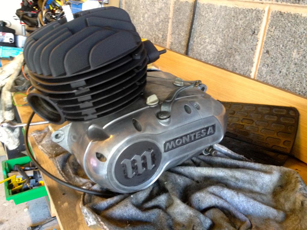

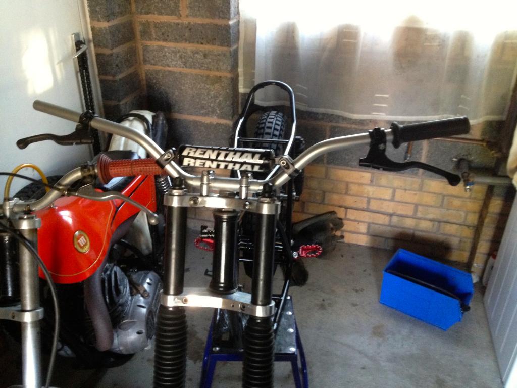

johnmartin247 Posted August 24, 2014 Report Share Posted August 24, 2014 Been fitting new rear sprocket and handle bars today as well as painting up the engine. Waiting on new shocks to come, along with front and rear mudguards. Quote Link to comment Share on other sites More sharing options...

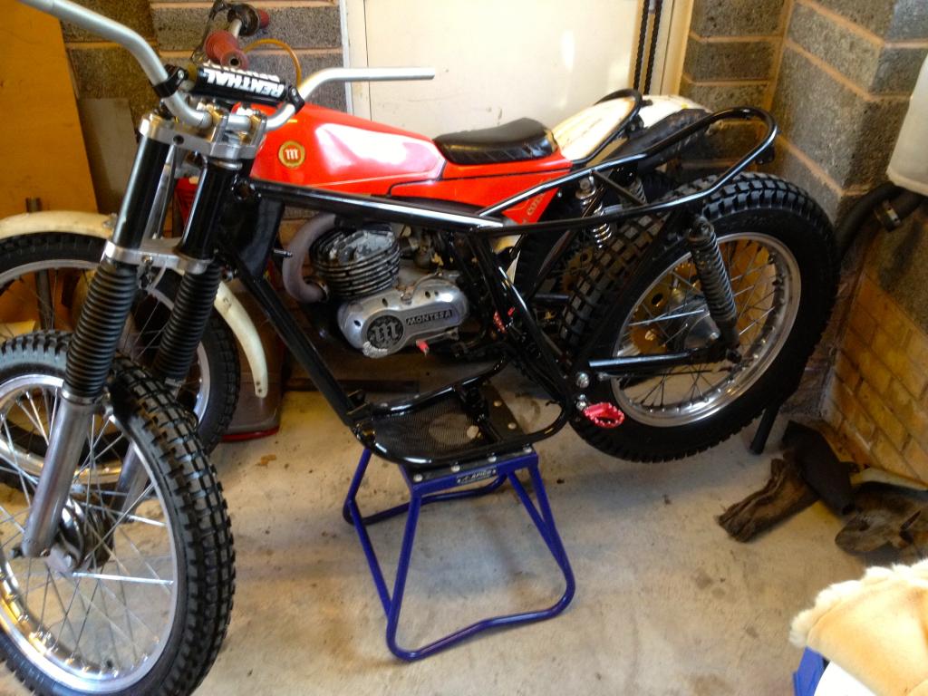

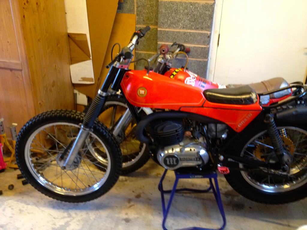

johnmartin247 Posted August 25, 2014 Report Share Posted August 25, 2014 Been hard at it again today, engine back in and exhaust fitted, new oil and air filter, running lovely, sat the tank seat unit on it but it will be going to get painted soon. 2 Quote Link to comment Share on other sites More sharing options...

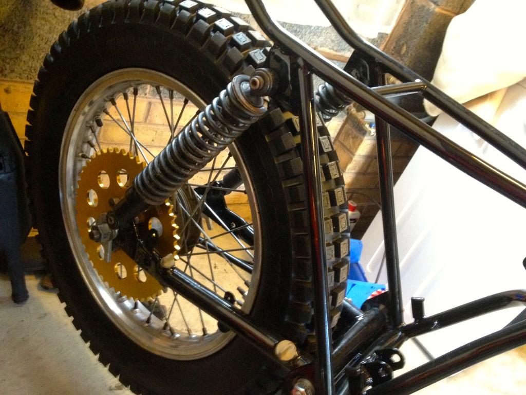

johnmartin247 Posted September 1, 2014 Report Share Posted September 1, 2014 After fitting rear wheel with new tyre and sprocket I found that the wheel was not running true, spokes being 35 year old it did not look like a good bet that it would true up. So off to local wheel builder for a new set of spokes and nipples and a rebuild, good excuse to get the hub cleaned to match the spokes and the rim. Cheers John. Quote Link to comment Share on other sites More sharing options...
