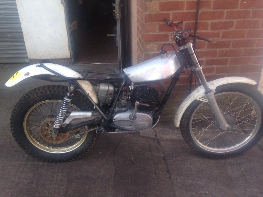

johnmartin247 Posted September 19, 2014 Report Share Posted September 19, 2014 Hi Steve, the old cups were a bit of a challenge to get out, i used a old 18 inch socket extension to drift them out. The dual seat bike is not road registered, it is the other one that is registered. Let us know how you get on. Cheers John. Quote Link to comment Share on other sites More sharing options...
johnmartin247 Posted September 22, 2014 Report Share Posted September 22, 2014 A wee update, new seat unit should be here tomorrow and the tank/seat unit is off to a custom painters who is more than eager to do the job, if it is half as good as he says it will be I will be delighted, he is talking gold leaf instead of gold paint for the coach lines on the tank and finished off with high gloss lacquer. cheers John. Quote Link to comment Share on other sites More sharing options...

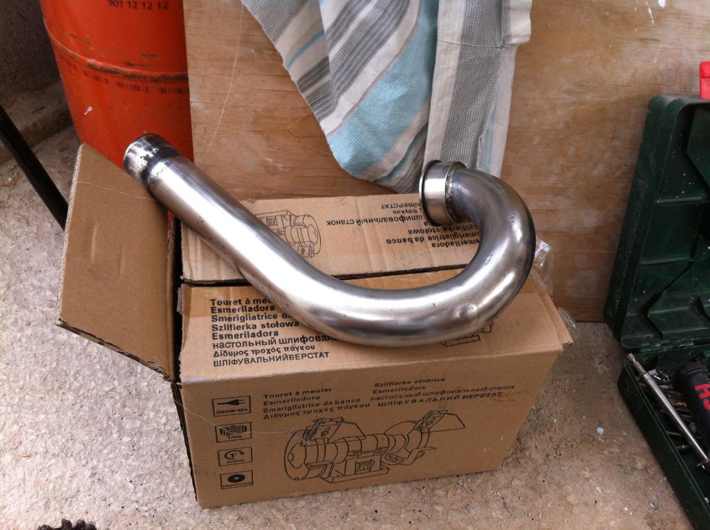

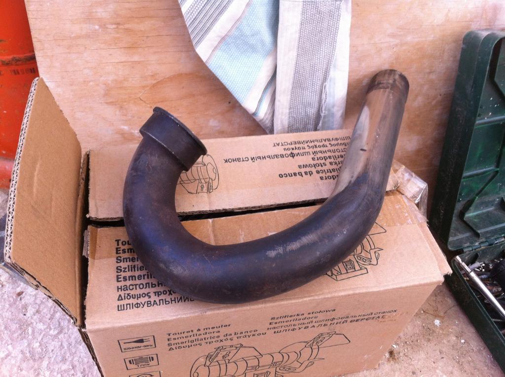

quo 1 Posted September 22, 2014 Author Report Share Posted September 22, 2014 Hi Well, after about 2 hours and god knows how many attempts i finally got the bearing cups out using an old long plug spanner sat on the cup lip wedged in by a screwdriver top and bottom A couple of cracks with a lump hammer, bingo job done. Still waiting for new bearings and other parts to arrive Not been idle tho, three hours with an abrasive wheel and lots of spit and polish this into this Cheers Steve 1 Quote Link to comment Share on other sites More sharing options...

wobbler Posted September 22, 2014 Report Share Posted September 22, 2014 Spare engine in - fired first kick !! But them just revs up on its own !! Crank seals ?? Any thoughts Cheers The wobbler Quote Link to comment Share on other sites More sharing options...
johnmartin247 Posted September 22, 2014 Report Share Posted September 22, 2014 Throttle cable trapped? Looking at picture. Quote Link to comment Share on other sites More sharing options...
wobbler Posted September 23, 2014 Report Share Posted September 23, 2014 John - don't think so - as it opens and closes freely. Was a bit rushed yesterday so I'll have another go today. Looks a bit naked with no tank cover on ??? Cheers The Wobbler. Quote Link to comment Share on other sites More sharing options...
johnmartin247 Posted September 23, 2014 Report Share Posted September 23, 2014 Crank seals can cause unbalanced idle probs, is there excess smoke coming from the tail pipe? Quote Link to comment Share on other sites More sharing options...
lbhbul Posted September 23, 2014 Report Share Posted September 23, 2014 Have just been about where you are on the revving problem. It sounds like maybe base gasket or as I see a snout mount Mikuni, could be a rubber problem. Good luck & keep us posted. Larry Quote Link to comment Share on other sites More sharing options...
wobbler Posted September 23, 2014 Report Share Posted September 23, 2014 Gents Thanks for the comments. As ridiculous as it sounds I think it could be a combination of things..... I've swapped everything off my other 247 engine ..carb .....carb to head manifold and throttle cable. Everything seems just a little bit out !!! Throttle cable too long ....I had a longer one made as it was catching on lock ...So I'll try the old one again ...I'll also take the carb off and check all of the connections etc ...... At least it runs and its not too rattly !!!! Cheers as always The Wobbler. 2 Quote Link to comment Share on other sites More sharing options...
