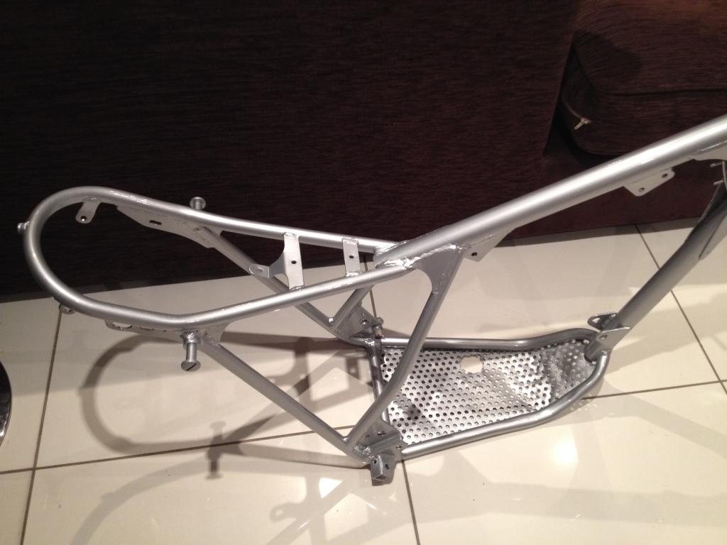

steviebulto67 Posted August 16, 2014 Author Report Share Posted August 16, 2014 Quote Link to comment Share on other sites More sharing options...
bondy Posted August 16, 2014 Report Share Posted August 16, 2014 hello no all my bikes are the later modals. but i have a 198A frame that am going to restore and have it the same colour has the 159 i had to chop the side panel lugs off to get the 159 box to fit. i myself need to alloy spacers making for mine. the 2 small bars with the hole in the center is your fixing point. when you get your Air box back offer it up you will need to get the size from Air box to the bar on the frame the rear 1 will be longer than the front. you should be able to make them your self just buy some alloy bar off ebay. once you have the correct size drill a M6 hole throw the center mine has no holes in the top off the box so i will have to drill 2 holes. you may already have them? i would wait until you have put the engine in with the exhaust on before mounting the Air box. just to make sure it dose not touch the exhaust. i just bought some nylon bar and made some steerin stops i needed them a few mm longer for the new alloy tank i got from inmotion just cut to size drilled a hole in the center rounded them off on 1 side sorted workes a treat. Quote Link to comment Share on other sites More sharing options...
