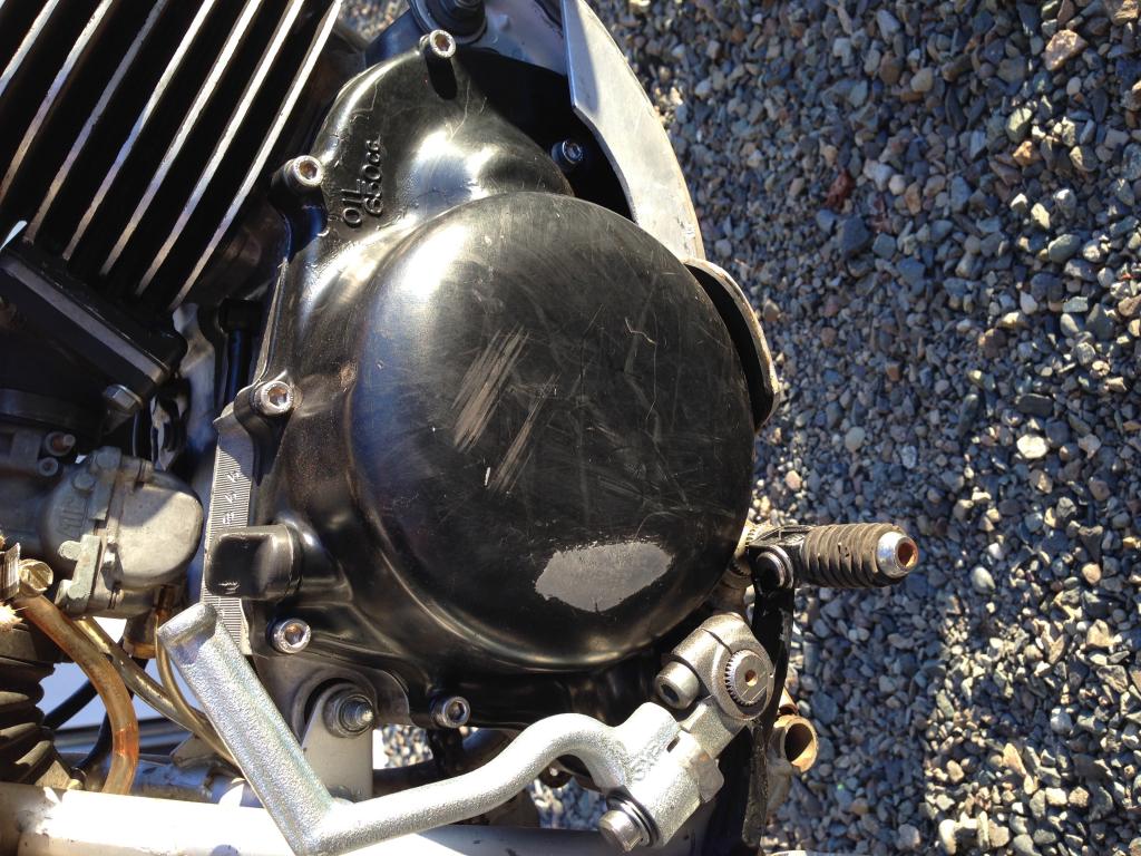

power175 Posted September 4, 2014 Author Report Share Posted September 4, 2014 i tried a dt175e 1976 clutch cover on but didnt fit, i have a friend near me that is going to keep an eye open for any that come around. a dt125/175mx should also fit i think. Quote Link to comment Share on other sites More sharing options...

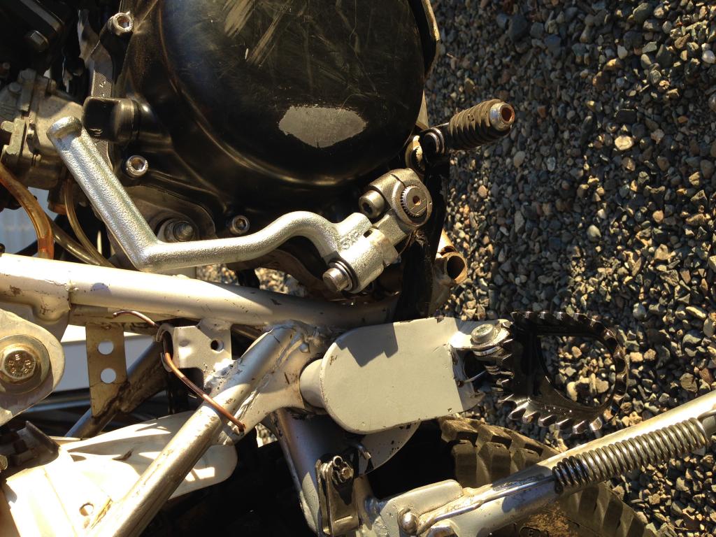

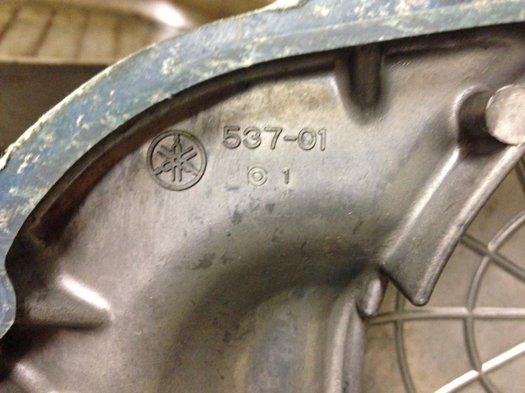

btc273 Posted September 11, 2014 Report Share Posted September 11, 2014 this cover is from a 1976 yz 100 125 or 175 you need to remove your autolube kicker is from a 1992 wr 200 top part bottom is stock 1 Quote Link to comment Share on other sites More sharing options...
