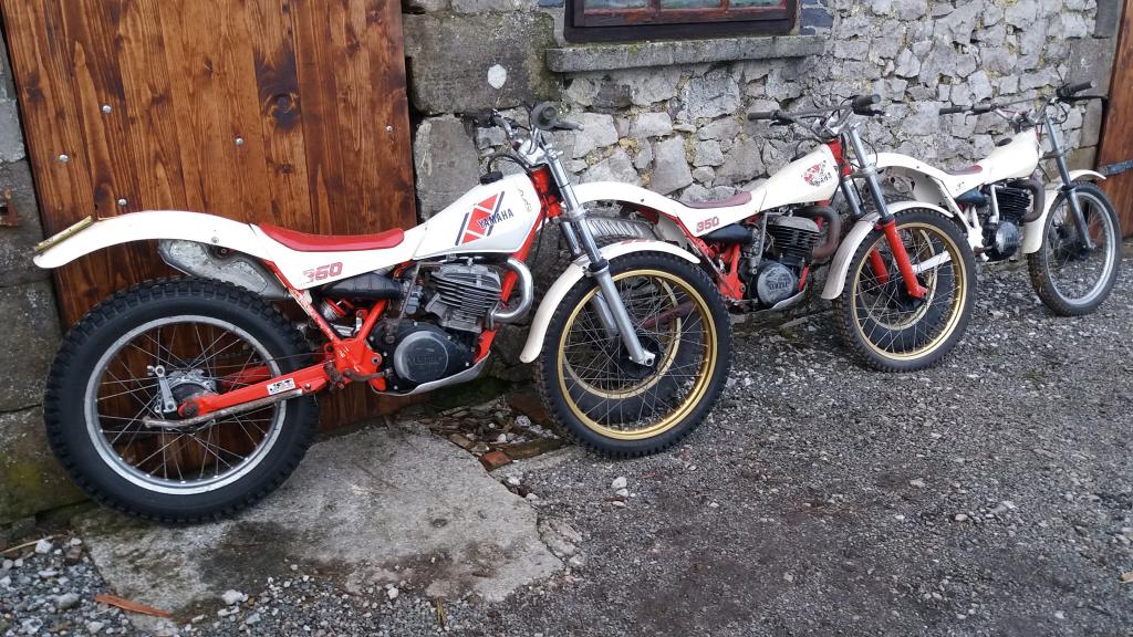

ducman Posted September 24, 2015 Report Share Posted September 24, 2015 Thanks, OK... So not having been around many more of these TY's than the two you see here..... How can you tell the year of the early one? 84. Well they looked all like this one back in the day,85 they changed to S(steel Tank) and R model.The first 2 years the looked all liken yours.It was the bike to have back in the day.We here in europe had only 250's what a lot of people say where the better one's.I know that when Johnny Anderson(Sweden)had to ride for Yamaha in America,after a few rounds they shipped his 250 over.The best engine was a 270 coversion from John Shirt. Quote Link to comment Share on other sites More sharing options...

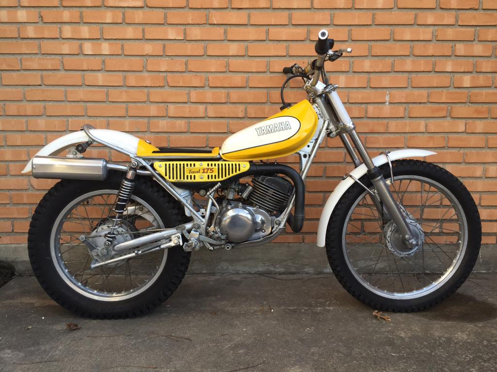

robbiesty175 Posted January 7, 2016 Report Share Posted January 7, 2016 I must have been a good boy this year, as Santa brought me a new, shiny muffler! Now we are nice and quiet... 3 Quote Link to comment Share on other sites More sharing options...
lineaway Posted January 7, 2016 Report Share Posted January 7, 2016 I really like your clutch cover. Better save that stock exhaust as that was a USFS approved spark arrester. You never know what you might need in the future. 1 Quote Link to comment Share on other sites More sharing options...
robbiesty175 Posted January 7, 2016 Report Share Posted January 7, 2016 @lineaway - It's tucked away with all the other original parts. Can't let things go. I love the look of this cover and thanks for admiring my little scooter! Quote Link to comment Share on other sites More sharing options...

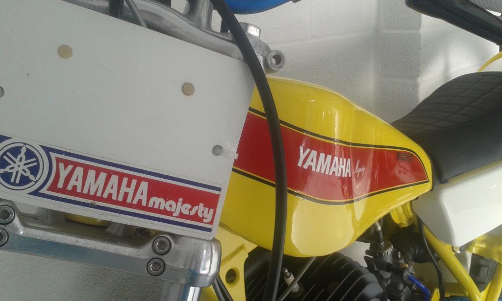

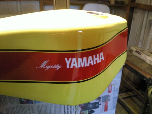

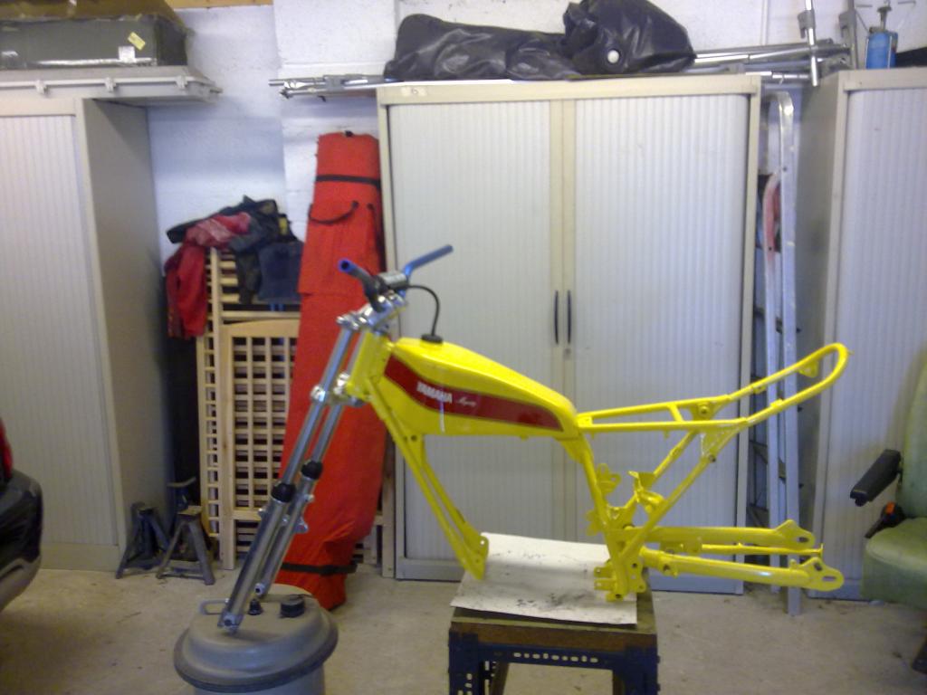

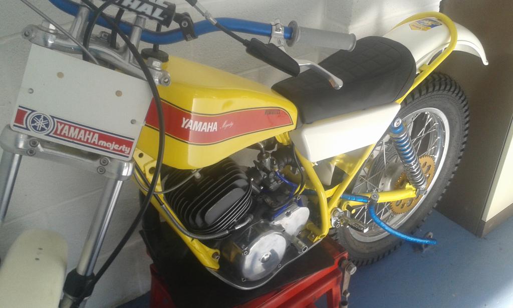

paulparkin Posted January 9, 2016 Report Share Posted January 9, 2016 Just wanted to show some photos of the TY 175 I got in 1979 which was one of the originally converted to Majesty 200 by John Shirt in Derbyshire, as part of the conversion the frames were nylon/plastic coated, the bottom of the frame was chopped and replaced with an aluminium bash plate, rear shockers were laid forward and the original shock absorber was replaced by gas girlings and engine bored out to 200cc I believe they used a TY 250 piston and base plate. Last year I decided to give it a spruce up, I am hoping to show the bike however not sure where to do this, has anyone got any suggestions? 3 Quote Link to comment Share on other sites More sharing options...
bashplate Posted January 9, 2016 Report Share Posted January 9, 2016 lovely resto there...but think you need to ride it, not show it. :-) 3 Quote Link to comment Share on other sites More sharing options...

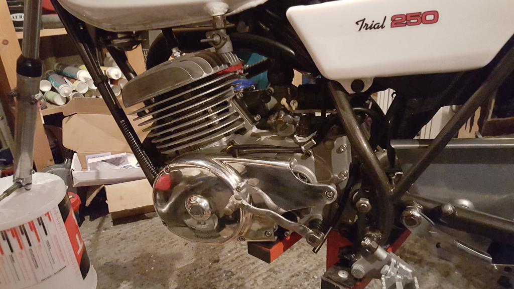

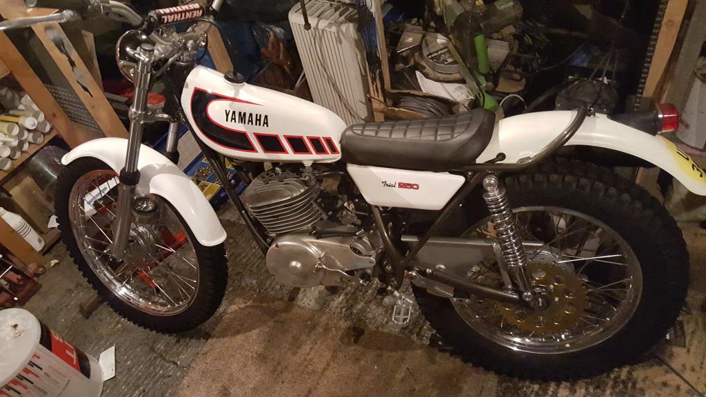

tybonkers Posted January 28, 2016 Report Share Posted January 28, 2016 Hi. My ty250 d in the final stages of restoration. Engine vapour blasted full engine rebuild. Job lot. Starting to come togeather now. Just put wheels on loosely. Not far off its first start. Quote Link to comment Share on other sites More sharing options...
tybonkers Posted January 28, 2016 Report Share Posted January 28, 2016 Piccy 2 Quote Link to comment Share on other sites More sharing options...
jon v8 Posted January 28, 2016 Report Share Posted January 28, 2016 Will it ever be that clean again ? Quote Link to comment Share on other sites More sharing options...
guy53 Posted January 29, 2016 Report Share Posted January 29, 2016 Not if I was the owner, but I hope he get it out of the showroom. Guy 1 Quote Link to comment Share on other sites More sharing options...
metisse Posted January 29, 2016 Report Share Posted January 29, 2016 Nice restoration, just looking over the picture and I see you have added lights. I have an early 434 that is currently being fettled and wish to fit lights to it. Am I correct in thinking your lighting kit is one of those currently being advertised on the well known selling site, and if so are you happy with it as it seems a logical way to go, considering what the kit includes. Thanks for any input Quote Link to comment Share on other sites More sharing options...
tybonkers Posted January 29, 2016 Report Share Posted January 29, 2016 Yes i did buy that lighting kit for a replacement headlight as the old one was really tatty and beyond restoration. i used all the original wiring loom and switches as the one that came with the kit was a bit advanced for me ! and the switches were different to that of stock. The only mod made is the foot rests but i have big feet ! as soon as shes ready im taking her out for a blast shes gonna be a well used machine. The lighting kit comes complete with everything you need, but the ty wiring loom is soooo simple. Just got to rebuild the carb tonight as petrol is weeeeeing out of the overflow at the minute ! Quote Link to comment Share on other sites More sharing options...

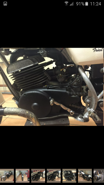

tybonkers Posted January 29, 2016 Report Share Posted January 29, 2016 Engine shot before aqua blast. Bike when i bought it. Quote Link to comment Share on other sites More sharing options...
