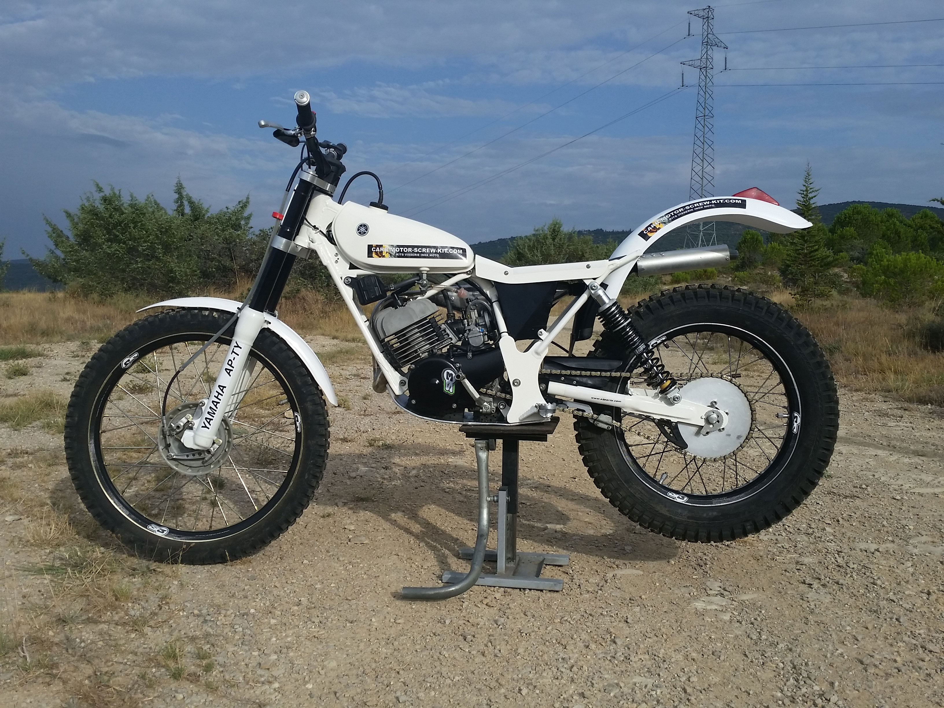

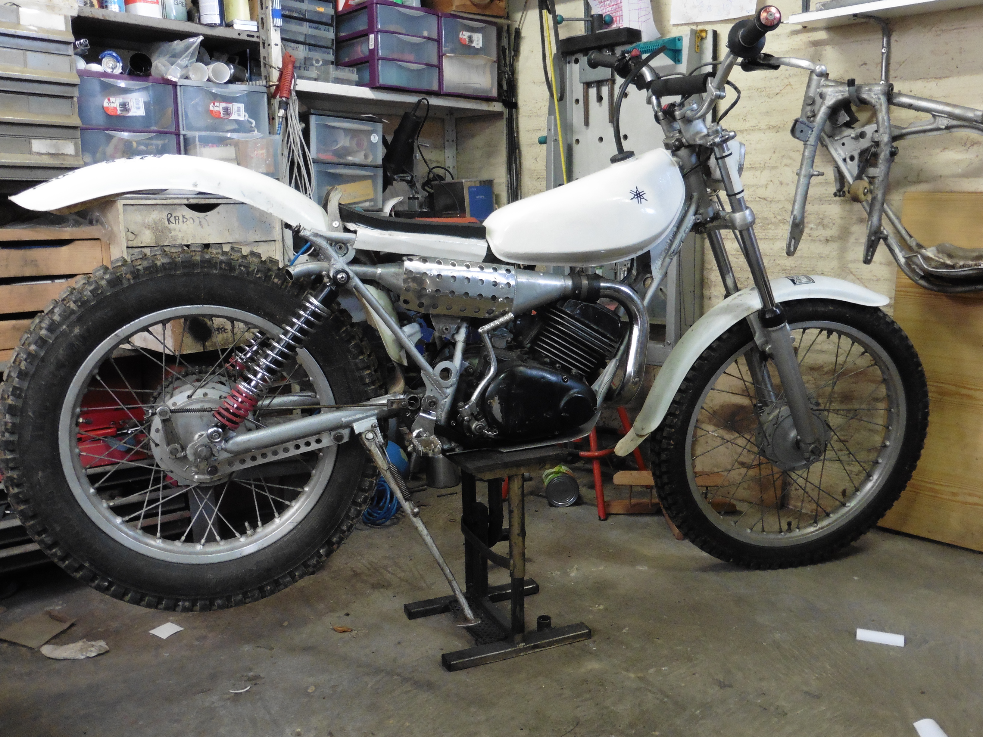

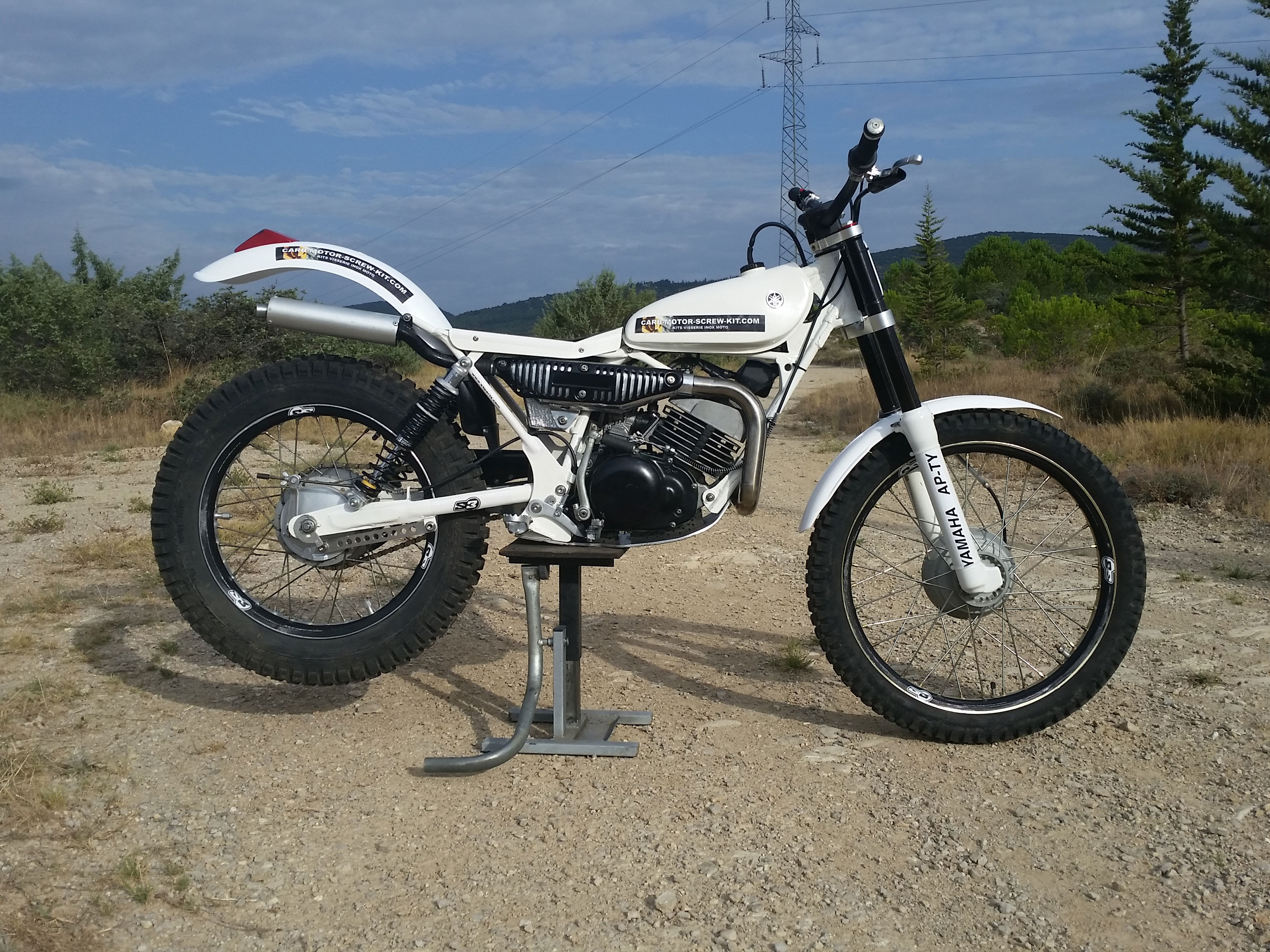

patauf Posted April 23, 2018 Report Share Posted April 23, 2018 5 1 Quote Link to comment Share on other sites More sharing options...
tyguy Posted April 25, 2018 Report Share Posted April 25, 2018 Hey patauf , Can you tell me about your boost bottle? Are you using the RD 350 intake rubber? Whats the bottle? Also, what did you use to bolt the exhaust cover on? The Wes has now screws? Quote Link to comment Share on other sites More sharing options...
patauf Posted April 25, 2018 Report Share Posted April 25, 2018 11 minutes ago, tyguy said: Hey patauf , Can you tell me about your boost bottle? Are you using the RD 350 intake rubber? Whats the bottle? Also, what did you use to bolt the exhaust cover on? The Wes has now screws? Hi, Yes we used the RD 350 intake rubber. The "boost bottle" is known as YEIS, it gives a light improvement in the low range of the engine. The "bottle" comes from a DT125LC. To bolt the exhaust cover we used threaded inserts . The TY cover got to be bent both sides to fit the WES exhaust. Quote Link to comment Share on other sites More sharing options...
tyguy Posted April 27, 2018 Report Share Posted April 27, 2018 @patauf Nice, I have the RD350 rubber on its way, I was going to play with boost bottles to see if I can actually feel a difference, so might try and get a DT125LC one from ebay to try! What else have you done? Mono Forks? Something crazy on the front brake? Airbox? Which carb is it? Clutch cable? Quote Link to comment Share on other sites More sharing options...
tony27 Posted April 27, 2018 Report Share Posted April 27, 2018 Looking at the front brake I'd say a 82 on YZ brake was used when 80/81 is what is really needed. The tab for holding the brake was moved 45deg which gives this problem Quote Link to comment Share on other sites More sharing options...
2stroke4stroke Posted April 27, 2018 Report Share Posted April 27, 2018 TLS I see. I take it you like going backwards down hills☺ Quote Link to comment Share on other sites More sharing options...
patauf Posted April 28, 2018 Report Share Posted April 28, 2018 (edited) Front brake is coming from a 1982 CR480. The carb is a Keihin PWK28. Air box home made. Longer clutch lever, clutch cable on the right hand side of the cylinder. Fork Marzocchi aluminium, we wanted to install a TY 59N fork, we did not find one. Edited April 28, 2018 by patauf 1 Quote Link to comment Share on other sites More sharing options...

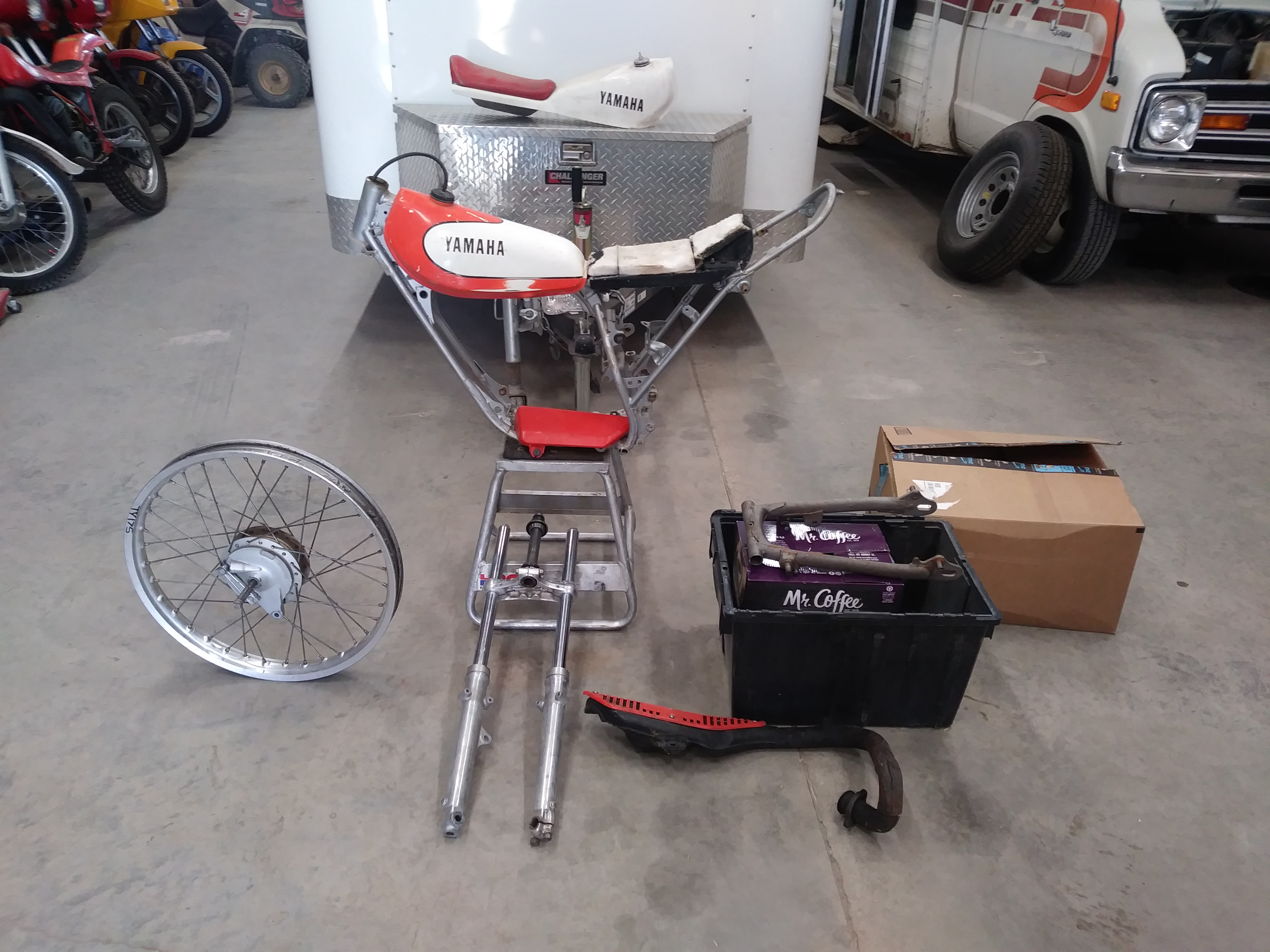

brewtus Posted May 19, 2018 Report Share Posted May 19, 2018 A project 175 showed up yesterday to keep the 80s company - 2 Quote Link to comment Share on other sites More sharing options...
turbofurball Posted May 21, 2018 Report Share Posted May 21, 2018 That seat / tank unit looks nice, any idea where it's from? Quote Link to comment Share on other sites More sharing options...
brewtus Posted May 21, 2018 Report Share Posted May 21, 2018 4 hours ago, turbofurball said: That seat / tank unit looks nice, any idea where it's from? It's an old fiberglass 1-piece unit (that leaks, naturally). No idea who made it. Working a deal on a 348 Montesa, the 175 may wait a bit... Quote Link to comment Share on other sites More sharing options...
turbofurball Posted May 21, 2018 Report Share Posted May 21, 2018 Ah ok, never mind! (the Majesty style tanks are not to my taste ) Quote Link to comment Share on other sites More sharing options...
jon v8 Posted May 21, 2018 Report Share Posted May 21, 2018 Those tank seat units were sold by Sammy Miller products. They were very good until Ethanol was added to petrol,completely wrecked mine. a shame because it was signed by Mick Andrews. Quote Link to comment Share on other sites More sharing options...
turbofurball Posted May 22, 2018 Report Share Posted May 22, 2018 Mmm, I went and did a little reading ... an ally tank is in my future! Quote Link to comment Share on other sites More sharing options...
