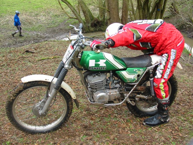

marky g Posted February 24, 2004 Report Share Posted February 24, 2004 Here's my old sparring partner on his rare beast (took at DK Mansell) Quote Link to comment Share on other sites More sharing options...
