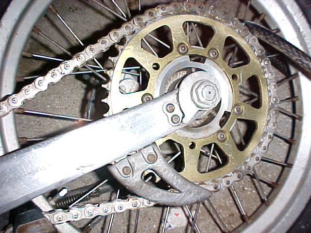

the artist formerly known as ish Posted January 12, 2004 Report Share Posted January 12, 2004 Take a close-up picture of your chain and sprocket make sure you get it all including the tensioner, and post it to this topic. Quote Link to comment Share on other sites More sharing options...

charliechitlins Posted January 19, 2004 Report Share Posted January 19, 2004 SD!!! If you can expose a whole tooth, your chain is beyond whipped. Chances are pretty good that your worn chain has worn your sprockets in such a way that they will ruin a new chain in no time. If you want low maintenance, get some new sprockets and an o-ring chain. As for the half-link...I did without it on my '01. The chain fit with the axle forward. I'm sure I'd never notice the difference in steering geometry. Quote Link to comment Share on other sites More sharing options...
Guest sherco dude Posted January 19, 2004 Report Share Posted January 19, 2004 hi its not a full tooth its like half heres a pic:: Quote Link to comment Share on other sites More sharing options...
