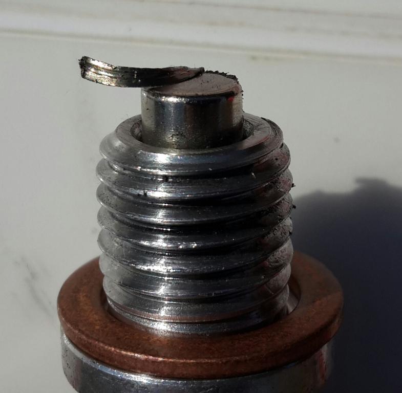

Hi chaps, I bought a 2011 TXT Pro 300 recently with extremely low hours on it. Including the riding I have done it amounts to about 20 hrs. You can still see the square shaped grooves on the tread blocks on the original back tyre.
As part of maintenance I drained the gearbox oil to find the usual small bits of metal on the magnetic drain plug, but also this piece as well. I cleaned the drain plug and stuck the shaving back to give a reference for size.

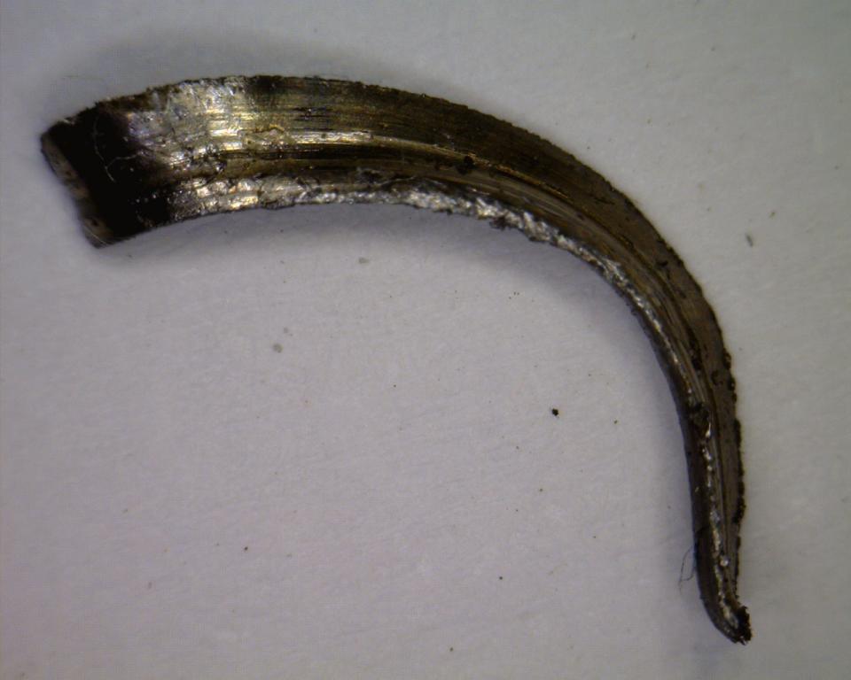

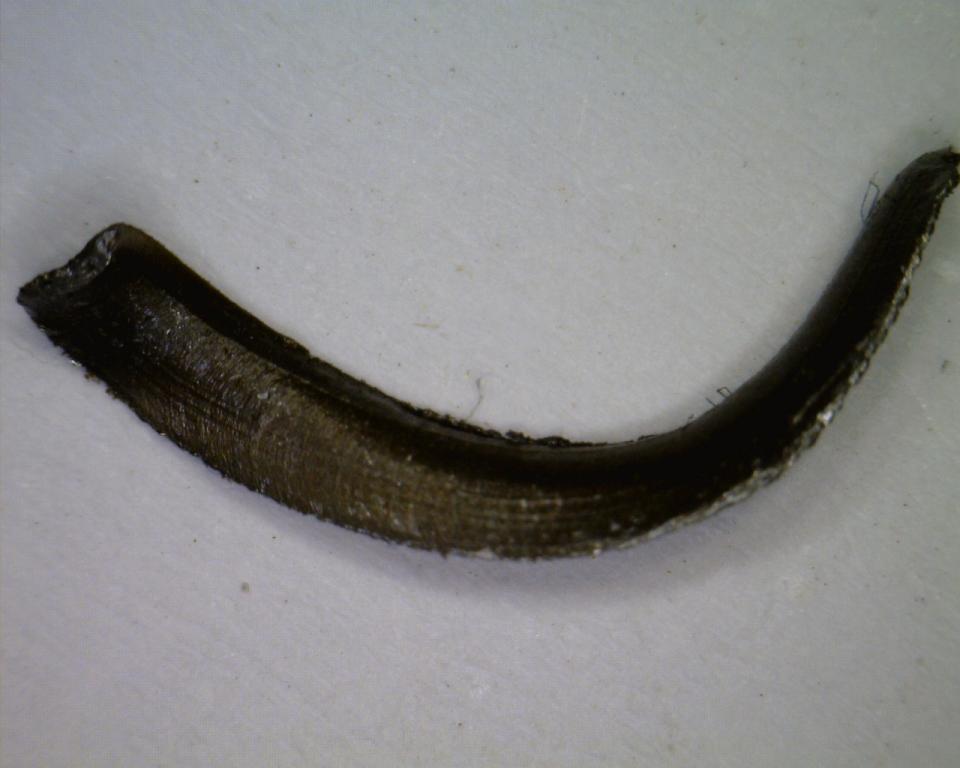

These are pics under a low power microscope-
Now that I think back I did battle once on Saturday to get the bike into second gear from first. This was with a light lift of the foot, with a hard pull it went in. Then on Sunday I remember thinking to myself that the box felt a bit more notchy than usual. It was not bad but it did catch my attention.
The steel is hard and when I tried to flex it between two pliers it broke instead of flexing. My first guess would have been a needle roller cage but then I thought that the cage would be out of a softer metal....
So do you guys have any idea where this piece may have come from? Do you think I should split the engine?

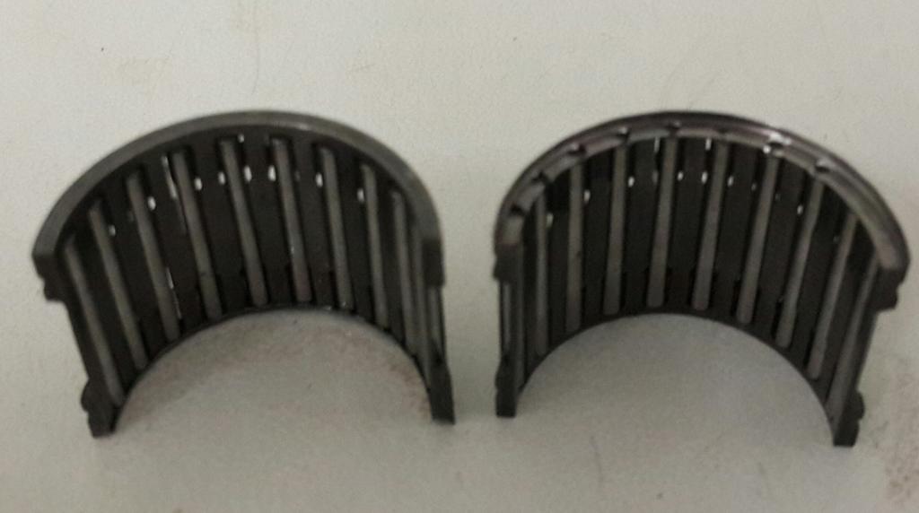

Hi Chaps, just an update on what I found. The culprit was split needle roller bearing MT280236161 on the secondary shaft.
I flipped the one half over so you can compare the good cage side to the bad side.
There is no real reason this should have happened that I could find. I micrometered the shaft and bore and both are spot on. It was the ends of the splines that ate the side of the cage away. All I could really do to help prevent this in future is chamfer the ends of the splines and give the ends a polish with 1000 grit water paper.
I also found that the primary shaft was tight. I could turn it by hand if I grabbed really tight. With the paper center case gasket squishing when bolts are tightened it made the cases too close together, or perhaps the distance from the circlip groove to the shoulder on the shaft was a bit over spec. I ended up grinding 0.05mm off the circlip on the surface grinder and that gave it 0.02 clearance.
Also gear 5 that ran on the damaged needle roller was really tight with it's circlip on and you could see how it had worn the washer. I used an oil stone to take off 0.04mm from the circlip and it runs sweet now. I do not know how they even assembled it like that, the circlip should not have even gone on without some serious force.
