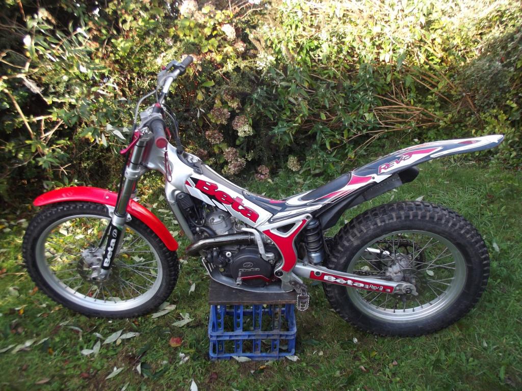

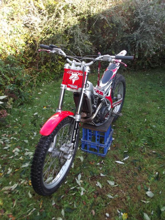

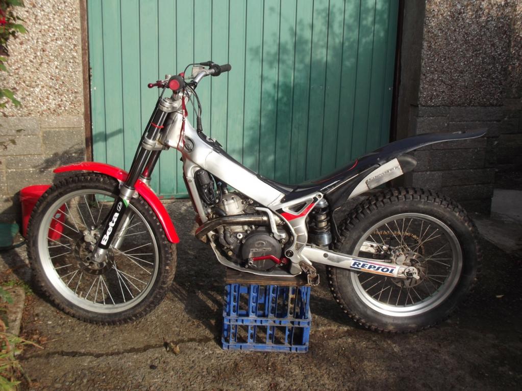

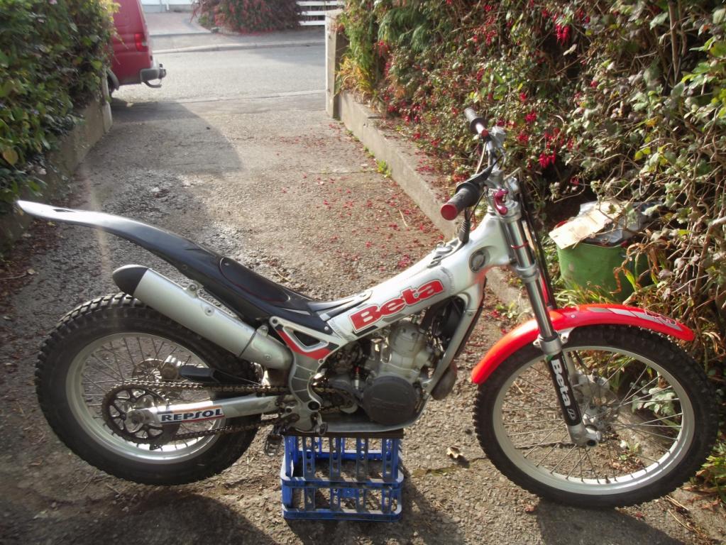

hrmad Posted October 7, 2014 Author Report Share Posted October 7, 2014 some before and after pics for ya, new stickers and board, hehe Fouled a new plug within an hour this morning, An NGKBP7ES, I'm going to try a 6 in it next time, gapped to 0.6mm. Also, is it worth trying out an air filter without filter oil on it? Will have an attempt at adjusting the mixture on the carb when the engine is hot to see if it makes a difference. This was with the fuel at 60:1. On the bright side the oil is still as it should be, and holding the clutch in with a elastic band whilst she is warming up has helped the clutch sticking issue a lot. The clutch has improved. Just gotta solve these fouled plugs. Quote Link to comment Share on other sites More sharing options...
jfc Posted October 7, 2014 Report Share Posted October 7, 2014 (edited) The BP6ES will help but you really need to mix your fuel at 70 :1 but better at 80:1 so long as you are using a good brand of oil semi or full synthetic the bike will be more than happy at the higher ratios. Edited October 7, 2014 by jfc Quote Link to comment Share on other sites More sharing options...
thats_a_five Posted October 7, 2014 Report Share Posted October 7, 2014 The bike is looking good. I wonder if the front fender is on correctly. I know some people who ride mud sometimes mount them with the back end of the fender close to the tire, like yours, to act as a scraper. That may explain the mounting. You may find better clutch control if you rotate the perch and lever up higher. This move the clutch from your fingertip to the first joint in your finger. I would suggest adding more oil so you can see it part way up the sight glass. Just draining the oil through the drain bolt does leave some of the old oil inside the engine and clutch housing. When you removed the clutch housing, more of that oil was able to drain out. As a result, it will take a little more to bring up to the proper level. The fouled plug does indicate an over-rich condition. Sometimes, with prolonged slow running, a plug can foul in even a perfectly adjusted bike. It is a good idea to rev it up from time to time to burn off some of the carbon. Wait until the engine is warmed up before doing this. I seem to recall you saying the previous owner had put in a wrong plug. That was probably an attempt to solve the fouling problem. Other possible causes are plugged air filter, incorrect jetting, improperly adjusted carb float, and improper fuel / oil mix. You can test for a plugged or over-oiled, air filter by running it dry or even without the filter for a short time. Get that mixture corrected to the 80:1 range. You mentioned replacing some fiddly parts near the rear shock. I think you are talking about the “dogbones.” They have bearings that can be replaced. These bearings have a tough life. They are down in the water, dirt, and mud a lot. I recommend at least cleaning and repacking with grease every 6 months. The bearings can also be pressed out of the castings for replacement. Bill Quote Link to comment Share on other sites More sharing options...
jfc Posted October 7, 2014 Report Share Posted October 7, 2014 (edited) Just checked my boys bikes as the plug you mention and also the one I said would help did not ring true, we are using BP5ES as recommended by The UK importer for the UK climate. Edited October 7, 2014 by jfc Quote Link to comment Share on other sites More sharing options...
hrmad Posted October 7, 2014 Author Report Share Posted October 7, 2014 Just checked my boys bikes as the plug you mention and also the one I said would help did not ring true, we are using BP5ES as recommended by The UK importer for the UK climate. I was running a 7 in there, if a BP6ES doesn't help I'll try the 5, thanks. The bike is looking good. I wonder if the front fender is on correctly. I know some people who ride mud sometimes mount them with the back end of the fender close to the tire, like yours, to act as a scraper. That may explain the mounting. You may find better clutch control if you rotate the perch and lever up higher. This move the clutch from your fingertip to the first joint in your finger. I would suggest adding more oil so you can see it part way up the sight glass. Just draining the oil through the drain bolt does leave some of the old oil inside the engine and clutch housing. When you removed the clutch housing, more of that oil was able to drain out. As a result, it will take a little more to bring up to the proper level. The fouled plug does indicate an over-rich condition. Sometimes, with prolonged slow running, a plug can foul in even a perfectly adjusted bike. It is a good idea to rev it up from time to time to burn off some of the carbon. Wait until the engine is warmed up before doing this. I seem to recall you saying the previous owner had put in a wrong plug. That was probably an attempt to solve the fouling problem. Other possible causes are plugged air filter, incorrect jetting, improperly adjusted carb float, and improper fuel / oil mix. You can test for a plugged or over-oiled, air filter by running it dry or even without the filter for a short time. Get that mixture corrected to the 80:1 range. You mentioned replacing some fiddly parts near the rear shock. I think you are talking about the “dogbones.” They have bearings that can be replaced. These bearings have a tough life. They are down in the water, dirt, and mud a lot. I recommend at least cleaning and repacking with grease every 6 months. The bearings can also be pressed out of the castings for replacement. Bill Thanks Bill. The front fender may well be the wrong way round, or just plain bent courtesy of the previous owner. At the moment it doesn't seem to be affecting the front wheels rotation though. Mud scrapping may come in handy over the winter... I'll move the clutch lever and housing up to try it out, thanks. The oil has leveled out to half way up the sight glass after running her today, maybe it just needed to circulate. It's looking like oil should look too, so the fix has worked for now. I'll try an 80:1 mix then, simplest possible solution first. I have just cleaned and oiled the air filter, maybe too much oil added. I'll run her tomorrow without the filter for a short time to see if it makes a difference. After that I'm working the rest of the week, so it would be a good time to clean the filter again and let it dry. I have another on order so whilst one is getting cleaned the other is ready to use. I hope it's not a carb issue, I haven't had any problems with fuel leaking or starting, just the matter of the plug. I'll leave alone for now. Dogbones sounds about right! We replaced some missing screws where the pieces were attached to the air box and greased the rest. Hopefully shouldn't have any problems for a while, will check in six months. And thanks for your advice in the other thread, I will try to implement it and do another video after some more practice. Ta, Heather Quote Link to comment Share on other sites More sharing options...
