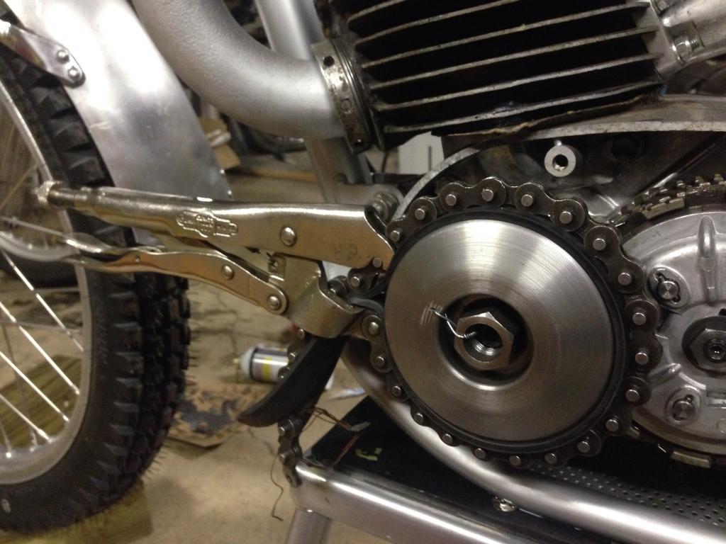

So I figured out a fairly good way to torque the flywheel but, so I thought I would share. This is how I did it and it worked well but I will also let you know what others suggested.
First I tried making a tool to hold the countershaft sprocket still while the engine was in gear, this didn't work because the clutch slipped before I made it to the required 72ftlbs.
What I tried next, which worked, is this...
I borrowed a chain wrench from a coworker, my idea was to use it to hold the counterweight on the clutch side of the crankshaft while I torqued the flywheel nut. I wrapped a rubber strap around the counterweight to protect it clamped on the chain wrench held it still with one hand and torqued the flywheel nut with my other hand. Worked great, I will provide a picture below.
Jared at Southwest Montesa also suggested a blocking tool he sells, which I believe blocks the piston from moving, and runs $85. He also said I could use an impact gun and hope for the best, which would have been my last resort.post-20130-0-07379200-1412354052_thumb.jpg
