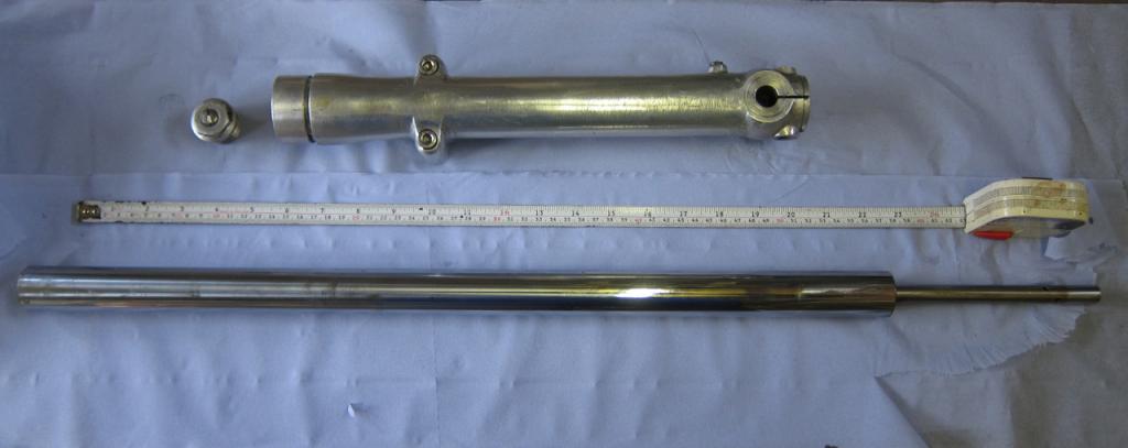

vlad the inhaler Posted October 6, 2014 Report Share Posted October 6, 2014 Can anyone help me to identify these forks which are from a B40 trials bike I got earlier in the year (Surrey area). I've stripped them to replace the seals which were shot but cannot find anything to suggest a manufacturer. Stanchions are 32mm diam and 597mm long (parallel along entire length) There were two 42mm x 32mm x 7mm seals in each fork (is it normal to have 2 seals?) I'd like to get info on what volume and sort of oil to use in them Thanks in advance for any replies. Quote Link to comment Share on other sites More sharing options...
villiersprodigy Posted October 6, 2014 Report Share Posted October 6, 2014 Hi Vlad those forks look like ceriani`s ,they do have two seals per leg. I would put in about 200cc of 10wt oil as a starting point. All the best Alan Quote Link to comment Share on other sites More sharing options...
vlad the inhaler Posted October 7, 2014 Author Report Share Posted October 7, 2014 That's great. Thanks Alan. Any recommendations for where to get good quality seals and which makes to go for - I don't want to get shoddy budget ones and have to change them again soon! Cheers! Quote Link to comment Share on other sites More sharing options...
