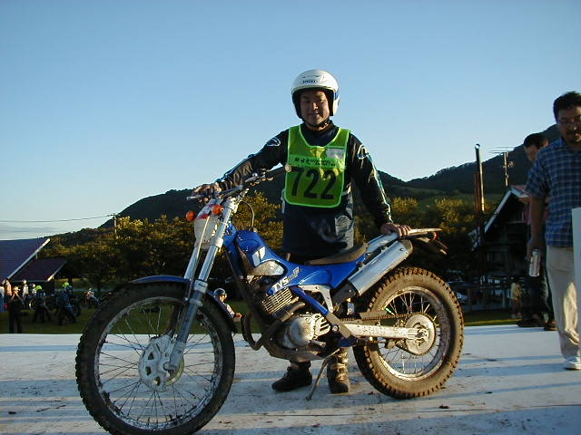

marky g Posted March 14, 2004 Author Report Share Posted March 14, 2004 The ultimate big tank conversion !! Quote Link to comment Share on other sites More sharing options...

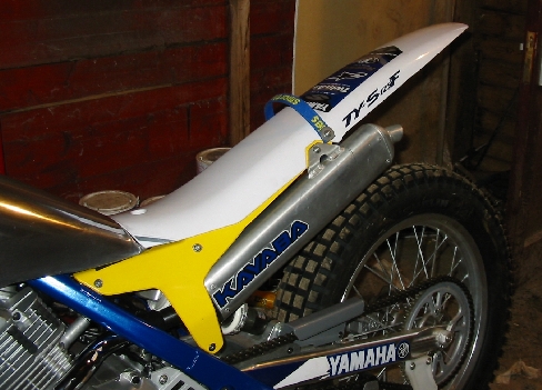

marky g Posted March 14, 2004 Author Report Share Posted March 14, 2004 And before the bike got dirty (SY250 longride kit maybe???) Quote Link to comment Share on other sites More sharing options...
john b Posted March 15, 2004 Report Share Posted March 15, 2004 Thanks for the reply on the exhaust mod Mike, I'll try it this week. Latest hints and tips for everyone from yesterday's trial. 1 - The Sumpguard extensions I fitted worked excellent - Gives much more confidence riding up rocky streams (between rocks) - a few scuff marks on them, so they obviously work ! - Interesting to note that the 'Long Ride' version in the photo has extensions fitted. 2 - Keep an eye on the Plug Cap. I had to retire after a lap and a half yesterday, the bike just wouldn't run. On tickover it would stop, then take a while to start, then run for a while, then stop. This went on for a long time. It was pi**ing down, so decided to pack in, as the last thing I wanted to be doing was push the bike 2 miles through the mud back to the car ! - Anyway, traced the problem to the plug cap. The outer sheath had pulled back from the plug cap, and the HT lead was shorting onto the fins on the barrell - hence intermittant starting, and missing when running and revved. Solution is silicon and copious use on black insulating tape ! Jesus, I should be a Scorpa development rider - but I'm crap (but maybe thats what they need ! - Must go, just about to e-mail Scorpa France with my CV !) John. Quote Link to comment Share on other sites More sharing options...
don t. Posted March 16, 2004 Report Share Posted March 16, 2004 Marky G said: And before the bike got dirty (SY250 longride kit maybe???) I wouldn't know; I'm still waiting on my Long-Ride kit to arrive! You'd think it was on a slow boat from China instead of France; ordered it in late summer last year and got the bike in November. Still waiting for the seat/tank which was ordered the same time as the bike... I have heard it should be here soon; maybe this week I'll get lucky? Quote Link to comment Share on other sites More sharing options...

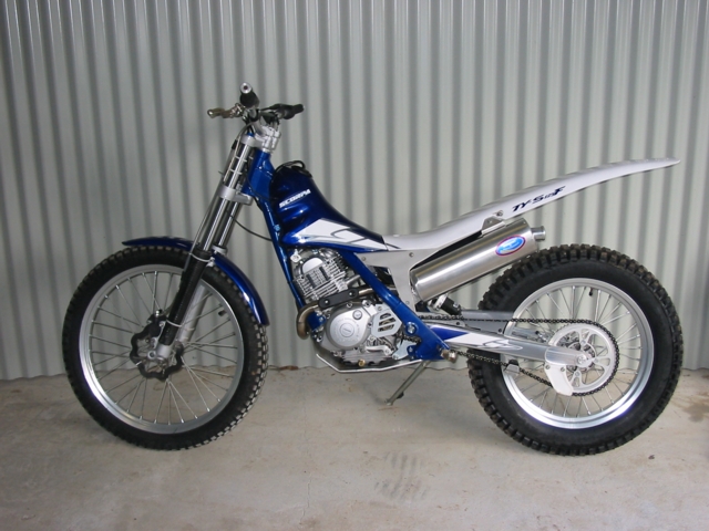

ben_r Posted April 21, 2004 Report Share Posted April 21, 2004 (edited) Hi all, Just a quick update on my beast - have installed a full stainless system on my 125 - custom made by the guy who did the first work on the Britten's (or so Im told). Top quality work (see attached pic). The muffler is a bit bigger (sits lower) but so far is no more vunerable than the standard one. Weight is roughly the same - so the maker says. Performance: First of all - it sounds unreal - better than the agricultural noise the standard one makes. Overall power maybe slightly higher but is now more responsive with much improved top end. Steep hillclimbs are now less daunting but still will not pull second on anything steeper than a disabled wheelchair ramp (also due to 110kg rider). Overall: Money well spent in my opinion - makes my one-off bike (for Australia) even more unique. Although, the muffler is quite dear so maybe a B&J baffle kit mated to this header would also be good. Unrelated (to exhausts) - has anyone got maore info about the scorpa tech release about the weak bashplate. How would I get a Narita or Crosswaite strength basher? Cheers, ben r PS easy pull lever mentioned in earlier post is a godsend - put the cable in the middle spot for easy pull and it still has good response. The easiest spot is light as a feather but clutch response is heavily affected IMO. Edited April 21, 2004 by Ben_r Quote Link to comment Share on other sites More sharing options...
marky g Posted April 21, 2004 Author Report Share Posted April 21, 2004 mine's ready too ;-) Just waiting for the some decals to arrive to finish it off. The tank holds a tad more than the std one, the front pipe proved too pricey to get in stainless so I had it chromed......and the I've had some 'proper' bash plate extentions added on I took MR's advice and cut out the 4 steel rods that were in the silencer and it sounds much better for it!, I also cut down the rear guard and trimmed the sides of it up a bit to try and make the rear end look a bit better. As soon as the comp guard is available I'll get one of those........running it in using Castrol GTX before going over to fully synth oil..I'll get some better pics when it stops p***ing down here in 'sunny' shropshire Quote Link to comment Share on other sites More sharing options...
