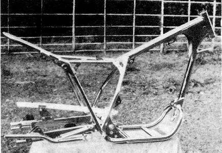

woody Posted October 14, 2014 Report Share Posted October 14, 2014 It does look like one of Steve Wilson's swingarms, it's the same appearance, but whether they were longer than the original I don't know. It may appear longer as the shock bottom mount could be located further forwards, which gives the impression that it is longer. Hard to know but obviously measuring will prove it. I don't know whether he did just a swingarm as a straight replacement or whether it came as part of a complete frame kit and one has just found its way onto your bike. If it was just a replacement swingarm I'd expect it to be the same length, can't see any point in it being longer, otherwise it makes a longish bike even longer. If it was part of a complete frame kit, it could be longer as he could have reduced the head angle on his own frame. Which fraternity does that put me in.... Quote Link to comment Share on other sites More sharing options...
mjc477 Posted October 14, 2014 Author Report Share Posted October 14, 2014 (edited) Cheers guys for all the replys I hope to get the bultaco on the ramp this weekend if I can finish the current project hogging it at the moment.. Then I will definately get some clear pictures of the swing arm etc up for all to see.... The picture below was posted on here some time back but it does clearly show a similar arm on it...I will have to compare.... I got the bultaco as I thought it would be a cheaper experience to the multi cylinder Hondas I am used too.....1 piston 2 rings etc compared to 4 of everything....you can only hope I suppose... Edited October 14, 2014 by mjc477 Quote Link to comment Share on other sites More sharing options...
