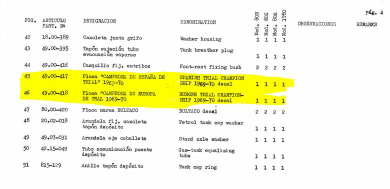

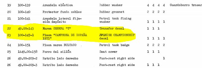

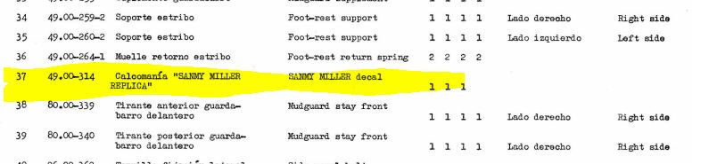

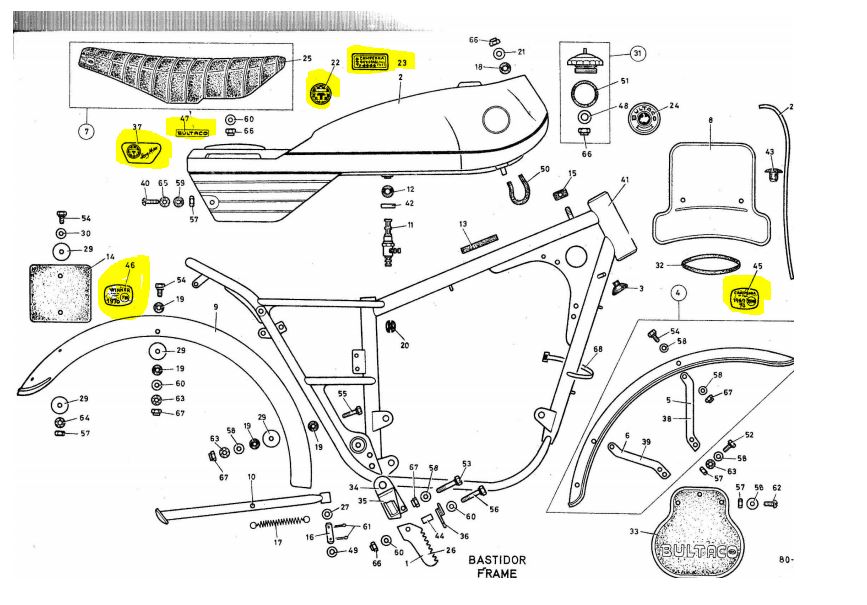

trailie Posted October 19, 2014 Report Share Posted October 19, 2014 (edited) I'm coming close to painting the bike and I wondered if anyone knew what stickers where on the bike from new. There weren't any on it that I can remember, but the book shows a various selection. Were these perhaps available to buy if you wanted to add them yourself ? I've hunted for old photos from back in the day but am not any the wiser. Does anyone remember. http://www.ralphsbultaco.blogspot.co.uk Edited October 19, 2014 by trailie Quote Link to comment Share on other sites More sharing options...
woody Posted October 19, 2014 Report Share Posted October 19, 2014 (edited) The decals you've highlighted were for the model 49, the model 80 had little in the way of decals, just a Bultaco decal underneath the seat each side - number 47 on your parts list. The first numbers in the part serial number are the actual model number This place does Bultaco decals http://www.classictransfers.co.uk/pages/transfer-images/european-transfers/spanish/bultaco.php Edited October 19, 2014 by woody Quote Link to comment Share on other sites More sharing options...

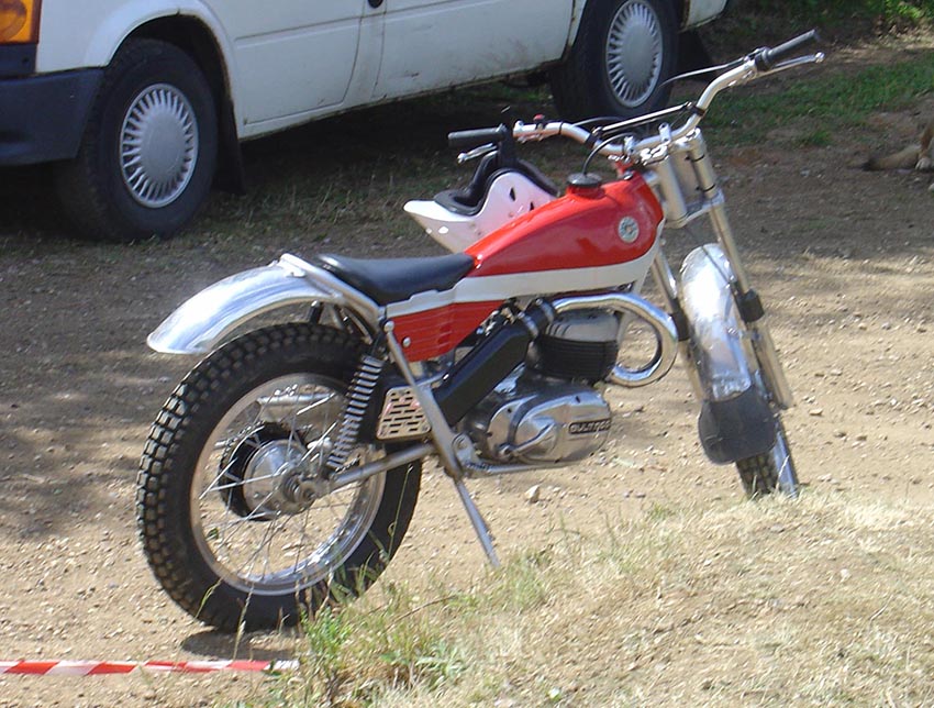

twinnshock Posted October 19, 2014 Report Share Posted October 19, 2014 (edited) I do not mean to upset anybody but how refreshing for a topic not about late 198/199 bikes. The bottom line it is your bike so put on what decals you like. I believe the model 80 did not have the big Bultaco name on the tank and the kit campeon sticker was only on the model 49. My own M80 I just have the round Bultaco stickers that fit into the recesses but no other decals or stickers. That's the way I like it. I have attached a picture of my bike so you can see what it looks like with minimal decals. I have since the photo was taken removed the triangular silencer as it just gets in the way. Any body got one of the small round after market replacement that Sammy Miller used to sell for sale and I would be interested Please when reading my opening comment be aware I own both a model 198A and 199A and just love all things Bultaco Stuart Edited October 19, 2014 by twinnshock 3 Quote Link to comment Share on other sites More sharing options...
trailie Posted October 19, 2014 Author Report Share Posted October 19, 2014 Thanks guys, that's interesting to know about the part numbers Woody. The photocopies are from a model 80 catalogue but I dare say there was a lot of common parts between these two models. I still don't really understand why it indicates quantity 1 in a model 80 book if it's only used on a 49, surely the quantity column should be blank, I dunno?. Anyway I don't remember there being any decals on it when we got it about 76-77. Looking at a handful of old black and white photos of me riding it I can't see anything, but it might well have been repainted. The tank had been split and repaired and a strip of electrical insulating tape was used for a pinstripe. Stuart your bike looks very tidy and your tank in real great shape. Where did you get the silencer boxes from - Spain? I have one of the aluminium boxes from the '70s on mine but it's fell apart inside. I'd like to put the proper one on it. http://www.ralphsbultaco.blogspot.co.uk Quote Link to comment Share on other sites More sharing options...
twinnshock Posted October 19, 2014 Report Share Posted October 19, 2014 (edited) Stuart your bike looks very tidy and your tank in real great shape. Where did you get the silencer boxes from - Spain? I have one of the aluminium boxes from the '70s on mine but it's fell apart inside. I'd like to put the proper one on it. Both silencers on my bike are original so I guess yes from Spain but supplied in 1971! The main silencer has been modified. The back has had a hole cut into it, a plate brazed across this hole to support the attachment bracket which is now screwed in place. A sheet metal plate secured with self tapping screws and the support bracket allows me to repack the silencer easily any time I require in the future. I am now only running with one silencer and so far not had any noise complaints. My guess is you have a Sammy Miller alumimium after market silencer. My original M80 I bought in 1977 had one and a small steel spark arrester/silencer attached with a sliding fit and spring about 1.1/2" dia and 3" long that I have been trying to track down another but so far without luck. Tank unit on my bike is original. Has been lined inside for bl***dy ethenol. It has had repairs underneith but nothing major and what you would expect after all these years. I have been following the blog of the model 80 restoration. My main concern is the welding shown in some of the photographs. Far to good to be original Bultaco. Stuart Edited October 19, 2014 by twinnshock Quote Link to comment Share on other sites More sharing options...

trailie Posted October 20, 2014 Author Report Share Posted October 20, 2014 So a nice range of answers there I think I'll put just the small Bultaco transfer on the side panels and the Spanish Championship '71 on top of the tank ahead of the seat, ( just because I like that wee badge !). I found that owners manual on ebay Woody - useful . Would I be right in thinking the kit campeon's were the ones fitted with lights? I vaguely remember the man we bought her off saying there was a tax book somewhere but he didn't know where it was or who had it, we never did need it anyway. It was a long time ago, I was only 10 at the time, I can't remember for sure, must ask my dad.. I took the head staggers earlier and bought a mid box from frankiemountain on ebay. Hopefully it'll fit. I'll let you know when I get it. I'm still holding off on a front pipe until I see what shape I can make of fixing the dents in the old one. Stuart and Sparks, if you would, sometime I'll get you to post me a couple of good photos of your chain guard and the front mudguard stays. I think I could make these easily enough if I had a decent picture to go by. Thanks Quote Link to comment Share on other sites More sharing options...

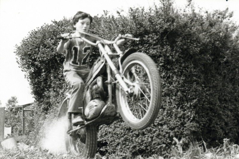

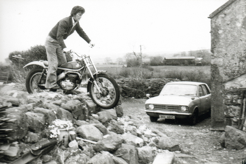

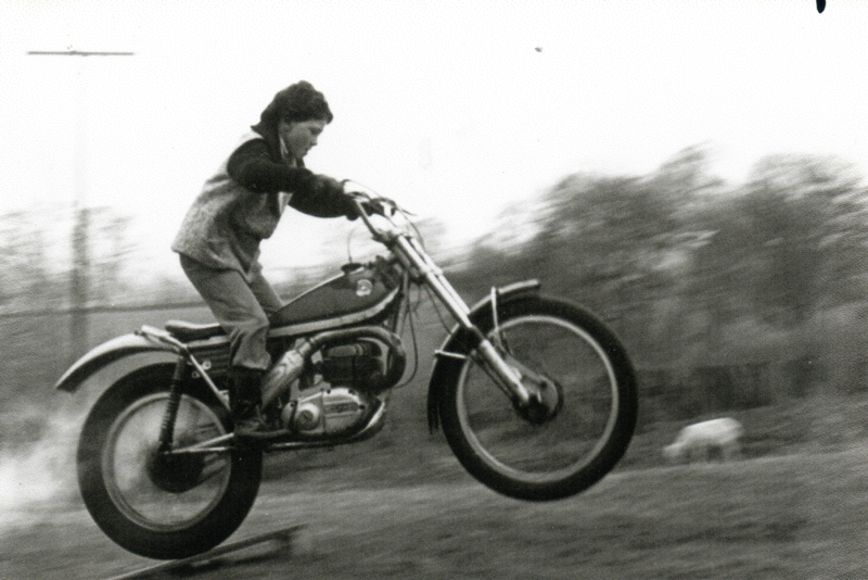

trailie Posted October 20, 2014 Author Report Share Posted October 20, 2014 This is a great history lesson Woody, you need to write a book sometime. I've got loads more to ask but it'll keep for another time. Thought I'd share a couple of the old photos I'd dug out. Me and my dad about 1977. Like most wee boys I'm more interested in building ramps and doing jumps. Notice nobody gave a toss about putting kids on motorbikes without a crash hat in those days, but back then we'd the sense not to hurt ourselves. 3 Quote Link to comment Share on other sites More sharing options...
woody Posted October 21, 2014 Report Share Posted October 21, 2014 (edited) I love pictures like that from back then, I was 15 when I had my model 80 (had a Greeves Challenger before that but it was a trials bike I wanted) We never once thought of the Bultaco, or Greeves come to that, as too heavy or tiring to ride or difficult to start, we just rode them for hours or until the petrol ran out. Imagine what people would say now if you suggested putting a kid on a bike like that. Too big, too heavy etc. I find it amusing these days to hear people describing some modern bikes as too heavy... You can also see from the period handlebars why the high footpeg position didn't matter back then. If they still sold bars like that we wouldn't have to take a hacksaw and welder to our bikes... Edited October 21, 2014 by woody Quote Link to comment Share on other sites More sharing options...
