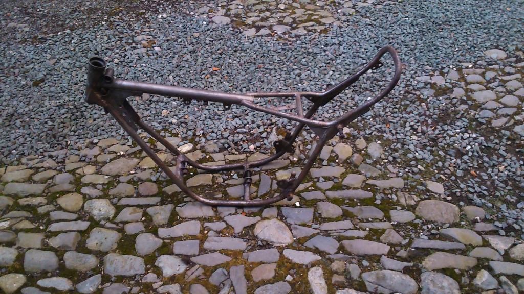

telboy1969 Posted October 26, 2014 Author Report Share Posted October 26, 2014 this is the frame stripped of paint ready for primer... Quote Link to comment Share on other sites More sharing options...

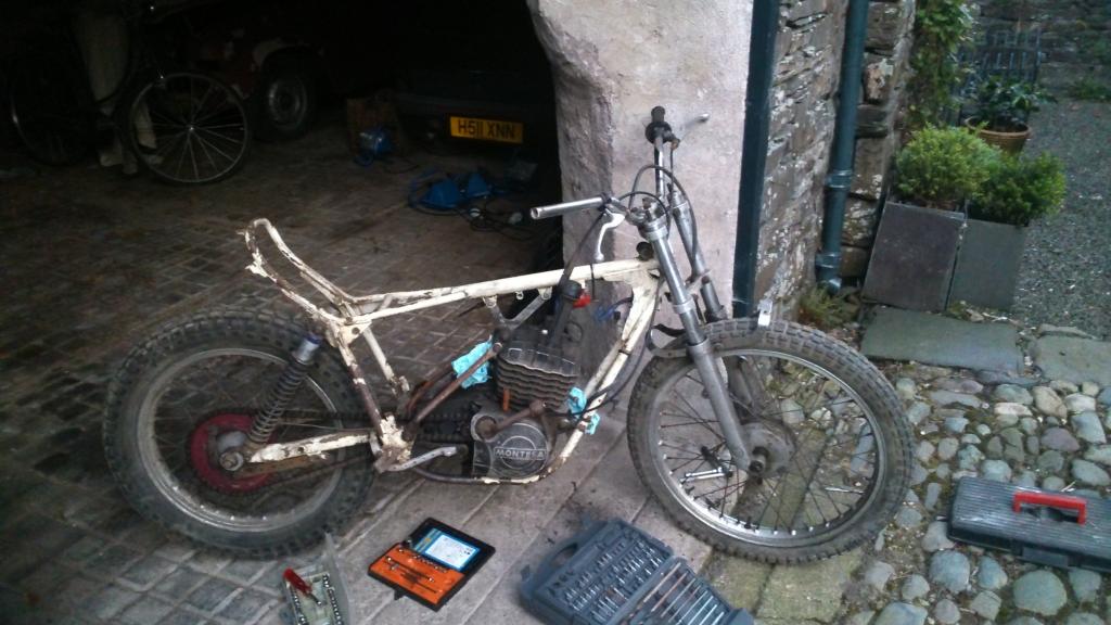

telboy1969 Posted October 26, 2014 Author Report Share Posted October 26, 2014 this was the bike halfway through stripping it.... Quote Link to comment Share on other sites More sharing options...
feetupfun Posted October 26, 2014 Report Share Posted October 26, 2014 Brake pedal looks like 1977 or 1978 348 Someone has removed the drilled steel bash plate that is normally welded between the frame tubes under the motor Looks like the ignition flywheel cover has been cut away, probably to allow easy cleaning around the sprocket Can't see much in the photos but from what can be seen, the rest looks like normal 348 to me Have a good look at the frame while the paint is off, looking for cracks and bends One of my 348 frames has tubular ears/loops welded to the frame tubes under the front of the engine as a protective measure, but I don't know which year it is. My other 348 frames don't have those ears Quote Link to comment Share on other sites More sharing options...
telboy1969 Posted October 26, 2014 Author Report Share Posted October 26, 2014 Thanks for that, guessed it was late 70's, got another complete flywheel cover to go on instead of the cut one, as for the bash plate, they've done a very good job of cutting it out and grinding back as there are no visible remains of welds or bobbles on the frame where it may have been so thats a mystery as to why someone would do that or did some just not have them? Frame is pretty solid, few little dings but no cracks or bends, actually in very good shape for something that old!! I don't know the complete history of the bike but will ask the previous owner (who I know wouldn't have the tools to do that ) and see if I can trace the background. Another query is the front wheel bearings got a new set and fitted them today but they are not tight as I expected, still quite a bit of play - could it be that the bearing housings has worn? On the main hub side it was tight to hammer in then once through the gap seemed jts to pop into place too easily, on the shoe side the bearing just pushes in and out using fingers? Definitely the right bearings as got them off inmotion with some other bits and pieces.... Quote Link to comment Share on other sites More sharing options...
