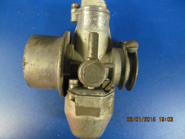

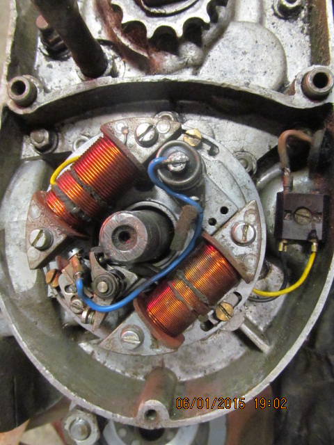

jlpar Posted January 6, 2015 Report Share Posted January 6, 2015 Guys, Just a couple of pics of the carb, which is an IRZ which, reading the posts here would be hard to get parts for, although there doesn't seem to be much wear in evidence. Also the magneto which I assume can be wired for lights although there were never lights on it as far as I know. Were lights fitted when new? Larry. Quote Link to comment Share on other sites More sharing options...
matador107 Posted January 8, 2015 Report Share Posted January 8, 2015 You'll be able to run lights off that set up, not too sure about that terminal block though, I've never seen that type before. Send me a PM and I'll flick you a simple wiring diagram if needed. Martin Quote Link to comment Share on other sites More sharing options...

twinnshock Posted January 9, 2015 Report Share Posted January 9, 2015 My M10 has a similar terminal block. Stuart Quote Link to comment Share on other sites More sharing options...
