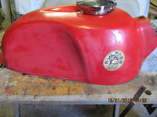

jlpar Posted January 18, 2016 Report Share Posted January 18, 2016 Sent off the fork tubes for hard chroming. They're due for collection this week, hope they work out. I'll post pics so you guys can tell me what you think. Another area I need some guidance on is the fibreglass tank. It has multiple star cracks which have to be dealt with. Any advice on the way to repair these would be welcome. Also, would you guys recommend replacing the fuel filler cap with an original type (if available) Ta, in advance. Larry 2. Quote Link to comment Share on other sites More sharing options...
1973tr6 Posted January 22, 2016 Report Share Posted January 22, 2016 Grind out the cracks with a dremel or similar, hollow out the crack area to make a slight concave using sanding discs, lay in suitable glass mat to cover the crack and thoroughly apply resin, making sure there are no air bubbles, repeat as needed. When you are hollowing out, make sure you go past the end of the crack otherwise it will start again. Fill with bondo and re profile.Plan B wold be to try using some low viscosity epoxy (check out the boat fibreglassing sites) https://www.youtube.com/watch?v=eggAzL9oQxg Quote Link to comment Share on other sites More sharing options...
feetupfun Posted January 22, 2016 Report Share Posted January 22, 2016 Those cracks in your photos are only in the gel coat (not structural) so you can either redo the gel coat (lots of work) or just fill the cracks and paint the tank. Painting is the most popular approach and if done properly can give a finish that looks very much like the original, if that is what you want. I would recommend coating the inside surfaces with low viscosity epoxy resin (available from boat shops) to reseal it. Fibreglass tanks that old are usually suffering from surface breakdown inside and outside, and modern fuels are not kind to polyester resin (which is what it is made from). If it looks a bit hairy inside that is from the glass fibres becoming exposed as the resin breaks down If you want the gel coat (the outside of the tank) repaired, a fibreglass boat builder or a surfboard builder would have the skills to do it. As for the fuel cap, that cap is a good talking point for people looking at the bike, but if you want it to look original, the fuel cap is a very important visual element. Original caps are available second hand but are quite expensive. The aluminium part that the cap screws into could be easily made on a lathe or donated from another old Bultaco tank. There may be a bit of intricate fibreglassing required to restore the tank where that flip-top cap has been fitted Quote Link to comment Share on other sites More sharing options...
big john Posted January 24, 2016 Report Share Posted January 24, 2016 Pity that someone has fitted an Imola style flip up cap. Big John Quote Link to comment Share on other sites More sharing options...
jlpar Posted January 28, 2016 Report Share Posted January 28, 2016 Thanks Guys, I'm going to start work on sealing the inside of the tank first. I may consider getting a professional to finish the outside. The bike came to me many years ago with the cap fitted, I'm not sure why. thanks again, Larry 2. 1 Quote Link to comment Share on other sites More sharing options...

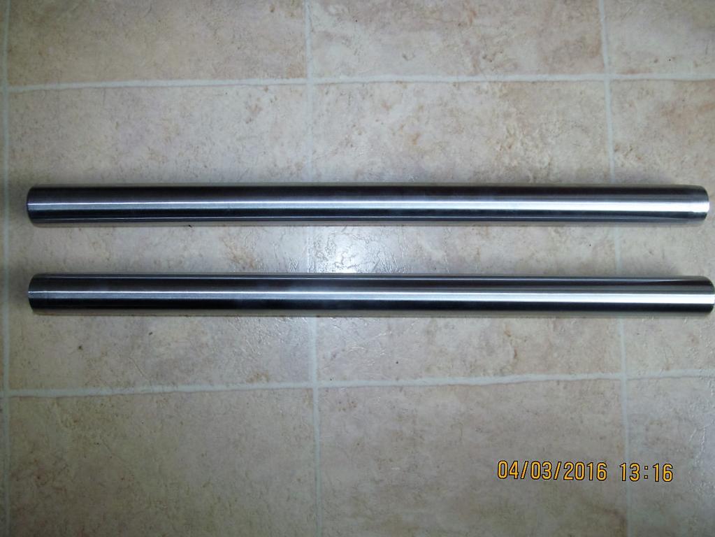

jlpar Posted March 9, 2016 Report Share Posted March 9, 2016 Hello guys, Finally got the fork tubes hard chromed! I think they look pretty good. I think I'll have to do some bloody work soon! Larry 2. 3 Quote Link to comment Share on other sites More sharing options...
scot taco Posted March 10, 2016 Report Share Posted March 10, 2016 Very nice!Thanks for the update. Quote Link to comment Share on other sites More sharing options...
