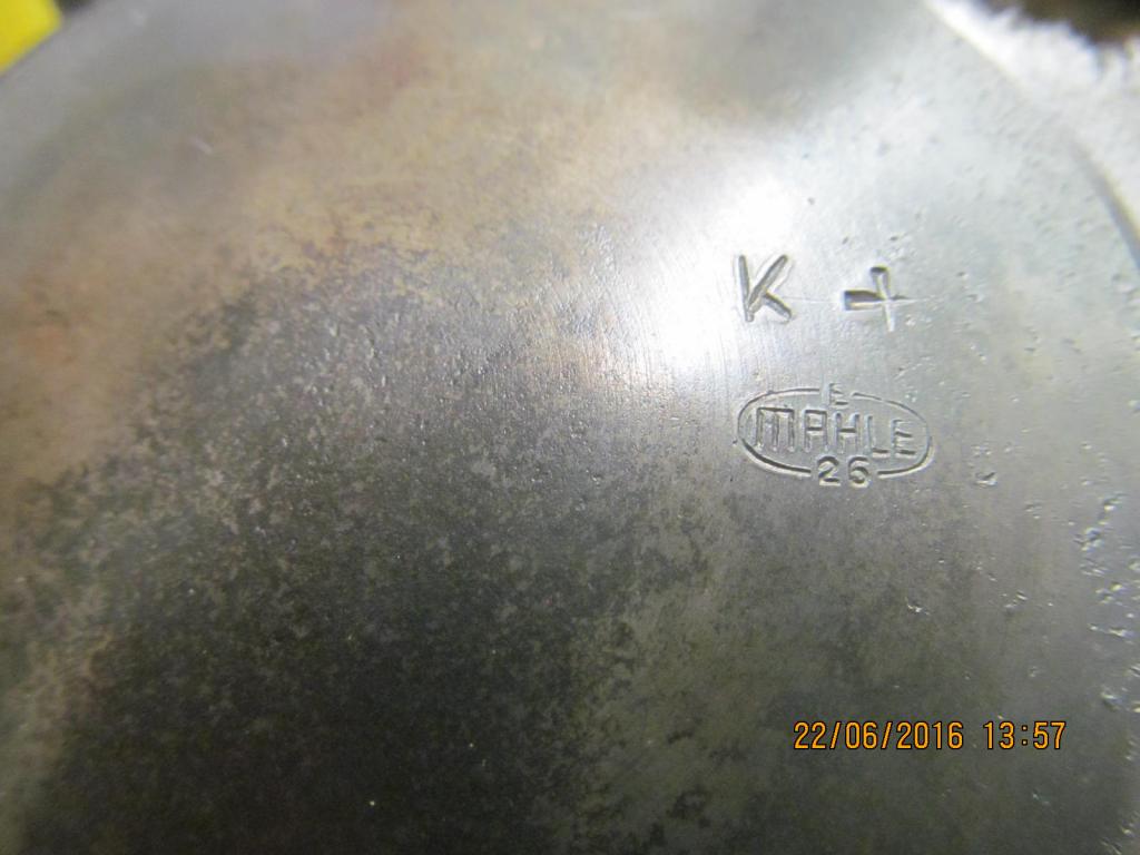

jlpar Posted June 23, 2016 Report Share Posted June 23, 2016 Guys, Another question coming up! Do these marks on the piston mean standard or oversize? Larry 2. Quote Link to comment Share on other sites More sharing options...
model80 Posted June 26, 2016 Report Share Posted June 26, 2016 (edited) Having bought and sold Mahle pistons for Bultaco's in a previous life time, they usually came marked with 0.25, 0.50, 0.75 and 1.00 on the crown of the piston to indicate oversized. Based on that, your piston appears to be Standard and not oversized. However I would like to see a photo of the complete crown (top) of the piston just to be certain. Edited June 26, 2016 by model80 1 Quote Link to comment Share on other sites More sharing options...

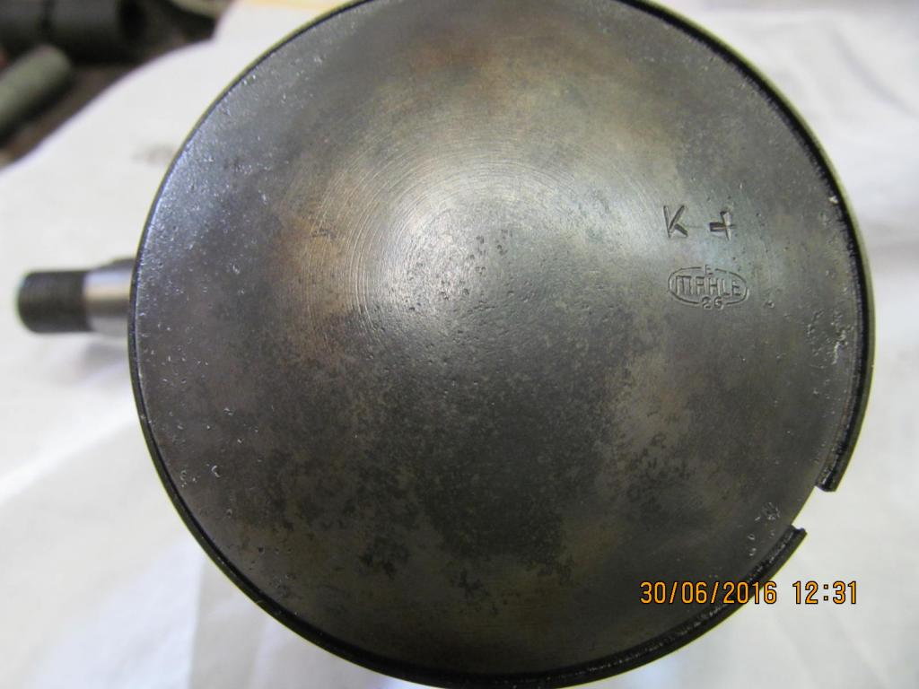

jlpar Posted June 27, 2016 Report Share Posted June 27, 2016 Thanks Model80 and Bondy, There are no other marks on the piston that I can see but I'll put up a pic anyway. If the piston is std I think new rings should do as there's very little wear on the cylinder. But I still have to establish that. Larry 2. 1 Quote Link to comment Share on other sites More sharing options...
jlpar Posted June 30, 2016 Report Share Posted June 30, 2016 Model 80, Here's a pic of the piston top. As you can see there's no further markings. Larry 2. Quote Link to comment Share on other sites More sharing options...
model80 Posted June 30, 2016 Report Share Posted June 30, 2016 (edited) Hi Larry2 It looks to me that you have a standard piston there. Have you removed one of the rings and inserted it into the bore, so as to check out the gap in the ring with a feeler guage? Edited June 30, 2016 by model80 Quote Link to comment Share on other sites More sharing options...

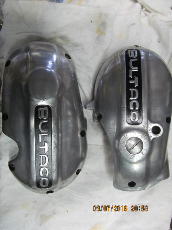

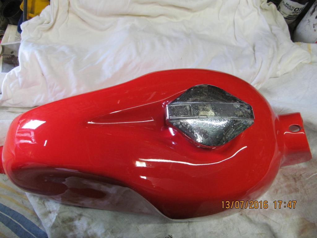

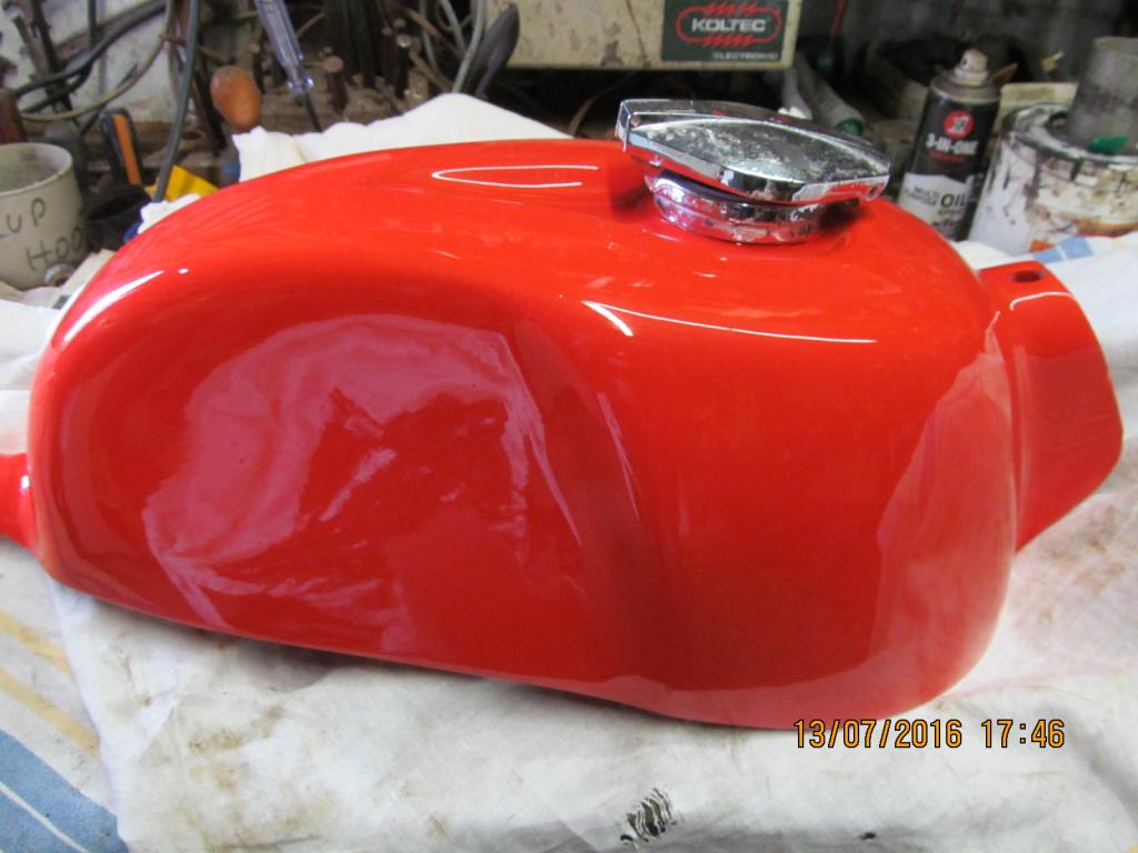

jlpar Posted July 23, 2016 Report Share Posted July 23, 2016 Hello guys, Just a small update. Got the tank back from the spray shop. I think it looks pretty good. I have to apply the decals but forgot to measure the exact location, Doh! I will try to estimate from my photos. I also refurbished the casings. Re. clutch pressure adjustment, I see elsewhere that it seems like trial and error is the order of the day. Any views? Larry 2. 5 Quote Link to comment Share on other sites More sharing options...
lbhbul Posted July 23, 2016 Report Share Posted July 23, 2016 Larry, looking really good!! The clutch adjustment that I use on 5 speeds (no experience w/4speeds) is adjust all the slack available @ the lever, adjust the clutch @ the engine to a light "no slack" then back off 1/4 turn or a little more, 1/2 turn max, lock it down & adjust @ the lever to a bit of clearance this hopefully will have you in good shape, fill in proper amount of Dexron ATF & let her rip. Have a good day Larry 2 Quote Link to comment Share on other sites More sharing options...
jlpar Posted July 25, 2016 Report Share Posted July 25, 2016 Thanks Larry, Good to have that info. Still quite a way to go but all this help will finally come good! Larry2 1 Quote Link to comment Share on other sites More sharing options...
model80 Posted July 26, 2016 Report Share Posted July 26, 2016 (edited) Model 80, No haven't tried that but I'll do it and see what I get. Trouble is if there's a bit of wear in the cylinder and on the ring, then the gap may not make me any wiser. Anyway, what gap should I expect? Thanks for the response, Larry 2. Hi Larry Apologies for not getting back sooner. I have a notebook with all this info, bore size tolerences, ring gaps, etc and do you think I can find it! I've tore the garage apart looking for it and can't locate it, I wouldn't mind some of the information was written up over 30 years ago when I used to work with an old gent who spent his day boring barrells and truing cranks shafts. Will keep looking. Your paint and polishing jobs have truned out really nice. You're spot on about the clutch adjustment its trial and error, followed by refined adjustments. Edited July 26, 2016 by model80 Quote Link to comment Share on other sites More sharing options...
