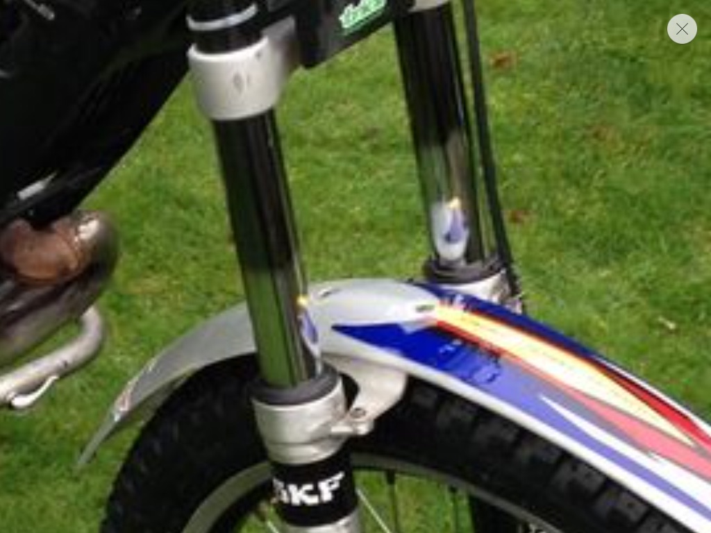

andilicious Posted October 31, 2014 Report Share Posted October 31, 2014 (edited) Hi I'm thinking of buying an 06 290 but the forks are as the pic attached. Is this normal/ cosmetic or actual wear / damage? Thanks Andy Edited October 31, 2014 by andilicious Quote Link to comment Share on other sites More sharing options...
cabby Posted October 31, 2014 Report Share Posted October 31, 2014 Looks just like the coating having wore off, nothing to worry about. Quote Link to comment Share on other sites More sharing options...
elliotsdaddy Posted October 31, 2014 Report Share Posted October 31, 2014 Looks just like the coating having wore off, nothing to worry about. Agree. Looks just like my forks. As mentioned above, don't worry about it. Quote Link to comment Share on other sites More sharing options...
dadof2 Posted October 31, 2014 Report Share Posted October 31, 2014 Even wear all round is OK. If there is more wear or it extends further on one side suspect bent fork tube. Quote Link to comment Share on other sites More sharing options...
