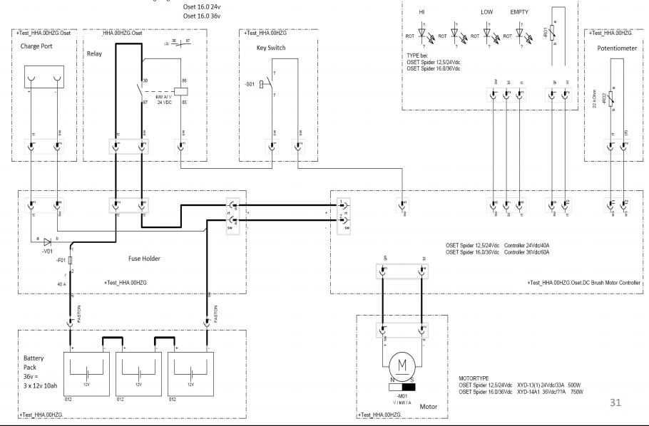

demongibbo Posted November 2, 2014 Report Share Posted November 2, 2014 hya i purchased a oset 16 36v of a friend as a non runner. i got it home had a tinker with it and found a red wire hanging down it has a inline 240v fuse. one end went to another red wire with shrink tube and the other end wasnt connected. any light on this or can and body post a pic of where it goes to. any help would be great. il try and upload a photo Quote Link to comment Share on other sites More sharing options...
purkyuk Posted November 3, 2014 Report Share Posted November 3, 2014 See attached wiring diagram... Hope it helps Wiring diagram.pdf Quote Link to comment Share on other sites More sharing options...
gwhy Posted November 3, 2014 Report Share Posted November 3, 2014 this diagram shows the fuse that you are referring to: Quote Link to comment Share on other sites More sharing options...
