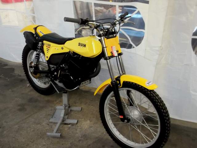

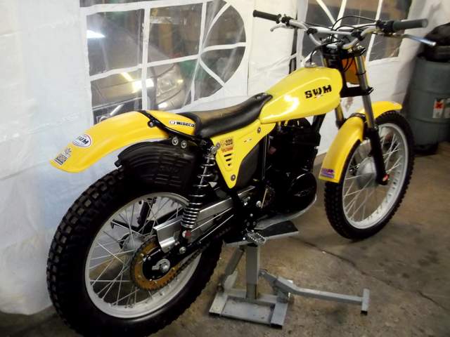

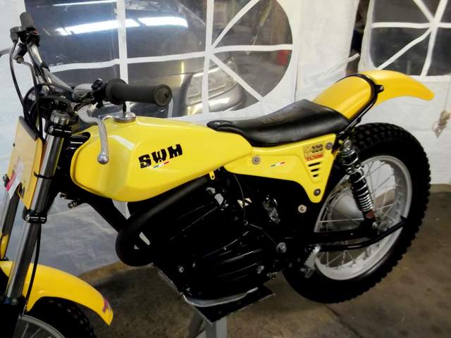

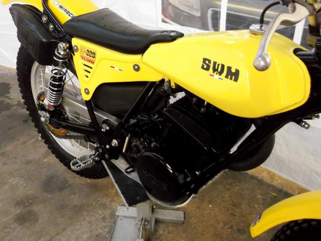

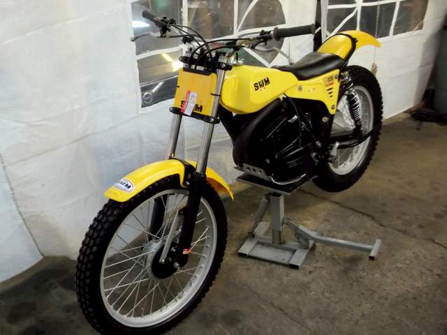

iconic558 Posted December 6, 2014 Author Report Share Posted December 6, 2014 finished her this morning, not too shabby for a quick tart up. 4 Quote Link to comment Share on other sites More sharing options...
iconic558 Posted December 6, 2014 Author Report Share Posted December 6, 2014 that mudguard needs work! Quote Link to comment Share on other sites More sharing options...
metisse Posted December 6, 2014 Report Share Posted December 6, 2014 Looks great, well done.. now to get out in some Eastern centre mud... Quote Link to comment Share on other sites More sharing options...
lbhbul Posted December 6, 2014 Report Share Posted December 6, 2014 Been following this with interest, really looks good! I see you got the bash plate on, we have all been there. Nice work Larry Quote Link to comment Share on other sites More sharing options...
pschrauber Posted December 6, 2014 Report Share Posted December 6, 2014 (edited) Great outcome very sanitary, but ... I personal do not like the fasteners of the sidepanels and rear fender to name two places and would change them. Why not use these screws which rounded head which are called round headed bolts, these fits much better to the bike and were of the type SWM used back in the day, you get them in steel and stainless steel: Forgot to name them in German: Becherschraube, (try google / fleabay) Edited December 7, 2014 by pschrauber 1 Quote Link to comment Share on other sites More sharing options...
iconic558 Posted December 8, 2014 Author Report Share Posted December 8, 2014 Great outcome very sanitary, but ... I personal do not like the fasteners of the sidepanels and rear fender to name two places and would change them. Why not use these screws which rounded head which are called round headed bolts, these fits much better to the bike and were of the type SWM used back in the day, you get them in steel and stainless steel: Forgot to name them in German: Becherschraube, (try google / fleabay) yes, this is how SWM built them originally and many thanks for the link, but for me I like to use an allen fittings where ever I can as it's less tools to carry around in my bum bag, or erm, fanny pack. Quote Link to comment Share on other sites More sharing options...
pschrauber Posted December 8, 2014 Report Share Posted December 8, 2014 OK your bike and your needs, there are too Inbus (Allen) Linsenflachschrauben (in english "complicated") available ... but they look a little bit different: Also on fleabay ... http://www.ebay.de/sch/i.html?_from=R40&_trksid=p2050601.m570.l1313.TR0.TRC0.H0&_nkw=Inbus+Linsenflanschschrauben+&_sacat=0 1 Quote Link to comment Share on other sites More sharing options...
