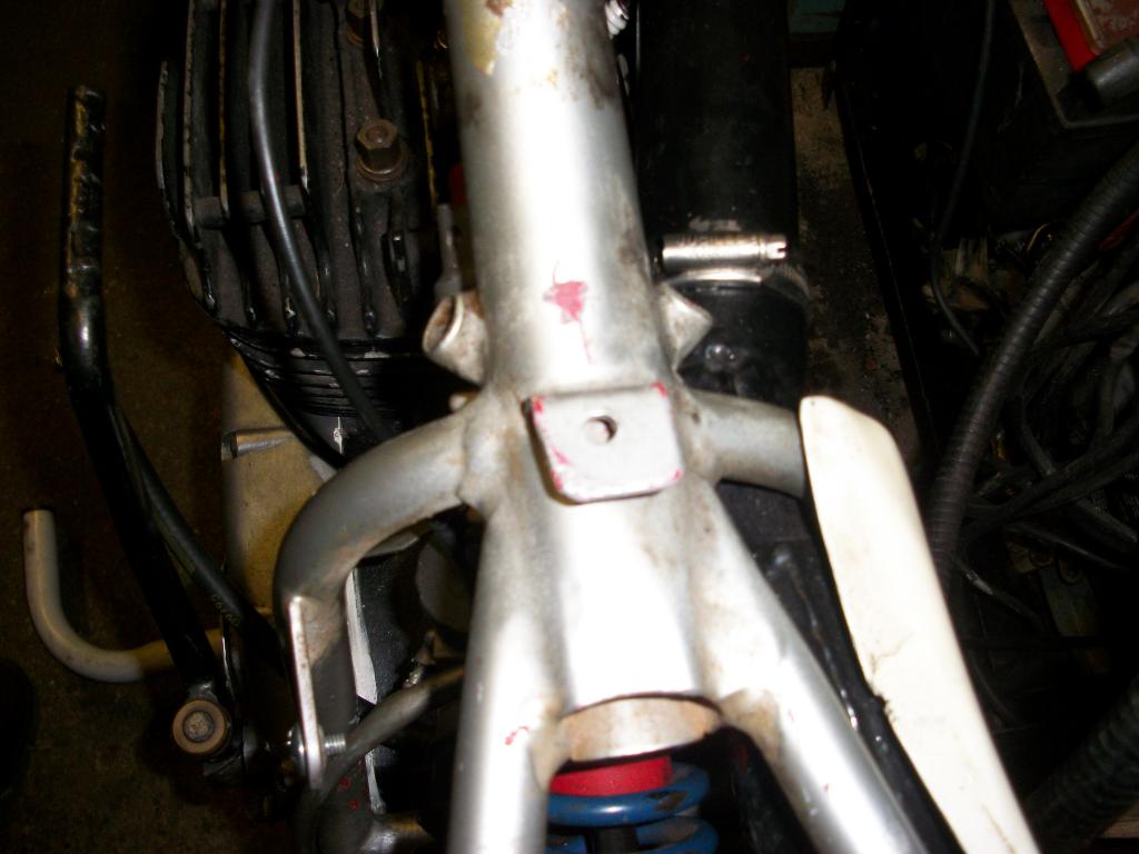

bambam_n_chunx Posted November 21, 2014 Report Share Posted November 21, 2014 I know i`ve probably bored everyone by now but when I removed the tank today I noticed it had what looks like two tank stops on the top tube. I`ve never seen these before and thought it might be a clue as to who made the frame. Any info on the frame or bike would be gratefully received. Quote Link to comment Share on other sites More sharing options...

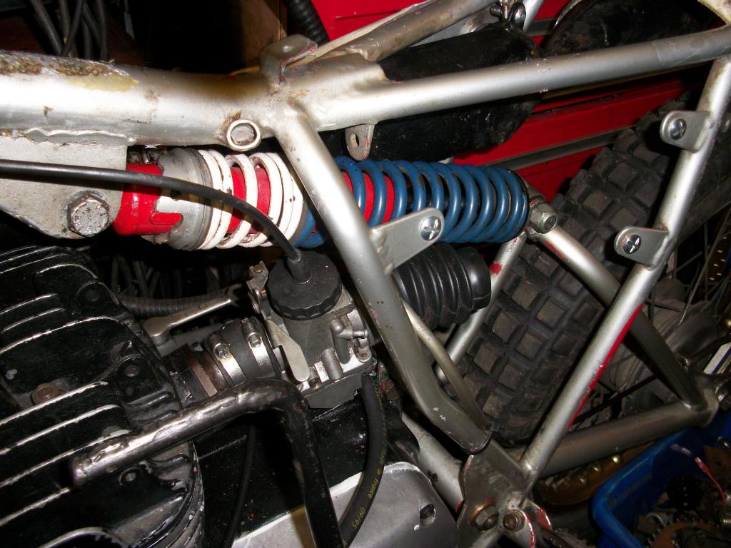

twinshock giles Posted November 21, 2014 Report Share Posted November 21, 2014 (edited) I think what they are is the original mounting point for the side tubes - it looks like they've been moved at some point and whoever did it didn't bother to get the grinder out and tidy up afterwards. That motor is odd, there are mounting points for head steadys/ braces which I don't think I've seen before on a MAR? Edit - no scratch that they look to be pointing upwards. I don't think thats a pro built frame - well certainly not the monoshock top mount you can see where the weld has had to be tidied up with a grinder, if you were doing frames all day you wouldn't need to be doing that. Are there any identifying features on the shock itself? Edited November 22, 2014 by twinshock giles Quote Link to comment Share on other sites More sharing options...
baldilocks Posted November 22, 2014 Report Share Posted November 22, 2014 Thats a moto fox shock from a twin shock bike by the looks of it Quote Link to comment Share on other sites More sharing options...
bambam_n_chunx Posted November 22, 2014 Author Report Share Posted November 22, 2014 I thought that but this has no air valve and I thought they all did, also it seems to work ok and if it were meant to be a pair would it be strong enough. I've had an email from someone claiming his dad built it and he would like to buy it back for sentimental reasons but obviously it's not worth a great deal any thoughts on this Quote Link to comment Share on other sites More sharing options...
baldilocks Posted November 22, 2014 Report Share Posted November 22, 2014 Looks long ? MX ones are probably stronger ? Quote Link to comment Share on other sites More sharing options...
tlrmark Posted November 23, 2014 Report Share Posted November 23, 2014 (edited) As stated it is definitely a fox shock, as to whether it was a fox twinshock shock or origonaly a monoshock easy to determine as a monoshock shaft was 5/8 and the twinshocks were 1/2. Regarding lengths of fox twinshocks, I had a 16 inch set on a Honda in the 1980s. I should say they were 16 inch long fox trial shocks not mx. Edited November 23, 2014 by tlrmark Quote Link to comment Share on other sites More sharing options...

woody Posted November 23, 2014 Report Share Posted November 23, 2014 It looks as though it is from the picture. The Ossa top and bottom bearings are the same size, so the flange in the headstock is the same top and bottom. On your frame they're different sizes, plus there looks to be an additional flange above the bottom one. The gusset plates are quite different too where the tank rubbers mount, and the coil mounting is in a different place. From the other photos, if I remember correctly, the rear of the top tube is very different from a MAR as well. On a MAR it flattens out to where the seat rails begin. It's also different where the rear of the bashplate mounts. Quote Link to comment Share on other sites More sharing options...

trialsrfun Posted November 24, 2014 Report Share Posted November 24, 2014 The frame does appear to be a standard OSSA modified, the cylinder head with the head steady mounts is identical to that on my TR77 model. Quote Link to comment Share on other sites More sharing options...
