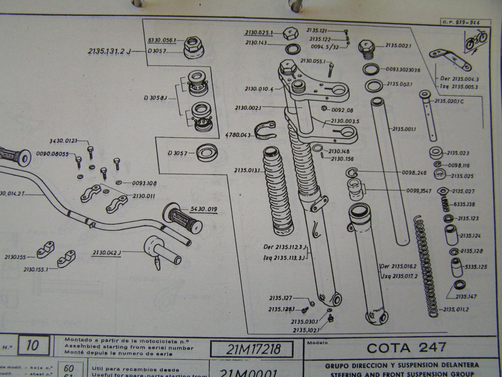

hewson Posted December 20, 2014 Report Share Posted December 20, 2014 Hello all , anybody got a diagram of the front fork assembly on the Mont 247 twinshock please ....Merry Xmas Quote Link to comment Share on other sites More sharing options...

hewson Posted December 21, 2014 Author Report Share Posted December 21, 2014 Ask Greeves , do you have the description for the parts and numbers please , only need the fork leg bottom damper info ....Cheers Quote Link to comment Share on other sites More sharing options...
ask greeves Posted December 21, 2014 Report Share Posted December 21, 2014 Hewson, Had to really think about your question ? On 12/21/2014 at 12:18 PM, hewson said: Ask Greeves , do you have the description for the parts and numbers please , only need the fork leg bottom damper info ....Cheers The picture of the part would be the description and the number next to it....the number. Merry Christmas Quote Link to comment Share on other sites More sharing options...
hewson Posted December 23, 2014 Author Report Share Posted December 23, 2014 Anyone else have more info on these forks please , a good photo of the internals would be nice , i have some parts missing , part NUMBER 2135-123 , is it a shuttle washer ...Cheers Quote Link to comment Share on other sites More sharing options...
woody Posted December 23, 2014 Report Share Posted December 23, 2014 I had a manual for the 247 I once had and the problem with them is that they don't give a written description for the part number, you have to guess from the picture 123 does look like the valve washer, 124 being the valve body. 027 looks as though it is the second part of the valve washer assembly, ( the part that is the ring with holes in on the Bultaco forks - replaced with a square shim on some 340 forks) Not sure what 025 is but 023 is the piston with 116 the circlip that secures it to the damper rod. You reaslly need someone with a set they can strip and look at, they are the same forks on the 348 and early 349, probably 172 and early 200 as well. Quote Link to comment Share on other sites More sharing options...
