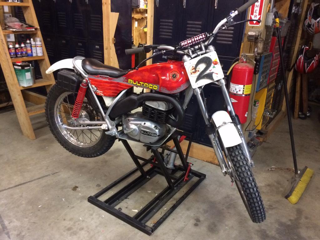

lbhbul Posted April 12, 2015 Report Share Posted April 12, 2015 What a job to repair dads poor weld , tear it all apart to retrieve the swing arm so the repair can take place properly. Bondy , thanks for checking the label , will check my 199 after the 92 is up on its feet again. Larry 2 Quote Link to comment Share on other sites More sharing options...
lbhbul Posted April 13, 2015 Report Share Posted April 13, 2015 We did get it back together after all, proper welds this time (not me this time). This old girl has a lot of history and still a lot to go. Will get into the 199 air box stuff tomorrow maybe?? Have a nice day, Larry 1 Quote Link to comment Share on other sites More sharing options...
lbhbul Posted April 18, 2015 Report Share Posted April 18, 2015 As promised to get on with the saga of air filter bellows hose problems, managed to tear old Red apart to get to the air box properly. Was quite relieved to find the hose all in one piece, as it had been years since having put a new one on (shame on me).On a brighter note my good friend received 2 new hose/filters (back order) and on careful examination found them to be OK!!! Same mfg. as the previous of course. Do hope you guys will contribute too Larry 1 Quote Link to comment Share on other sites More sharing options...
saw miller Posted April 18, 2015 Report Share Posted April 18, 2015 Glad to see your bellows are not a problem! Time for reassembly and riding. Wish I were there. Just installed the 151 frame, swing arm, and wheel, that I picked up from Larry during our visit. A definite upgrade for the Rat. The original model 92 frame was bent badly. Swapped it for an alpina frame. Now swapped for a proper sherpa frame again. 3 frames in a year and a half. Tripp 4 Quote Link to comment Share on other sites More sharing options...
