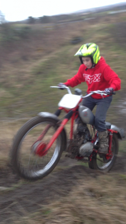

john b Posted January 1, 2015 Author Report Share Posted January 1, 2015 Many thanks for the reply I think that's how I was riding (and my son riding) after a while today. I said leave the clutch completely alone - it will pull on tick over, and even if you wind the throttle on hard, its not like a modern bike and wont leap out of your hands. It seems a nice little bike to ride (1955 James Captain) - its very small and light, and like I said the power delivery surprised me (almost 4 stroke - will pull from nothing). I may get a new bigger tooth back sprocket for it, or just let Chris get used to riding it as it. thanks again John 1 Quote Link to comment Share on other sites More sharing options...

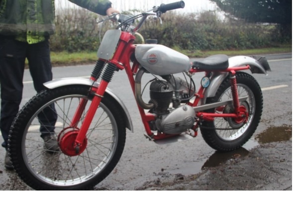

john b Posted January 2, 2015 Author Report Share Posted January 2, 2015 Thanks for the reply I'm a pre 65 newcomer so may well be (anything post 1980 I'm ok on !) It was sold as a converted captain - it has v5 but was first registered a couple of years ago. Any advice on it welcome ! (Another photo below) Cheers John 2 Quote Link to comment Share on other sites More sharing options...

john b Posted January 5, 2015 Author Report Share Posted January 5, 2015 Thanks for the photo! Definitely looks very similar to mine, and any other photos appreciated Cheers John Quote Link to comment Share on other sites More sharing options...
