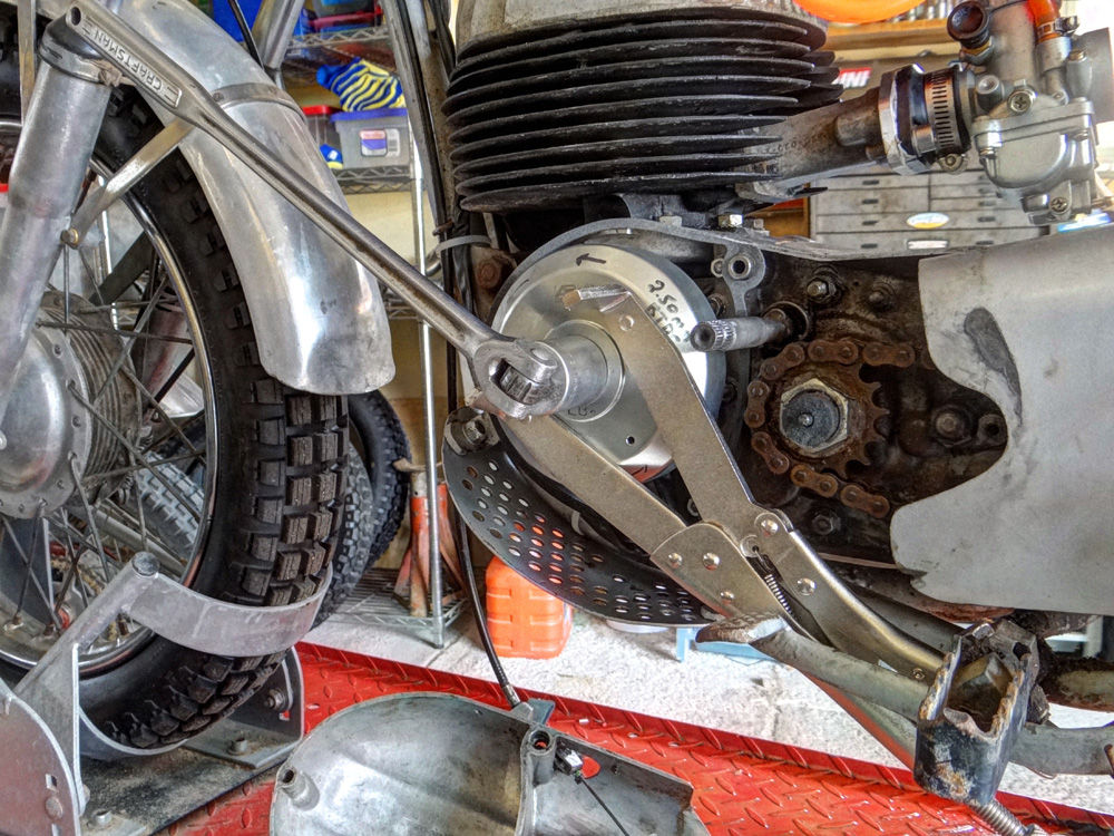

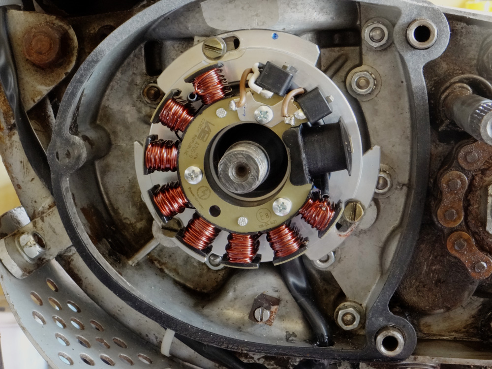

Above is a picture of the flywheel/rotor/magneto ready to be removed...again...in order to get the timing just right. Below is picture of the stator provided in the Powerdynamo kit. It makes me feel good to know that this is what lies beneath the rotor rather than the ancient and greasy points which used to live in this location.

Powerdynamo sells Czech made Vape ignitions which this is looking at the stator plate, I considered buying 1 for my CZ race bike but didn't in the end due to the lack of advance. Nicely made gear though
