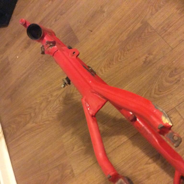

jonny13 Posted January 5, 2015 Author Report Share Posted January 5, 2015 I never said its a work bike,all I said is its different,u can't pick works bikes up on eBay for 400 quid,I' don't think I've shown a photo of fly wheel cover side,as saying I got it as a doner bike I got a twin frame to build on I'm new to fantics and just needed advice which parts to order by frame n/o for the engine,for a hobby,the frame gone now history,I just thought it was different because of added frame part proberly stuck on to hide a fracture so no offence to Fantic fans if anyone got wrong impression ,all I want to know why was it there I show pic . Quote Link to comment Share on other sites More sharing options...
wobbler Posted January 6, 2015 Report Share Posted January 6, 2015 Sidecar bracket for definate - my mate has a 300 twinshock sidecar with a similar set up !!! Best get a 240 frame and put your engine in !!! 340 Fantic - the dogs bol****s !!!! Quote Link to comment Share on other sites More sharing options...

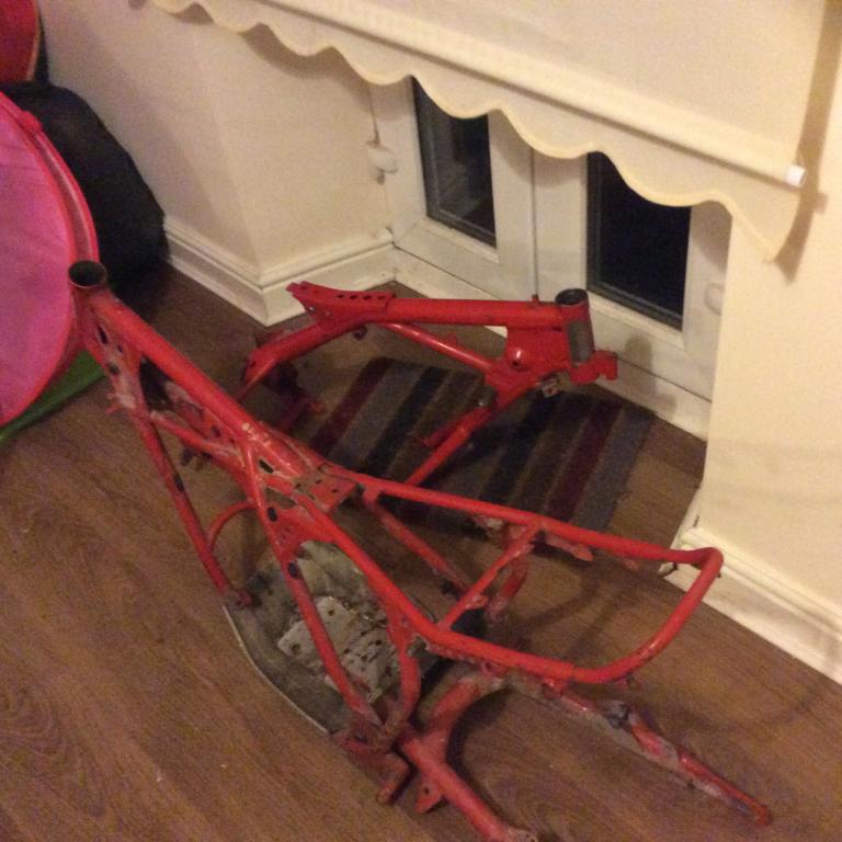

jonny13 Posted January 8, 2015 Author Report Share Posted January 8, 2015 I bought a 403 twin shock or 300 frame then gas gas forks it will take some mods but worth starting a new hobby , Quote Link to comment Share on other sites More sharing options...
jonny13 Posted January 8, 2015 Author Report Share Posted January 8, 2015 I now got a 240 twin frame ,so that is the best one to use ,? Im starting a collection I think eBay then get rid of them Quote Link to comment Share on other sites More sharing options...
blocky Posted January 8, 2015 Report Share Posted January 8, 2015 I hope you have deep pockets... Very few of the mono parts will fit the twinshock frames. Engine will easily fit the 300 frame but major modifications will be needed to the 240 frame. Front end will fit either bikes with only spacers needed. Rear brake plate is different. Tank/seat will not fit. Neither will exhaust, airbox or swinging arm without modification. If you work at it, you will end up with something special or a pile of junk Quote Link to comment Share on other sites More sharing options...
jonny13 Posted January 9, 2015 Author Report Share Posted January 9, 2015 U are right,I'm sticking to the 403 mono to 403 twin I got them ready,thanks Quote Link to comment Share on other sites More sharing options...

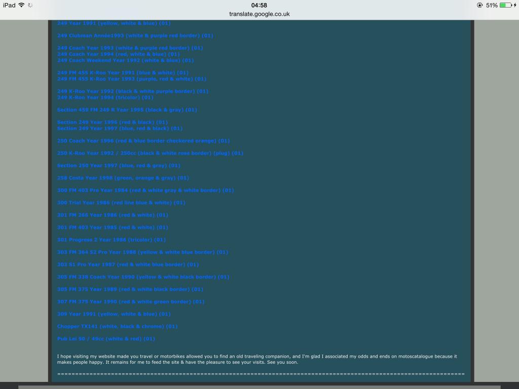

jonny13 Posted January 9, 2015 Author Report Share Posted January 9, 2015 301 fm 266 yr 1986 red and white 301 fm 266 progress 2 yr 1986 tri colour 301 fm 403 yr 1985 red and white 300 fm pro yr 1984 300 trial 1985 Quote Link to comment Share on other sites More sharing options...
