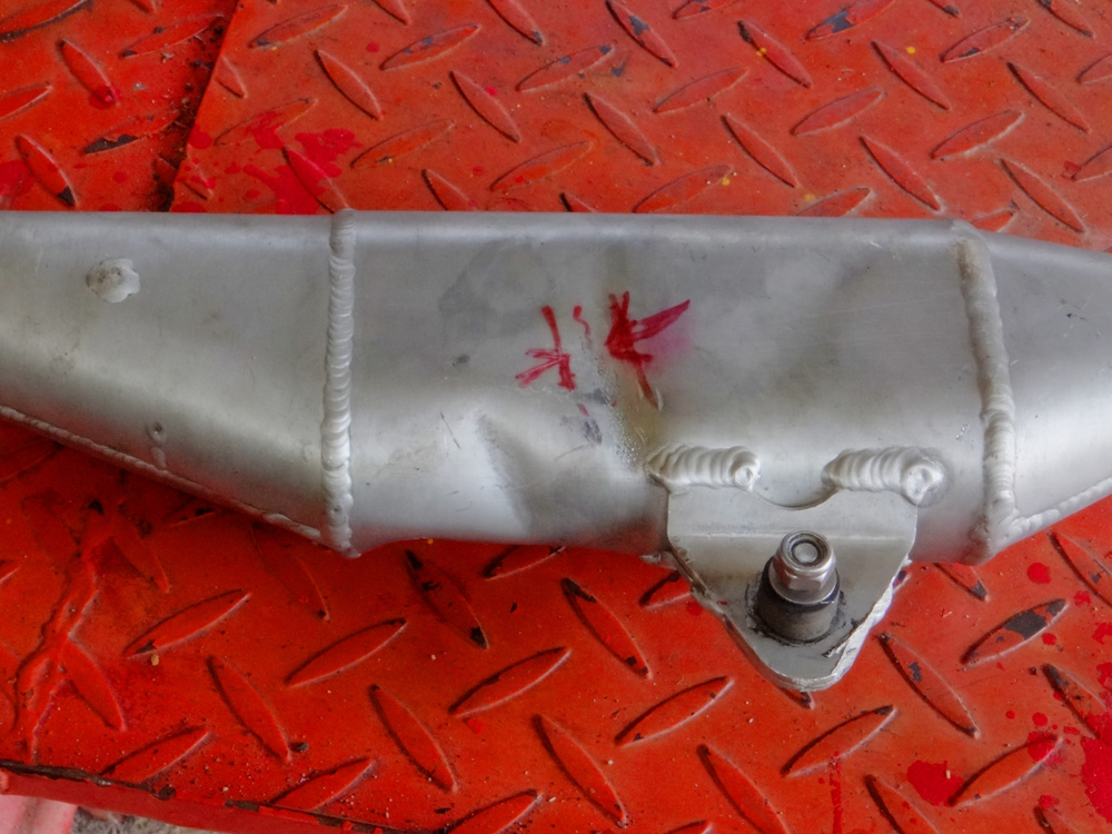

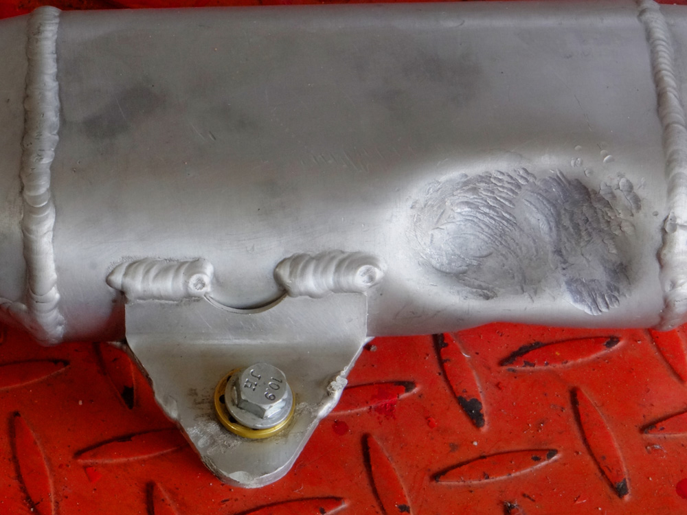

mmmexico Posted January 15, 2015 Report Share Posted January 15, 2015 This is the "modification" that I made to my WES mid-box. As delivered it simply would not fit my TY 175. Above is the modification that I made on the kickstart side. If this modification had not been made, the kickstart lever would be bouncing against the mid-box and making a nuisance of itself. There really is not much to the technique although you have to be patient and be prepared to mount and dismount the mid-box a lot of times. Just mount it up and use a felt tip marker to identify the point of contact. Then dismount the mid-box and start bashing in the mid-box with a ball peen hammer until you think you have given yourself enough clearance. Take your time. Don't be in a hurry and don't try to do the bashing while the mid-box is still mounted on the bike. You will probably deform the mounting tab. Below is a picture of the back side of the mid-box which was similarly modified to fit closer to the frame. This modification was necessary because if I hadn't closed the mid-box up to the frame I would not have been able to mount the silencer so that it snaked behind the shock mount. For this modification I used a slightly different technique. I marked the areas where the frame tubes were contacting the mid-box and then laid a very stout pipe on the same line and then I bashed the pipe to make a reasonably straight indentation. Without this modification the mid-box would have been vibrating against the frame. By the way, none of this is a criticism of the WES system. These modifications just show what a strong system has been created by these guys. The WES system on my TLR fits perfectly. Maybe the TY frames changed over time...Who knows. Happy Bashing! Quote Link to comment Share on other sites More sharing options...
