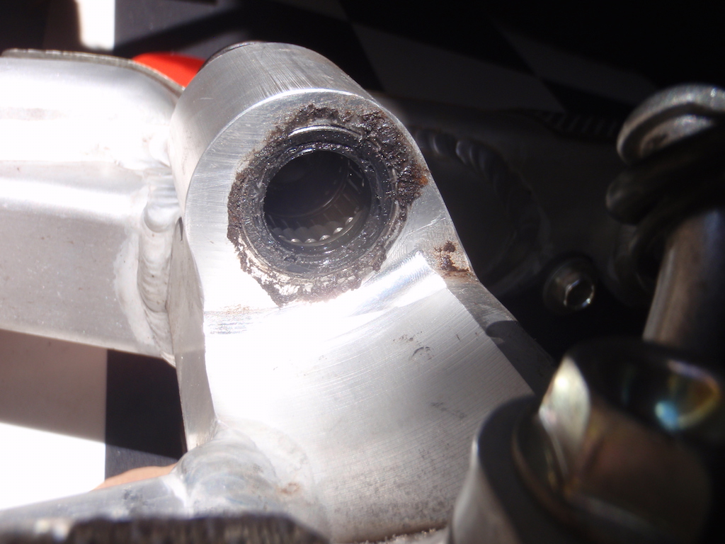

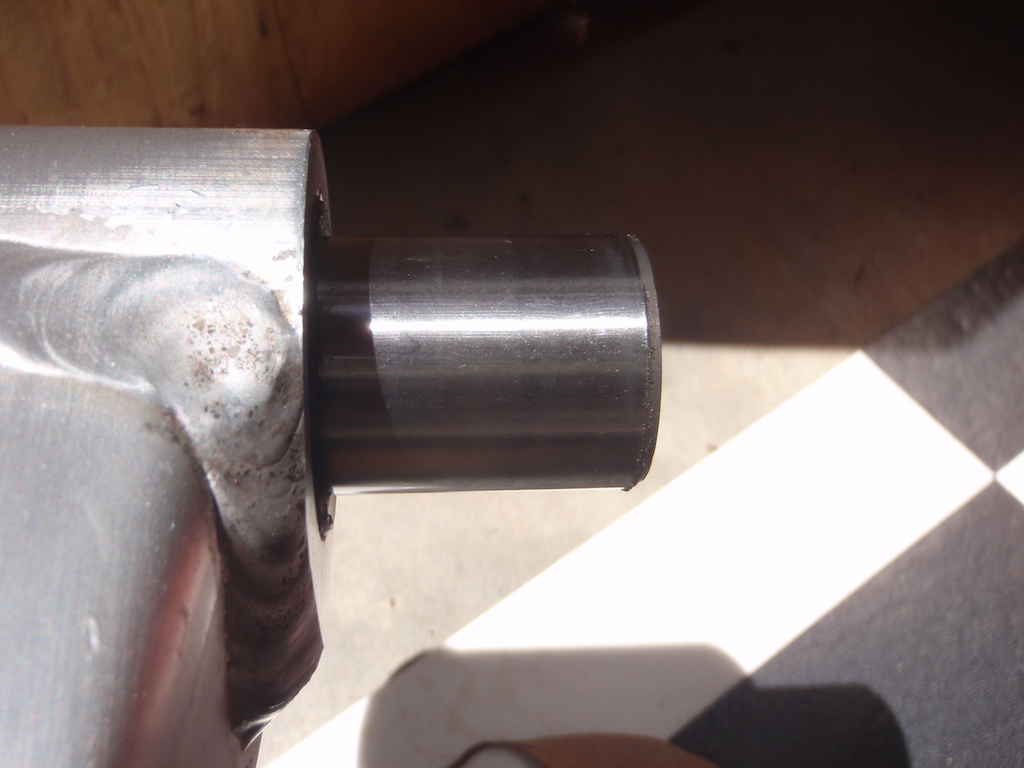

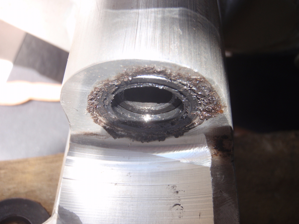

hannu Posted February 1, 2015 Author Report Share Posted February 1, 2015 On 2/1/2015 at 7:23 PM, the addict said: I took it they had perished long ago, I grease everything on a new bike and if that had been done if the bearing was missing it would have been picked up before the first ride not 10 months later. I've serviced other peoples bikes and seen virtually no signs of a bearing in the dog bones or linkages as they've never been greased or serviced before, just fell out or disintegrated. I'll apologise now if I'm totally mistaken though, and its possible this is a pdi problem not Honda's? Point taken but strange how all the other bearings were clean dry and in full working order ! 2 Quote Link to comment Share on other sites More sharing options...
jrsunt Posted February 1, 2015 Report Share Posted February 1, 2015 Was it the rear end of the dog bone? And the bearing that sits closest to the small collar rather than the bush? Quote Link to comment Share on other sites More sharing options...
hannu Posted February 1, 2015 Author Report Share Posted February 1, 2015 On 2/1/2015 at 8:24 PM, jrsunt said: Was it the rear end of the dog bone? And the bearing that sits closest to the small collar rather than the bush? No it was the one in the swinging arm furthest from the small collar, it just looks like a blank plastic bush with no needle rollers in it. I've order a new bush kit from H & D so I'll photograph the old ones as I remove them. Quote Link to comment Share on other sites More sharing options...

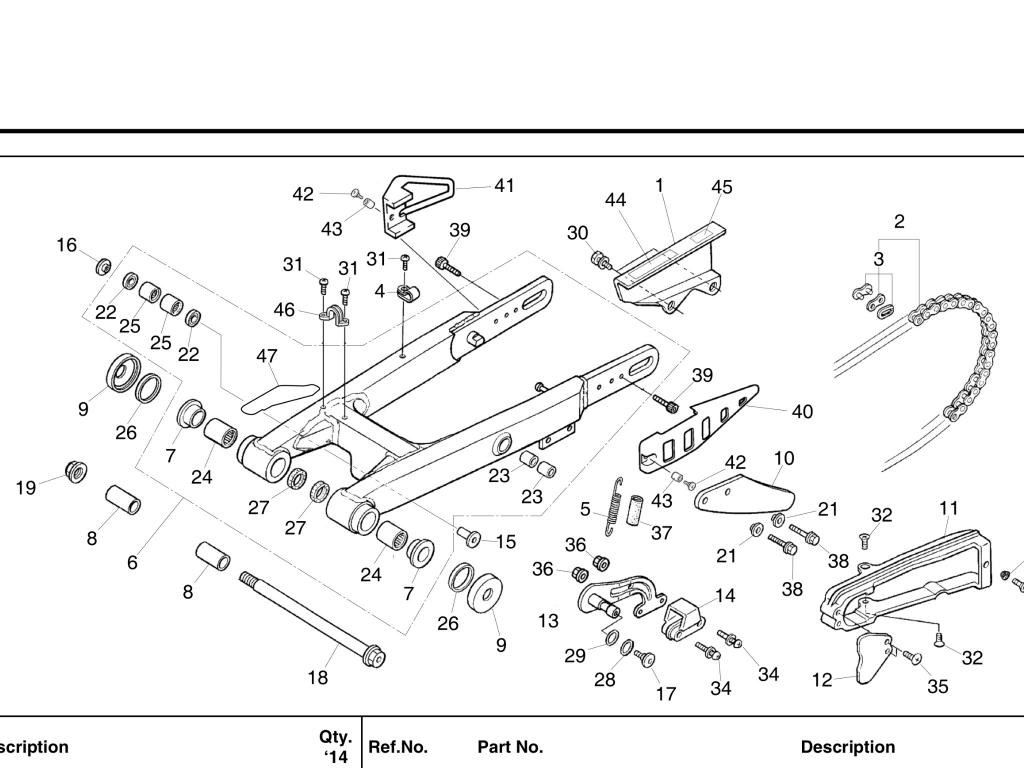

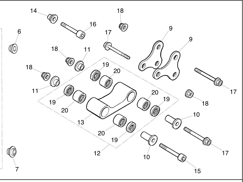

jj65 Posted February 1, 2015 Report Share Posted February 1, 2015 (edited) Tbh, I don't want to offend you, but, if you'd serviced it, somewhere inline with what it suggests in the manual, one, you wouldn't have these problems in the first place, but, two, if the bearing was missing, you'd have got it covered by the warranty. It's generally lack of maintanance that causes the bearings to fail, they need regular cleaning and greasing, it isn't maintaince free, just because it a Honda, I mean Montesa. All the bearings are below. Edited February 1, 2015 by jj65 Quote Link to comment Share on other sites More sharing options...
hannu Posted February 1, 2015 Author Report Share Posted February 1, 2015 On 2/1/2015 at 9:08 PM, jj65 said: Tbh, I don't want to offend you, but, if you'd serviced it, somewhere inline with what it suggests in the manual, one, you wouldn't have these problems in the first place, but, two, if the bearing was missing, you'd have got it covered by the warranty. It's generally lack of maintanance that causes the bearings to fail, they need regular cleaning and greasing, it isn't maintaince free, just because it a Honda, I mean Montesa. All the bearings are below. Yes ok I get that I should have lubricated the needles before now however all that are present don't seem to have suffered, clean smearing of the original grease still on and little signs of wear. As for the warranty it clearly states on purchase there is no warranty, If I kicked off no doubt the dealer would supply the bearing but I just haven't the time to take the bike all the way back !! And the point of my post was the quality of the product ie NO BEARING FITTED not my lack of servicing. ( I'm not offended but clearly believe that in this day and age the suggestion in the manual that you should strip and lube the suspension linkage after each event is a bit much, why have seals on the ends if this be the case ?) 1 Quote Link to comment Share on other sites More sharing options...

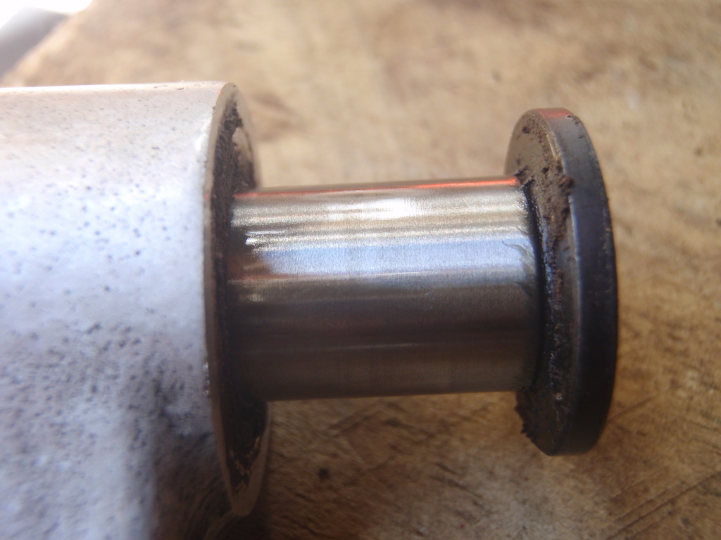

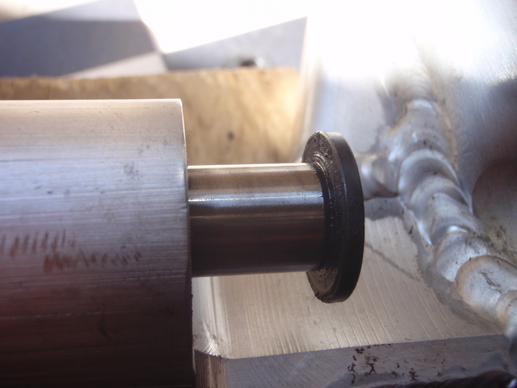

mags Posted February 2, 2015 Report Share Posted February 2, 2015 (edited) You boys got me a little worried so I pulled mine apart for the first time today. I have about 30 hrs on my 2014 Cota Standard 4RT. Two comps and about a year worth of practice. I've found no bearings missing and lube sufficient to keep them at a good service life with inspection. The swingarm ones are a little dryish but there was a lube film there. I'll clean, regrease and assemble now. Didn't find any appreciable play in the bearings nor any brinelling on the pivot pins...Yay! Some pics... Mags Edited February 2, 2015 by mags 1 Quote Link to comment Share on other sites More sharing options...
mags Posted February 2, 2015 Report Share Posted February 2, 2015 Some more... Mags 1 Quote Link to comment Share on other sites More sharing options...
shyted Posted February 2, 2015 Report Share Posted February 2, 2015 (edited) Ah well . Now we get down to the nitty gritty. stripped every linkage and bearing on the chassis before i even did anything from new last year when i bought new. To find what ? Very little or no grease at all on some of the shaft's or bearing assemblies.I was seathing ! They got a rocket up there ass from me . So whoever assembles the chassis isn't greasing as they should and if it's a Honda product ,that name stands for quallity throughout the motor cycle world . Honda are being very nice about my clutch assembly,SO DON'T GIVE UP. Hey mags if that was my bike it would be back at the shop now considdering where you live .It's not on ! Edited February 2, 2015 by shyted Quote Link to comment Share on other sites More sharing options...
