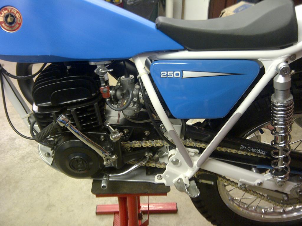

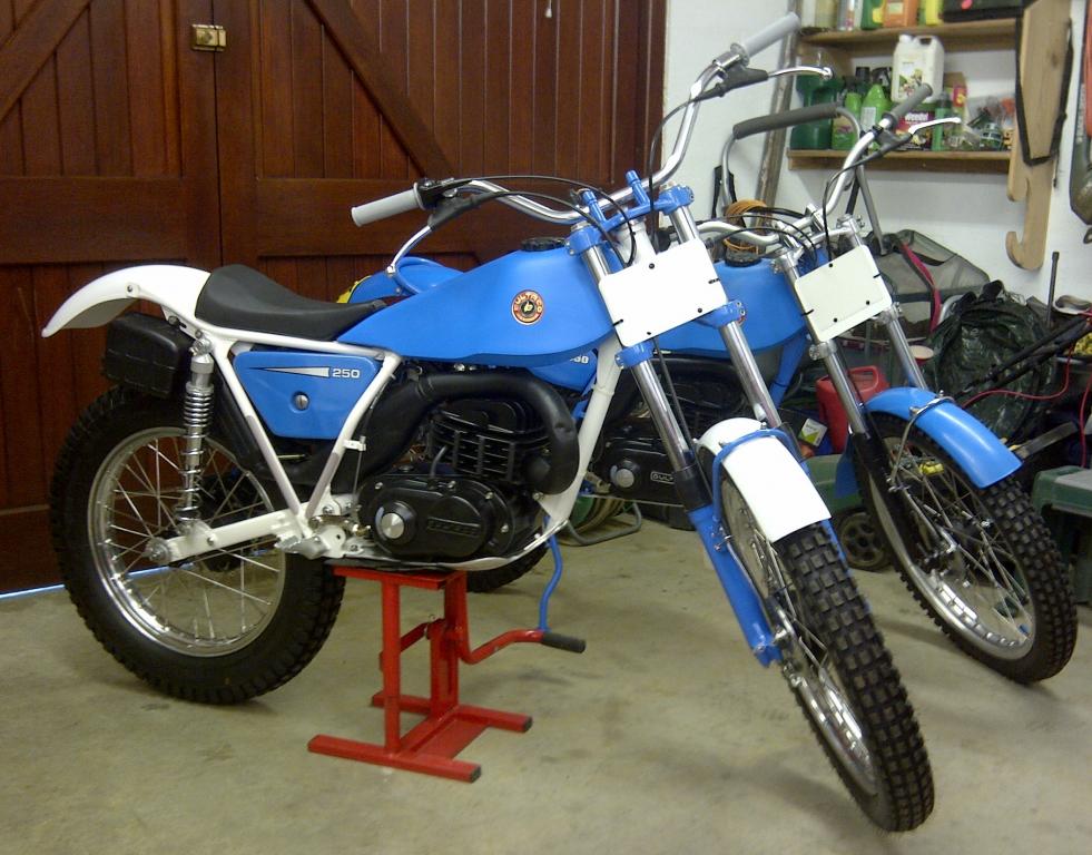

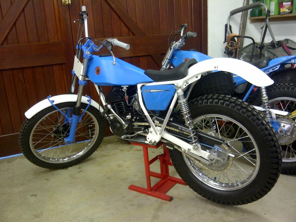

big_e Posted January 19, 2015 Report Share Posted January 19, 2015 By way of thanks for the Site member's help regarding flywheel size on my latest project, a very tired but genuine 198B, I thought you might like to see the bike in its completed state. The usual thanks to Dave, Pete and Robin at InMotion of course. Not ridden in anger yet, I use my 199A for trials, but it certainly revs very freely in comparison with the 350. I also managed to get hold of an earlier pattern airbox, which is a vast improvement on the correct 1980 pattern, easier to access and I think probably more water-proof. I used a modified Gas-Gas piston in the re-bore, a bit cheaper to buy but fairly tricky to machine the skirt and the inside of the gudgeon pin bosses. I am particularly pleased with the two-pack satin finish on the castings and the powder coated frame. I used Fastline Coatings in Preston, not cheap but very good. I love Bultos but I might try an SWM next. Any thoughts? 9 Quote Link to comment Share on other sites More sharing options...

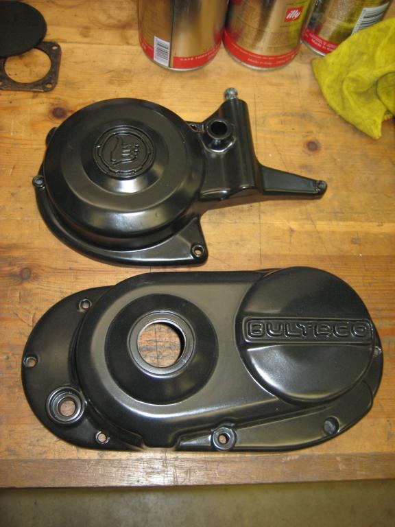

bullylover Posted January 20, 2015 Report Share Posted January 20, 2015 Your M198B looks very good but one thing which improves the look a lot is to sand the ignition case down to aluminium where the thumb imprint is so it is shiny and do the same on the Bultaco on the primary case. This just sets them off. It makes the Bultaco and the thumb stand out against the black paint. Graham. 1 Quote Link to comment Share on other sites More sharing options...

bondy Posted January 21, 2015 Report Share Posted January 21, 2015 (edited) the tumbs logo should look like this 1 nice job mate on the 198B Edited January 21, 2015 by bondy Quote Link to comment Share on other sites More sharing options...
