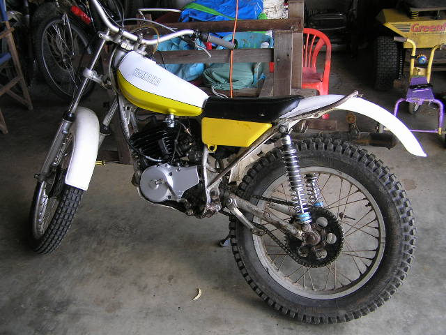

feetupfun Posted January 27, 2015 Report Share Posted January 27, 2015 Here is what the TY175 with DT175E motor looked like Quote Link to comment Share on other sites More sharing options...

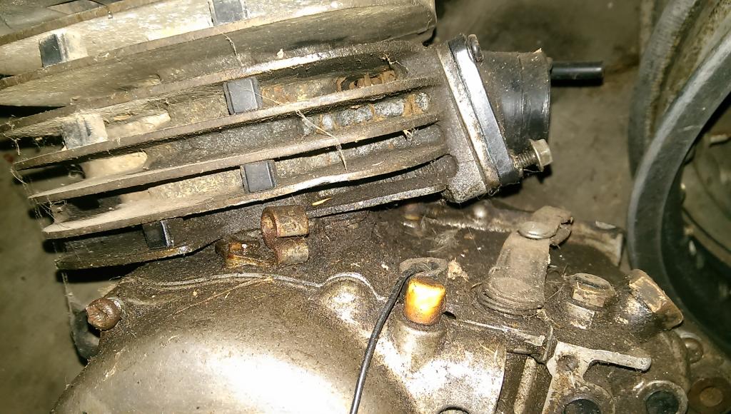

jc2 Posted January 27, 2015 Report Share Posted January 27, 2015 With a DT A/B/C cylinder you need to alter the bottom fins & attach the TY175 clutch cable holder (or similar) to make the clutch operable. (On the DT175s, the cable holder was on top of the crankcase & part of it.) 1 Quote Link to comment Share on other sites More sharing options...
feetupfun Posted January 28, 2015 Report Share Posted January 28, 2015 Photo of DT175A motor to illustrate the mods mentioned by jc2 Quote Link to comment Share on other sites More sharing options...
