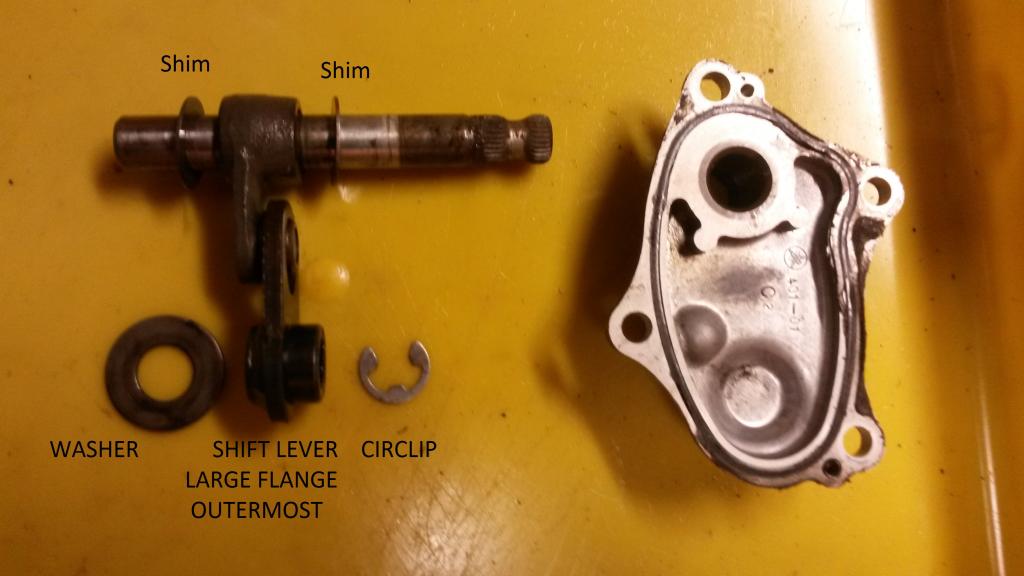

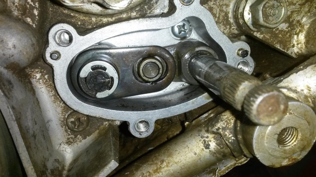

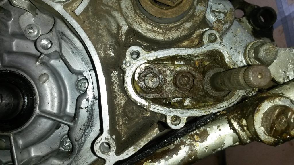

ourian Posted January 31, 2015 Report Share Posted January 31, 2015 Ourian, interesting. Can you please explain more what you meant regarding Shift 4 Lever? That was an issue for me during assembly. I was not 100% sure about its orientation upon assymbly as it has a larger flange/lip opening on one side than the other. Plus I thought the circlip wasn't really fitting snugly into a slot. Also, when I accomplished the replacement, I can't recall if I was in neutral or in gear. The instructions never specified and I never though differently. Is that an issue that could be jamming things up near the shift lever area? Thanks. As it happens I've just stripped one apart, I noted that the larger side of the flange is outermost and the shift lever should point at the gear lever shaft with more or less an equal space either side of the shift lever. Apologies for all the crud but it's a photo I took whilst stripping it apart. I'd make sure it is in neutral when assembling as this will keep everything centralised. Quote Link to comment Share on other sites More sharing options...

ourian Posted February 1, 2015 Report Share Posted February 1, 2015 Ok so I've stripped my best bike apart, look no crud. Here's detailed photo of how it all goes together, the larger side of the flange on the shift lever is definitely outermost. 1 Quote Link to comment Share on other sites More sharing options...
motosolex Posted February 2, 2015 Author Report Share Posted February 2, 2015 Ach-soo Ourian. Thanks so much. I will assymbly it as you. Interesting that up the instructions posted by hyperlink above say contrary. How did you add the writing onto you picture? Are you going with theTrailTrials shifter Kit as well? Thanks Quote Link to comment Share on other sites More sharing options...
ourian Posted February 2, 2015 Report Share Posted February 2, 2015 No worries Motosolex, added writing by opening photo with microsoft paint and adding text box. There's no need to upgrade the shifter on my best bike, it's like new, but on the renovation project the one with the crud, I'm going to look at making the modification myself as have access to a lathe. Quote Link to comment Share on other sites More sharing options...
