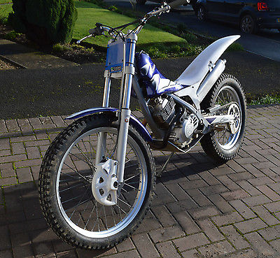

steve_earle Posted February 5, 2015 Report Share Posted February 5, 2015 I can't seem to picture a 98 Scorpa tys 125, I'm not aware of such a model. If It does exist it will surely have a disk front brake, Why on earth would you want that on a BSA?? Post a picture of the Scorpa so we can see what it is. Quote Link to comment Share on other sites More sharing options...
Prototype Posted February 6, 2015 Author Report Share Posted February 6, 2015 Hi steve This one is scorpa 2004 model similar to that .. yes correct it have disk brake . What are other options i have for forks.. I thinking for going to bike breaker .. to be honest im bit lost .. P.S @suzkui250 thanks for yr reply as well .. Quote Link to comment Share on other sites More sharing options...
suzuki250 Posted February 6, 2015 Report Share Posted February 6, 2015 Hi steve This one is scorpa 2004 model similar to that .. yes correct it have disk brake . What are other options i have for forks.. I thinking for going to bike breaker .. to be honest im bit lost .. No bigger than 35mm in diameter, early Spanish forks and wheels are a popular choice You will never get the approval of the classic brigade, but they seem to have a lot of time to worry about trivial matters (while they are having some fiddle forks made) Quote Link to comment Share on other sites More sharing options...
