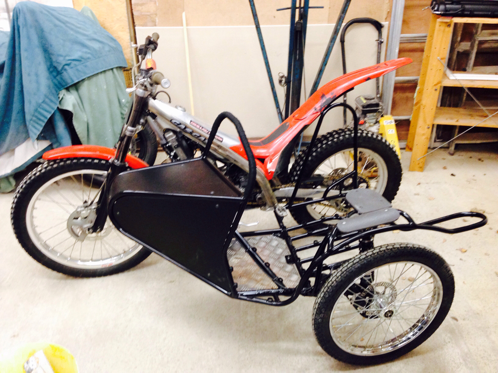

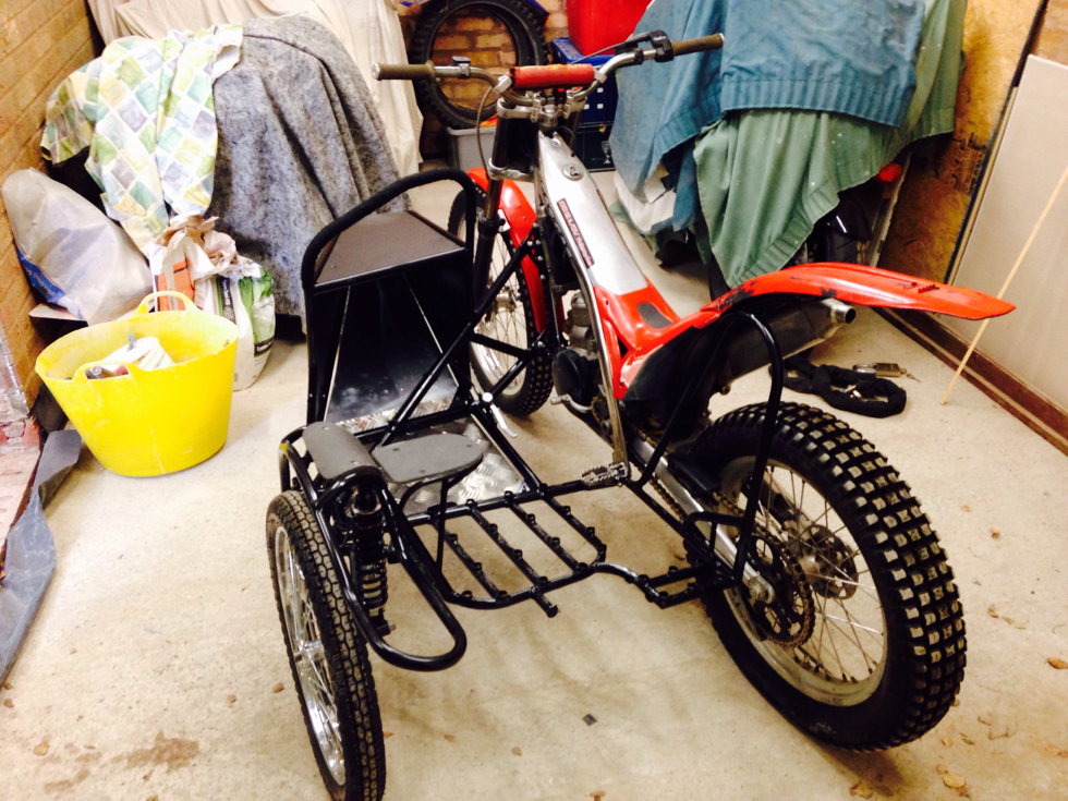

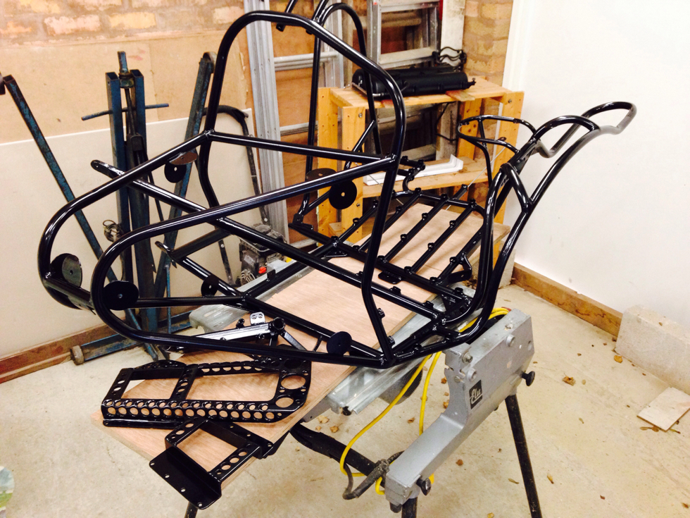

raygrilli Posted February 24, 2015 Report Share Posted February 24, 2015 (edited) Thought I'd share my new sidecar outfit. I made the chair as a close copy of a Rushton a colleague lent me that he uses with a Montesa. Tubing is 19mm x 1.6 and 25mm x 2.5mm. Chair wheel lead is 10.0''. Shock is from Falcon. Wheel hub is an unknown brand with 20mm ID bearings. Rim is 17'' x 1.2'm Honda Cub with tyre to suit. Brake is Hope. Swing arm is on nylon bushes and bronze sleeved shaft - thought I'd try without roller bearings and see how long it lasted...at least it won't seize with rust! Bike is a 2002 Gasgas 250 Pro. First outing last weekend was entertaining to say the least. Hope to do some club trials at Mansfield Maun and see how we get on... Edited February 24, 2015 by raygrilli 1 Quote Link to comment Share on other sites More sharing options...

slicktop Posted February 24, 2015 Report Share Posted February 24, 2015 You built a beautiful car. My only hope of owning one is to do the same as you, but your skills show. Mine would too, but in the wrong direction. haha The tabs connecting the car to frame looks like they would wiggle the fastener. Perhaps I cant see whats really going on though. My preference would be an eye/jaw arrangement. Quote Link to comment Share on other sites More sharing options...
