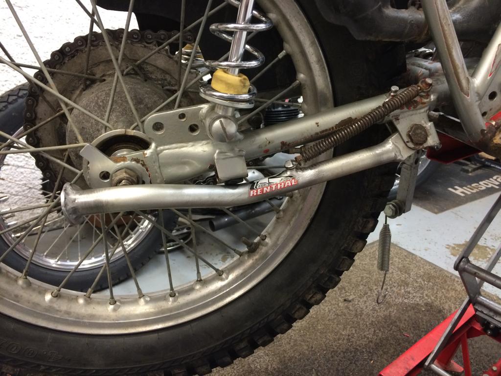

millerme Posted February 25, 2015 Report Share Posted February 25, 2015 does anyone have a drawing of a side stand that I can use to fab one up for my 199A model Quote Link to comment Share on other sites More sharing options...
lbhbul Posted February 25, 2015 Report Share Posted February 25, 2015 There is a whole lot of work to fab one from scratch, if you can find one from a mod 159 for sure & up not much to adapt to your bike, maybe from earlier also not sure. Good luck Larry Quote Link to comment Share on other sites More sharing options...
trialsrfun Posted February 26, 2015 Report Share Posted February 26, 2015 does anyone have a drawing of a side stand that I can use to fab one up for my 199A model There are replica stands for the 199a which are made from alloy for sale on that auction site, not cheap but they do look to be made properly. Quote Link to comment Share on other sites More sharing options...

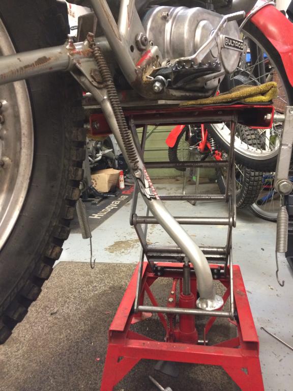

watch this Posted February 26, 2015 Report Share Posted February 26, 2015 I cut down a set of old Renthals! fabbed a mount & foot, welded it all up & Roberts your Fathers brother. I can take some better pics if needed. Quote Link to comment Share on other sites More sharing options...
millerme Posted February 26, 2015 Author Report Share Posted February 26, 2015 hi mate cracking idea that's what I will do many thanks mate for the idea Quote Link to comment Share on other sites More sharing options...
johnjsy Posted February 26, 2015 Report Share Posted February 26, 2015 Hullo,I like that! A suggestion if I may,contact In Motion as they have the correct shouldered bolt & nut for sidestands. It will make the job a good un. My Metralla had no stand,so I made a side stand out of a bicycle handlebar. It works fine but I am very cautious of parking on a windy day. To make & weld on some brackets would entail stripping out the entire bike to get the frame upside down to do the job properly. One day,I suppose. Hope this helps,John. Quote Link to comment Share on other sites More sharing options...
