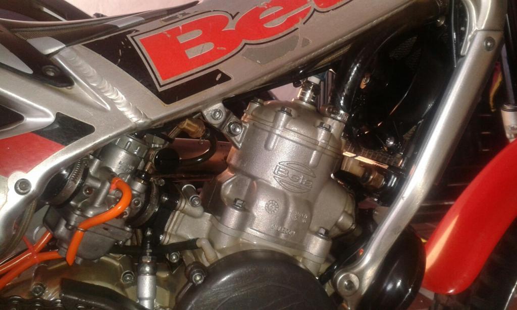

podracer Posted March 28, 2015 Report Share Posted March 28, 2015 (edited) hi, Im about to get the OEM Tank Decals for my Rev 3.. The old one are reallly cracked and heavily discolored. My Question is , How Can I remove the old ones..They are really glued in there.... without scratching the Aluminum surface,( did test with a razor blade on a corner and kinda scrathed the aluminum without using heavy chemicals risking staining the aluminum.. or even worse.. destroying my fingers..since ive tried removing a little piece , and is just wayyy too difficult .. Had everyone mastered this technique ? Sorry, is this topic has been already posted..but i searched all the way thru page 64 here..and found nothing... and got really sleepy yesterday night. Thanks in advance. Edited March 28, 2015 by podracer Quote Link to comment Share on other sites More sharing options...
copemech Posted March 28, 2015 Report Share Posted March 28, 2015 Heat! Use a hair drier and get a sharp edge plastic thing to push with to save finger nails! Any solvent should take care of any remaining adhesive. 1 Quote Link to comment Share on other sites More sharing options...
barfy Posted March 28, 2015 Report Share Posted March 28, 2015 You could use a heat gun, but remove any plastics that are within range. Then use WD40 to remove the solvent and finally brake cleaner to remove the WD40. When putting on new stickers get water with a few drops of washing liquid in a spray bottle and put a fine mist on the surface of the frame and sticker. Then you can move the sticker slightly and push out any air bubbles. 1 Quote Link to comment Share on other sites More sharing options...
graham66 Posted March 28, 2015 Report Share Posted March 28, 2015 Hello, try using dental floss to remove stickers then a cloth soaked in white spirit to remove adhesive residue. Could warm first with a hair dryer to soften adhesive. regards 1 Quote Link to comment Share on other sites More sharing options...
podracer Posted March 28, 2015 Author Report Share Posted March 28, 2015 Well, that heat gun ... why didnt I figure that one out ?? Im supposed to receive the new ones next week, Ill post the results after your advices.. Many thanks graham66 barfy copemech Quote Link to comment Share on other sites More sharing options...
