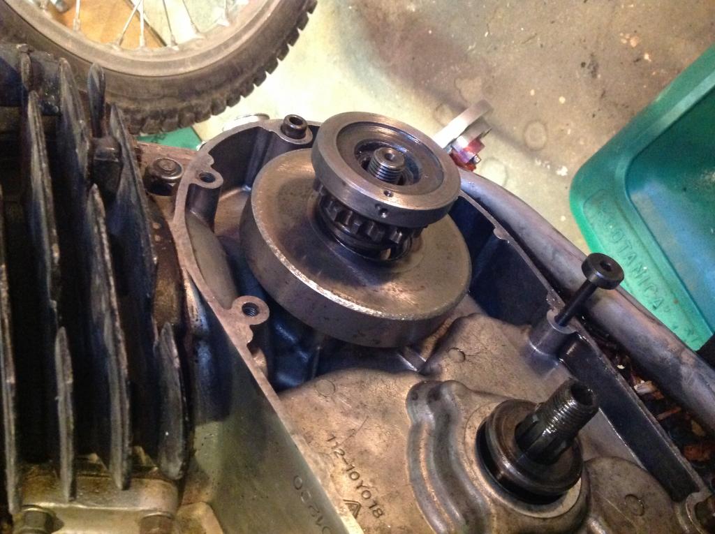

sherpated Posted March 30, 2015 Report Share Posted March 30, 2015 Hallo . This is my first post. I would appreciate it I could pick your brains guys. I´m in the process of stripping my Alpina type 188 350 engine down which is sitting in a 159 chassis. I bought it about a year ago and had a fair bit of trouble getting it to run properly since. I have done several trials on it so far but its constantly giving me starting troubles. Over the last year its broken a woodruff key on the ignition side (fitted with electronic) Then another time, a primary chain tensioner broke. Now, again it has stopped running...possibly due to the flywheel on the clutch side? Im pretty sure it was in one piece the last time I checked! I am starting to wonder if something is off balance? I know the bearing race on the ignition side behind the flywheel looks a bit ragged could the crank be vibrating and throwing stuff off balance. Is it at all the right flywheel? The first picture shows the flywheel hanging on the shaft . Any help appreciated!! Quote Link to comment Share on other sites More sharing options...

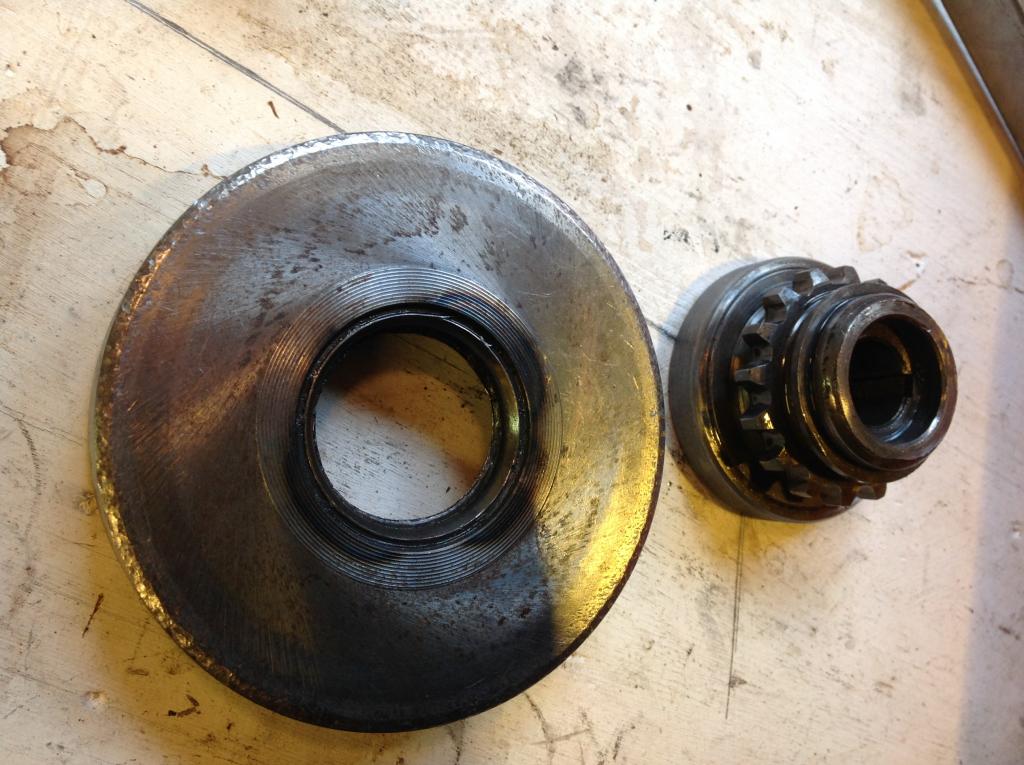

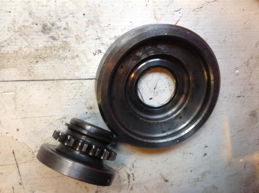

smelling123 Posted March 30, 2015 Report Share Posted March 30, 2015 Yes, it should all be in one piece (both flywheel cheeks with the sprocket in the centre. It looks like your outer flywheel cheek has been machined down -ts smaller than a sherpa which has both cheeks the same diameter - I may be wrong as ive never worked on an Alpina. It also looks like they tried to balance it - see the holes drilled in it. Suggests they knew what they were doing. I'd just get another one - reasonably easy to find.. Quote Link to comment Share on other sites More sharing options...
woody Posted March 30, 2015 Report Share Posted March 30, 2015 Can't tell you if that's the right weight for an Alpina as never had one, but on the Sherpa double weight, the inside weight is welded on. I have one that the weld has broken on and it's in two pieces like yours. Can't see any trace of weld in your pictures but maybe that's what's happened. If the inside weight was loose then it could have caused vibrating which may cause a problem with your crank and may give an air leak through the ignition side seal? A 250 Sherpa weight looks as though it would be about the same weight as yours, they are often on ebay, you could try one of those, or a 325 Sherpa weight (not sure what a 350 Alpina is supposed t perform like but obviously, the lighter the weight, the quicker the engine picks up) I'd replace the crank seals, sort the weight and try it again. You'll soon know if you have to strip and replace mains. Quote Link to comment Share on other sites More sharing options...
woody Posted March 30, 2015 Report Share Posted March 30, 2015 I wondered if it had been machined down but the holes threw me. Never thought they might be to balance it. I tried machining a Sherpa one down recently. Nothing came off it and I just got a squealing noise... Pays to know what you're doing I guess before trying to machine what is probably case hardened (what ever that means) metal... Quote Link to comment Share on other sites More sharing options...
sherpated Posted March 30, 2015 Author Report Share Posted March 30, 2015 thanks guys for the quick feedback.I think ill try and pick up a sherpa flywheel. Funny its broke but Im in doubt whether to get a heavy sherpa flywheel or one the same weight.Woody, You said that the lighter the flywheel the faster the pick up. That sounds logical, bur are there any advantages of a heavier one in the sections and are there any disadvantages for the balance of the crank? Quote Link to comment Share on other sites More sharing options...

lorenzo Posted March 30, 2015 Report Share Posted March 30, 2015 (edited) I go along with the general consensus that the outer part of the driveside flywheel has been machined down, although I don't know what a model 188 flywheel should look like, either. However, I don't think the holes drilled in it will balance anything - least of all a plain circle flywheel that shouldn't need balancing anyway (i.e. it's not a crankshaft flywheel with bobweights, etc.) - surely the holes are for lockwiring the crank end nut.?..... As already pointed out, the two parts of this flywheel were originally welded together - I have a number of driveside weights in the shed (including a Sherpa 325 item that has what looks suspiciously like a crack through most of the weld); don't recall any signs of balancing on any of them. Disclaimer : my memory's not what it used to be !! Edited March 31, 2015 by lorenzo Quote Link to comment Share on other sites More sharing options...
