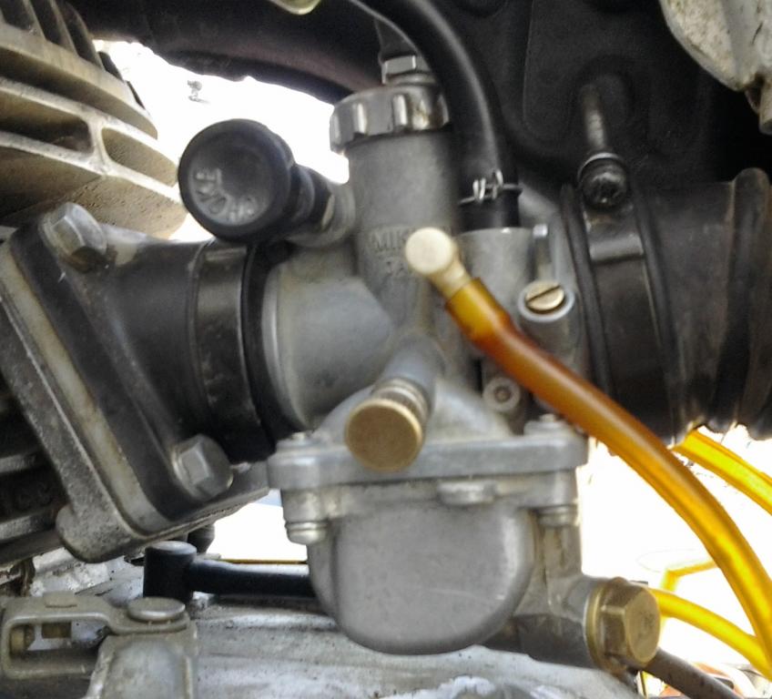

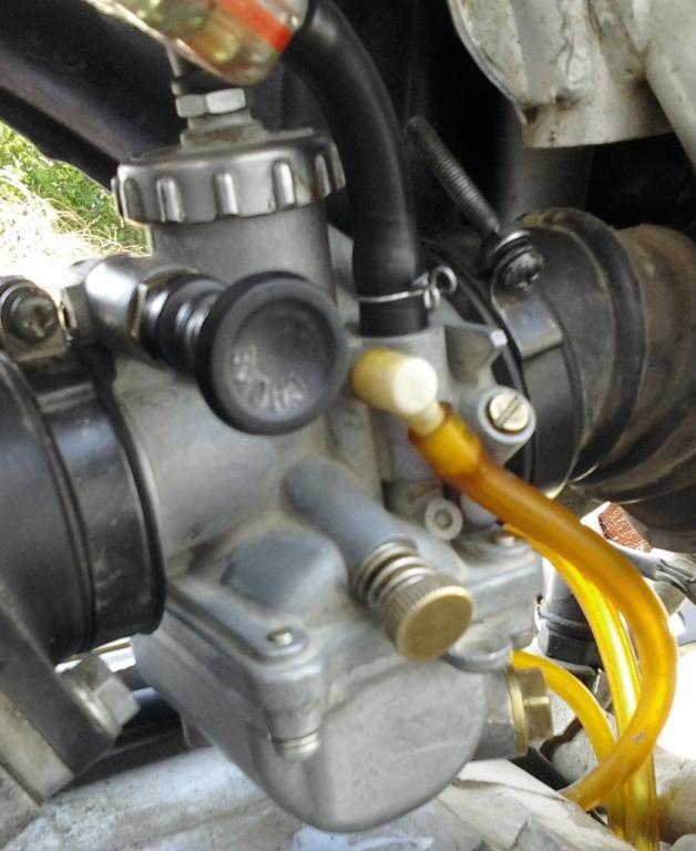

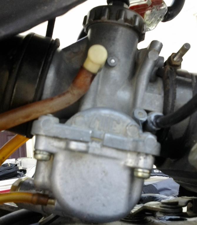

fulltilt Posted April 18, 2015 Author Report Share Posted April 18, 2015 Here's the pic's. The throttle slide is about 23mm OD. After cleaning the carb, it ran much better, but still lean, so I know I have to re-jet. It is actually 4,000 feet higher where this came from. I'll move the needle up one clip until I can get the right jets. The rubber "O-ring"n on the main needle tube and main jet screw look a little rough. Can I get them at any shop that sells mikuni's? Quote Link to comment Share on other sites More sharing options...
feetupfun Posted April 19, 2015 Report Share Posted April 19, 2015 You can get those orings from bearing shops I think that is the 525 model carby. It should be stamped 525 on the side of the body If it is 525 model Yamaha-Mikuni, the standard main jet is 240. I run 220 main at sea level and 200 main at 3000 feet ASL on that carby with a standard TY175 motor, reeds, air filter box and exhaust The standard pilot jet is usually fine at sea level and at 3000 feet, as is the standard needle clip position 1 Quote Link to comment Share on other sites More sharing options...
