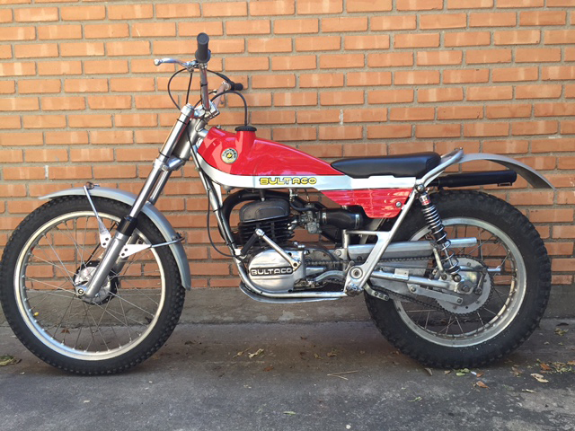

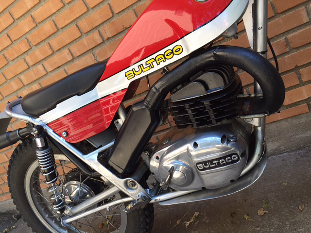

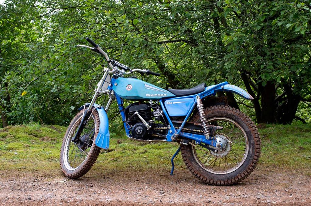

bultacorock Posted July 7, 2015 Report Share Posted July 7, 2015 (edited) W-HAY my attachment folder was full so i emptied it apart form my gallery on my profile page ( I used up 15mb space posting photos on here ) Thank for your feed back Larry and here are some photos of me and my bike, i have fitted some new bit with the help of friends, i will make some more photos next time i get her out for a ride. BR Edited July 8, 2015 by bultacorock 6 Quote Link to comment Share on other sites More sharing options...
lbhbul Posted July 8, 2015 Report Share Posted July 8, 2015 (edited) Good photos, glad you figured things out.Your bike has some interesting features that make it better in my eyes; M159 style air box , LH brake pedal, original style tank, early SM rear brace on front fender, (I should have done this) prevents bashing M199 brace into down tube. Very nice machine. Larry Edited July 8, 2015 by lbhbul 1 Quote Link to comment Share on other sites More sharing options...
bultacorock Posted July 9, 2015 Report Share Posted July 9, 2015 (edited) Here is an more up to date photo of my bike, i like having the gear lever on the right, i can set it a bit higher and out of the way of rocks and stuff. Your right the rear brace on the front fender works well on drops and in the mud. I keep looking what friends and riders on here are doing to there bikes, to get ideas on what to do next. I would not have been able to figure it out with out your help Larry so thanks for all the great posts on here. Joe PS the tanks colour looks really good on here but its more a bluey greeny colour Edited July 9, 2015 by bultacorock 6 Quote Link to comment Share on other sites More sharing options...

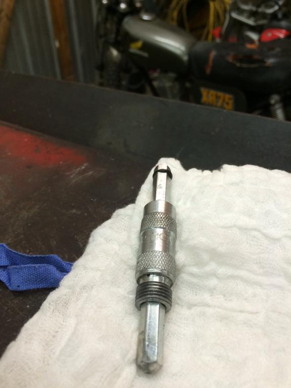

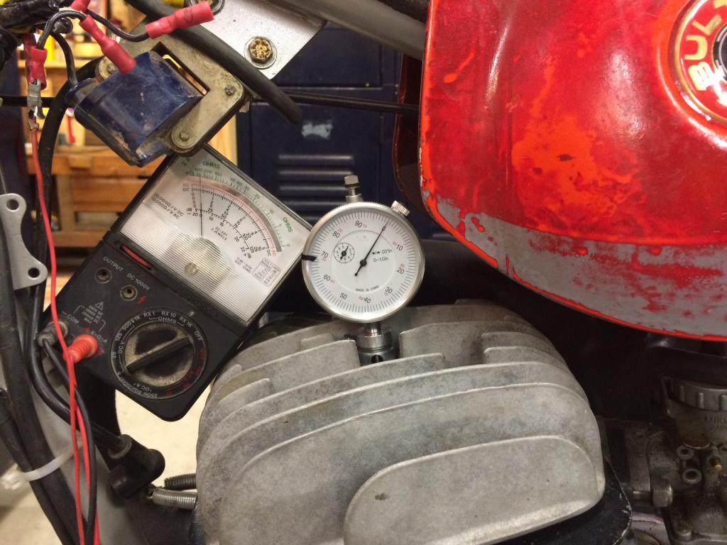

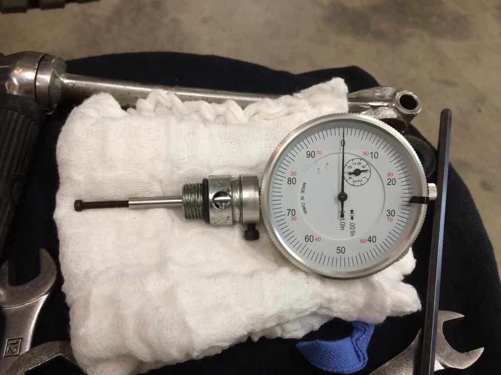

saw miller Posted July 14, 2015 Report Share Posted July 14, 2015 Finally got around to timing the rat with a dial indicator using the adapter lbhbul made for me. I was using a stick indicator, but the dial is much more accurate. The adapter was milled out of a spark plug base. Pretty slick! Tripp 5 Quote Link to comment Share on other sites More sharing options...
nigel dabster Posted July 14, 2015 Report Share Posted July 14, 2015 ditch the meter and use a small bulb its much easier to set points. Quote Link to comment Share on other sites More sharing options...

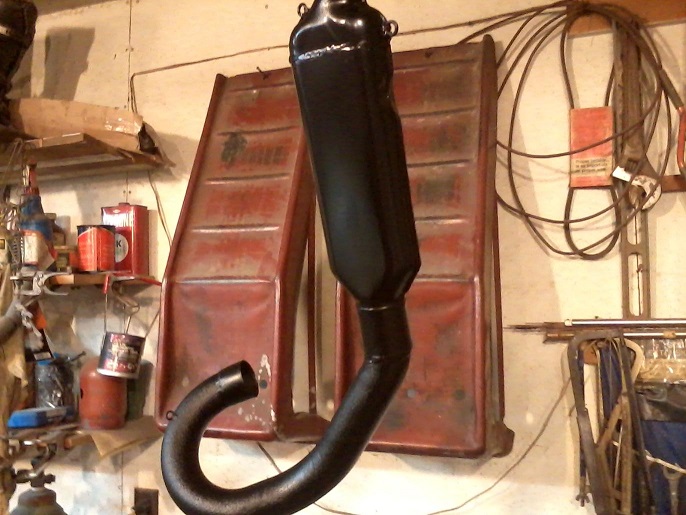

lbhbul Posted July 15, 2015 Report Share Posted July 15, 2015 (edited) Doesn't seem to be much going on in our Bultaco community,so we will tear a mid muffler up and put it back together. Spot welded? My first ever, also welded to perforated tube? [ now to get it packed and back together [ all brazed up All done Have a good day Larry Edited March 30, 2016 by lbhbul 5 Quote Link to comment Share on other sites More sharing options...
robbiesty175 Posted July 16, 2015 Report Share Posted July 16, 2015 Sending Larry more stuff so he can keep working and sharing his great work!!! That pipe looks awesome and will sound even better! Going to try your hand at welding the Miller midbox too?!?!? Quote Link to comment Share on other sites More sharing options...
lbhbul Posted July 16, 2015 Report Share Posted July 16, 2015 Robbie, I don't think so, not into alloy welding, can barely do anything correctly the first time any more, just keep messing about. Larry 1 Quote Link to comment Share on other sites More sharing options...

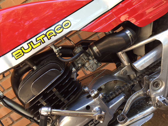

lbhbul Posted August 3, 2015 Report Share Posted August 3, 2015 Due to all my messing about with pipes and whatever I needed to come up with an air box/carb hose that would get around a M92 style frame re. down tube/straight intake manifold. My good friend @ the auto parts store took the time to find this hose for me. after some cut and fit hose is Gates #20849 Have a nice day Larry 6 Quote Link to comment Share on other sites More sharing options...
pschrauber Posted August 3, 2015 Report Share Posted August 3, 2015 That's a very sanitary solution and fits perfect as I can see. 3 Quote Link to comment Share on other sites More sharing options...
