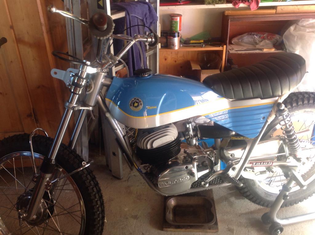

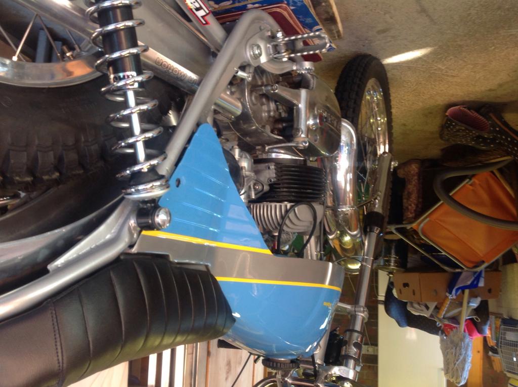

markm85 Posted September 6, 2015 Report Share Posted September 6, 2015 Working hard to complete my Alpina, need to find out if it will spark. Then I'll finish off the exhaust system. Thanks for all the advice I have received. 5 Quote Link to comment Share on other sites More sharing options...
lbhbul Posted September 6, 2015 Report Share Posted September 6, 2015 Mark, coming along very nicely!! Be careful of that what appears to be a very long clutch arm, may just be the photo, but it really needs to be as straight a pull as possible. Beautiful work and attention to detail. My last M85 was just OK compared to yours. Have a good day Larry Quote Link to comment Share on other sites More sharing options...

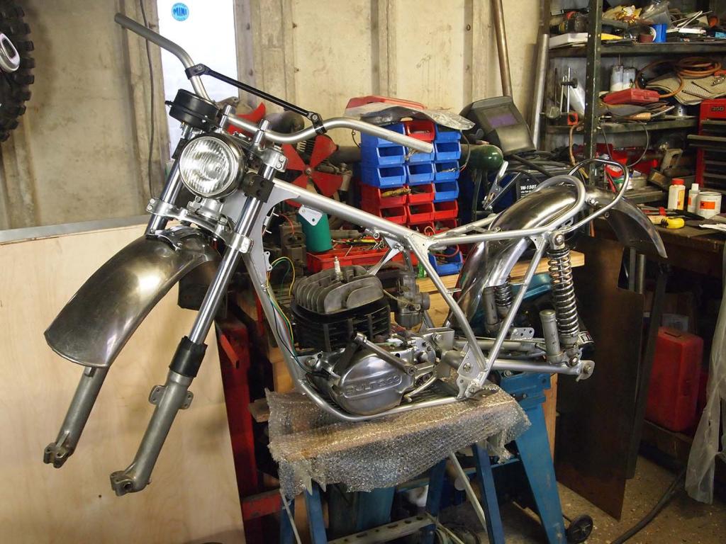

twinnshock Posted September 12, 2015 Report Share Posted September 12, 2015 I picked up the frame of my M166 Alpina from the powder coating firm this morning. Spent the day starting the final build. Forks and rear shocks only fitted temporary as I still have to polish and paint these items. Mudguards are original and are stainless steel. Stuart 6 Quote Link to comment Share on other sites More sharing options...

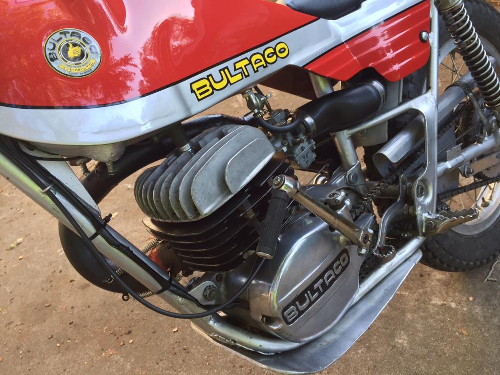

lbhbul Posted September 17, 2015 Report Share Posted September 17, 2015 Well fellows , nothing going on huh??? Finished up the M125 ref,pg 11 this topic. Spit and polish, EQUALS happy FRIEND Larry 5 Quote Link to comment Share on other sites More sharing options...
markm85 Posted September 17, 2015 Report Share Posted September 17, 2015 Hi Larry, That looks really good. Regarding clutch arms, it's around 75mm between the centers is that too long? R Mark Quote Link to comment Share on other sites More sharing options...
lbhbul Posted September 18, 2015 Report Share Posted September 18, 2015 Mark, my clutch arm is roughly 59mm between centers, I also had front brake lever that some Sherpa Ts' came with and it is around 75mm c/c. I believe the longer lever will work, however you might take a look at your front brake lever. Which ever you use, rig it so the cable pulls as straight as possible. The arm works best for me when setting as near perpendicular as possible. Have a nice day Larry 1 Quote Link to comment Share on other sites More sharing options...

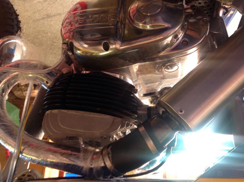

lineaway Posted September 21, 2015 Report Share Posted September 21, 2015 Due to all my messing about with pipes and whatever I needed to come up with an air box/carb hose that would get around a M92 style frame re. down tube/straight intake manifold. My good friend @ the auto parts store took the time to find this hose for me. Picture0725150942_1.jpg after some cut and fit Picture0724151535_1.jpg hose is Gates #20849 Picture0724151420_1.jpg Have a nice day Larry Thanks again Larry! 6 Quote Link to comment Share on other sites More sharing options...

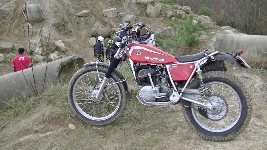

guys Posted December 6, 2015 Report Share Posted December 6, 2015 This week I also have been mostly putting new stickers on the fuel tank, riding around a bit and taking pictures of my bike, which is nice. 4 Quote Link to comment Share on other sites More sharing options...
