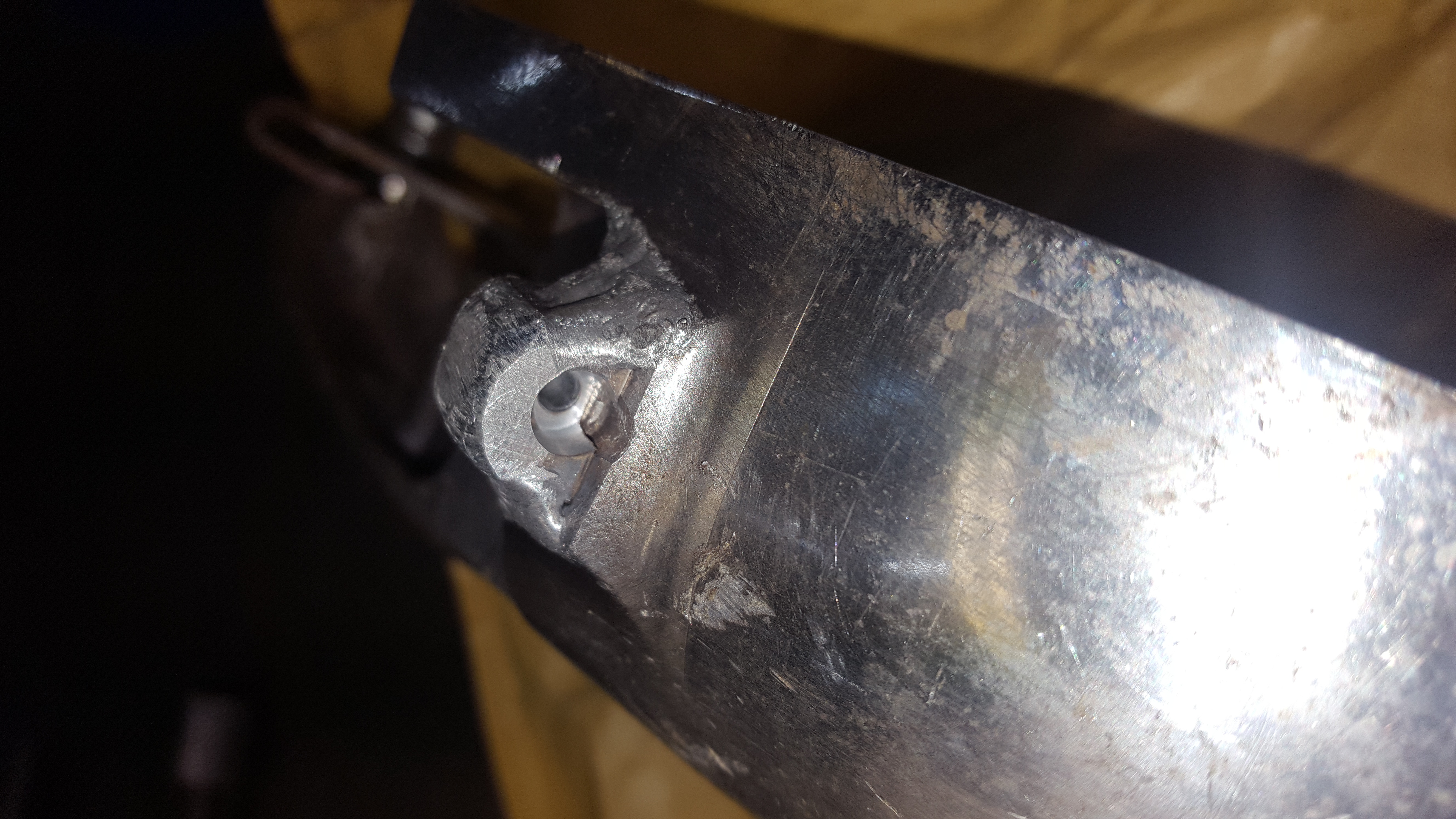

blueflag Posted February 20, 2018 Report Share Posted February 20, 2018 Went to fit a replacement left side engine cover on my M49 with one I bought on eBay. To my dismay the clutch cable anchor point had been snapped off! Not to be deterred, I filed it flat and machined a block to replace it. Got my mate to fire up his Tig welder and job is a good un! I'm not sure how its meant to look so iĺl try and post a photo. Not sure if it should have a slot in it... 2 Quote Link to comment Share on other sites More sharing options...
bullylover Posted February 21, 2018 Report Share Posted February 21, 2018 Hi Blueflag. Yes they should have a slot in the top only the width of the inner cable though. Graham. Quote Link to comment Share on other sites More sharing options...
blueflag Posted February 21, 2018 Report Share Posted February 21, 2018 Thanks Graham, suspected as much ! 1 Quote Link to comment Share on other sites More sharing options...
mrb505 Posted February 21, 2018 Report Share Posted February 21, 2018 Being a 49 it wont have the slot I think all the solderless nipple bikes don’t have a slot 3 Quote Link to comment Share on other sites More sharing options...
blueflag Posted February 21, 2018 Report Share Posted February 21, 2018 It is indeed a solderless nipple. This forum is amazing! Cheers ? Quote Link to comment Share on other sites More sharing options...

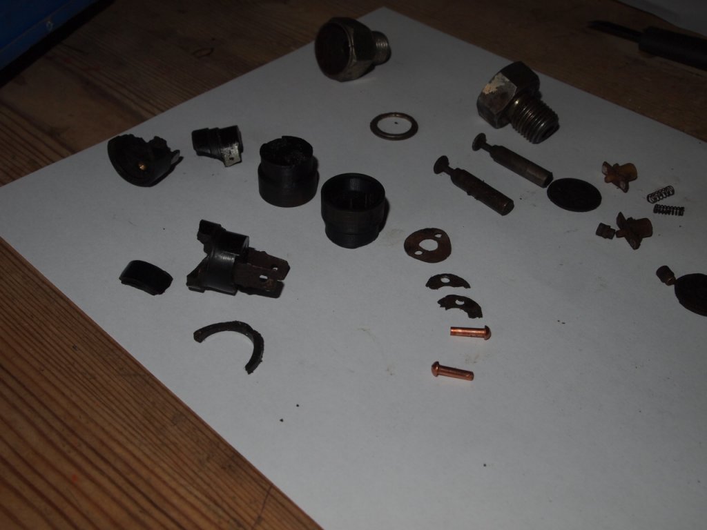

twinnshock Posted April 2, 2018 Report Share Posted April 2, 2018 (edited) I am getting near finishing the restoration of my M188 Alpina. One issue that has been causing me issues is the brake stop light switch. The switch is of an unusal design and exact replacments can not be found. The original switch is held in a normaly closed condition by a tag on the brake pedal and switches to normaly open when the pedal is depressed. I could just fit a more modern part but this would not be my style and most work the other way arond with regard to N/O N/C so would need some rework or wiring change. I have two original switches and both were corroded inside and not working. Both are 40 years old so I will not compalin to FEMSA about quality. They have a plastic housing part that both broke when trying to take the switches apart as they are not designed for disassembly. I have in the past tried gluing similar plastic parts but not had any success. So after all this waffle " What did you do to your Bultaco today?" I 3D modelled the broken plastic part and 3D printed replacements in ABS plastic. The picture shows all the parts of the two switches layed out ready for reassembly. I am using copper rivits to replace the contacts that I had to drill out. I have also lost the saddle that fits the handle bars for the light switch so I will print a replacment part next. Stuart Edited April 2, 2018 by twinnshock 2 Quote Link to comment Share on other sites More sharing options...
lorenzo Posted April 2, 2018 Report Share Posted April 2, 2018 (edited) Stuart - Just one word - BRILLIANT !! Let us know how it works. (You've got me wondering about the switch for my mod. 85 Alpina now.............) Edited April 2, 2018 by lorenzo Quote Link to comment Share on other sites More sharing options...
