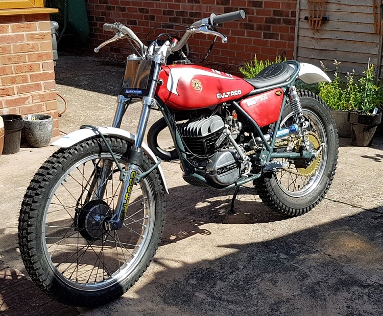

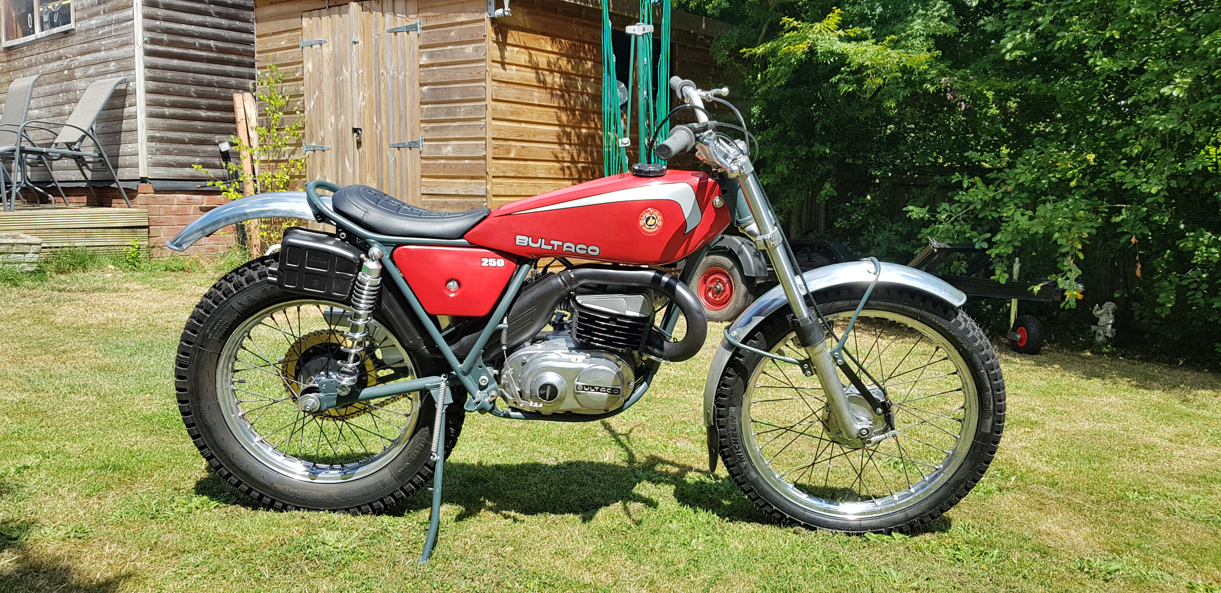

Completed phase one of the Sherpa project.
Phase two will see some mods for actually competing on her
  • 3 weeks later...

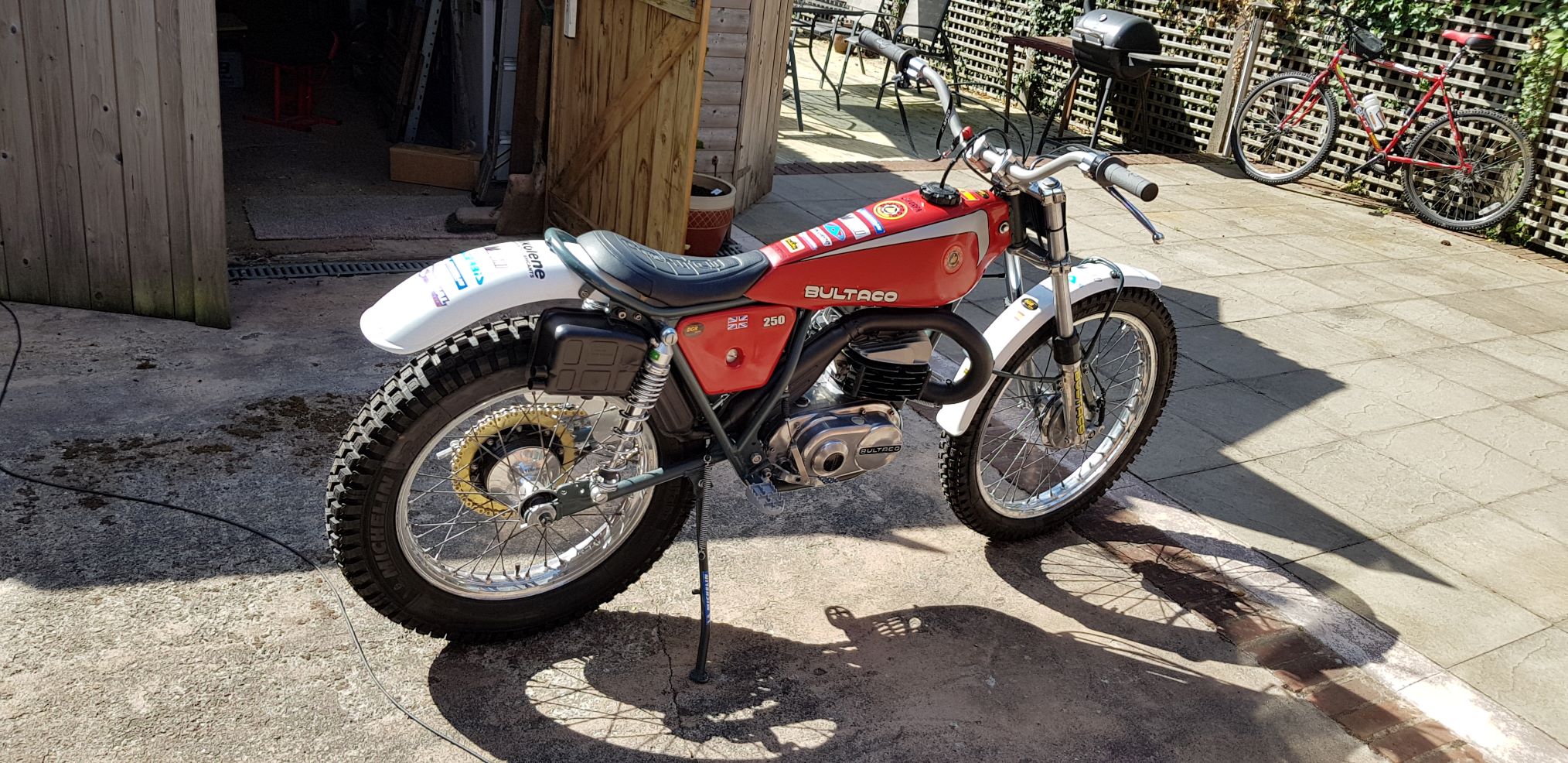

Phase two now completed
Mikuni carb
Electronic ignition
wider foot rests
"raced up" with some stickers and carbon front plate
Xlites
Decompressor
Plastic mudguards
Starts first kick, runs as sweet as a nut :) Just need a free weekend and we're away, ready to roll! :

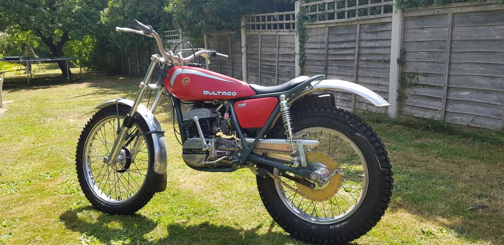

After a long lay off due to other commitments finally she’s done and started second kick, rode her down the drive and back tested all gears worked, set idle and tested kill switch. Now up for sale as another project in the pipeline.

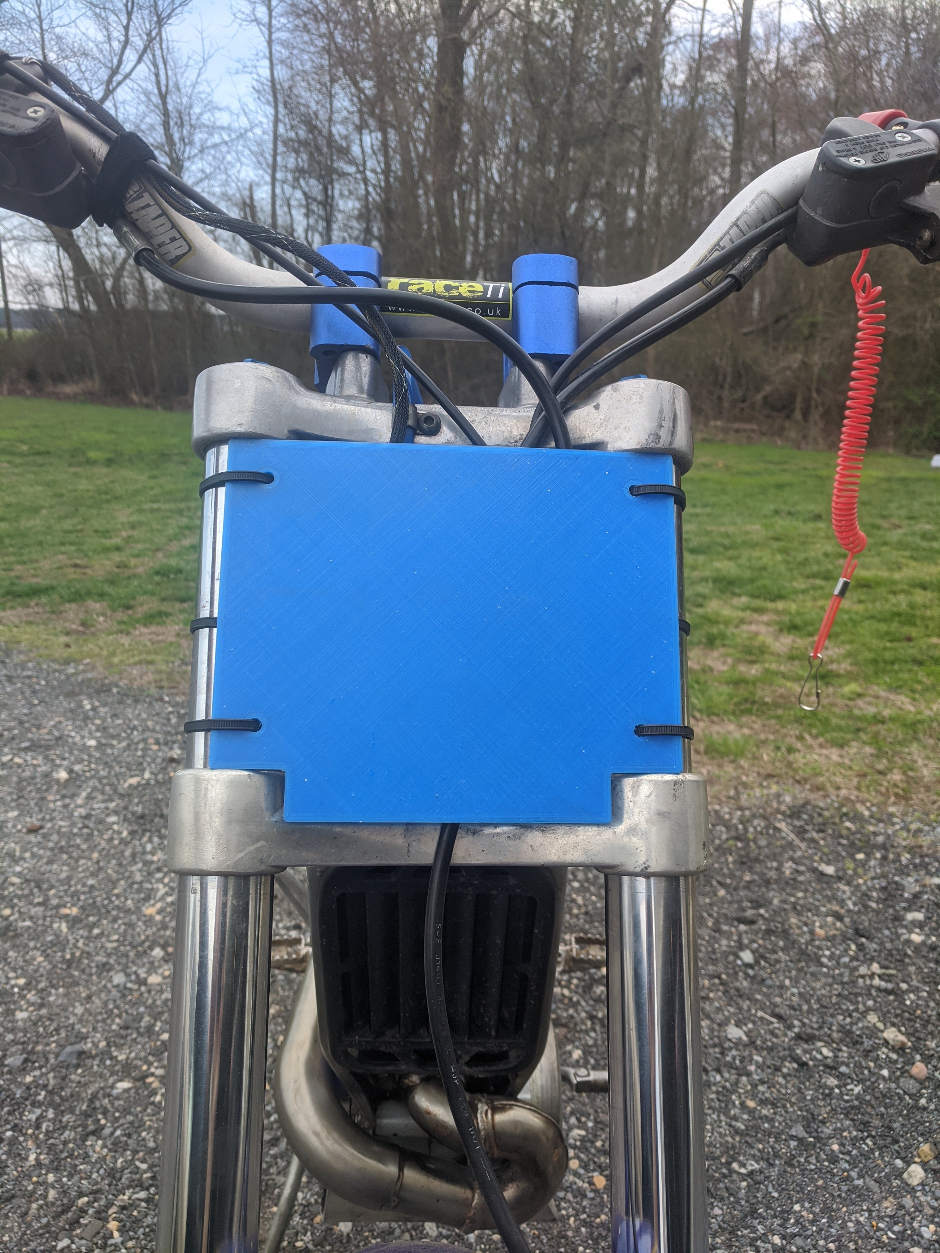

Well I made a retractable registration plate shown in general. And I made a side stand.

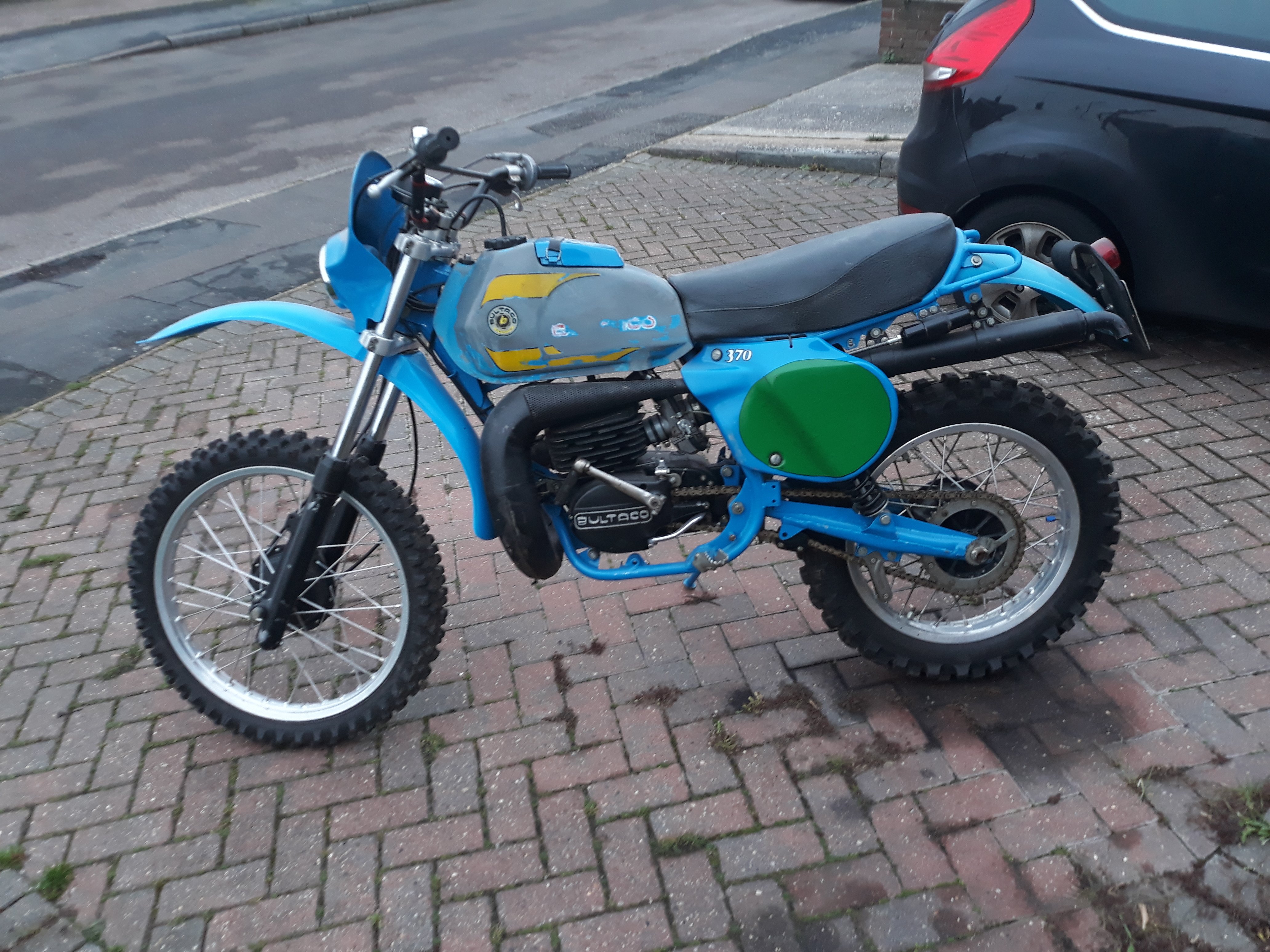

My Frontera's last MOT expired last May. As of last week it is officially 40 years old and now MOT exempt. I went on the DVLA  on line site and payed the VED (Road tax) I had to pay but as from April I can change the taxation class to Historic when the tax becomes free.
I keep all my bikes on a multi bike insurance policy even when out of use so this 40 year rolling MOT exemption is going to be a big bonus. I have 5 bultaco's and a vintage car in the garage and all are now MOT exempt and as from April all will be NIL rate VED
So  what did I do to my Bultaco today? Had a blast round the local area to celebrate. Interesting grip with the Enduro tyres on the cold and damp roads today. Got some interesting looks as I sat waiting for the lights to change at the pedestrian crossing in the high street.
The tank is a recent replacement which I still need to paint. The original succumbed to the effect of ethanol in the fuel. I have also given up with the original no battery electrics as it used to blow brake light bulbs every time I used the bike. Now have a small battery under the seat and LED bulbs front and back. Battery keeps the lights going for several hours before needs charging.

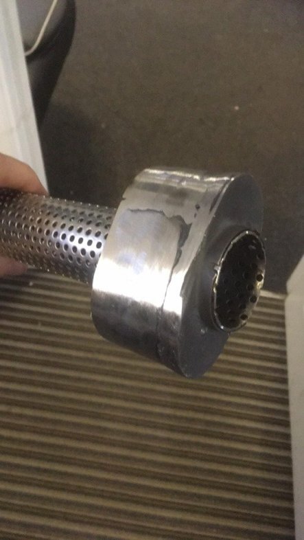

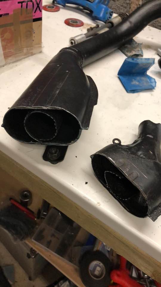

Cut open front pipe, fit new perforated pipe and make up collar to centralise perf, repack and rivet end back on for easy removal to repack in the future.

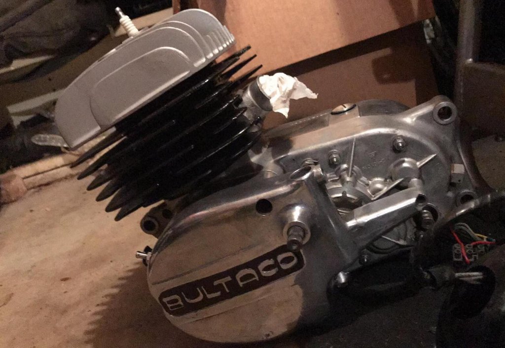

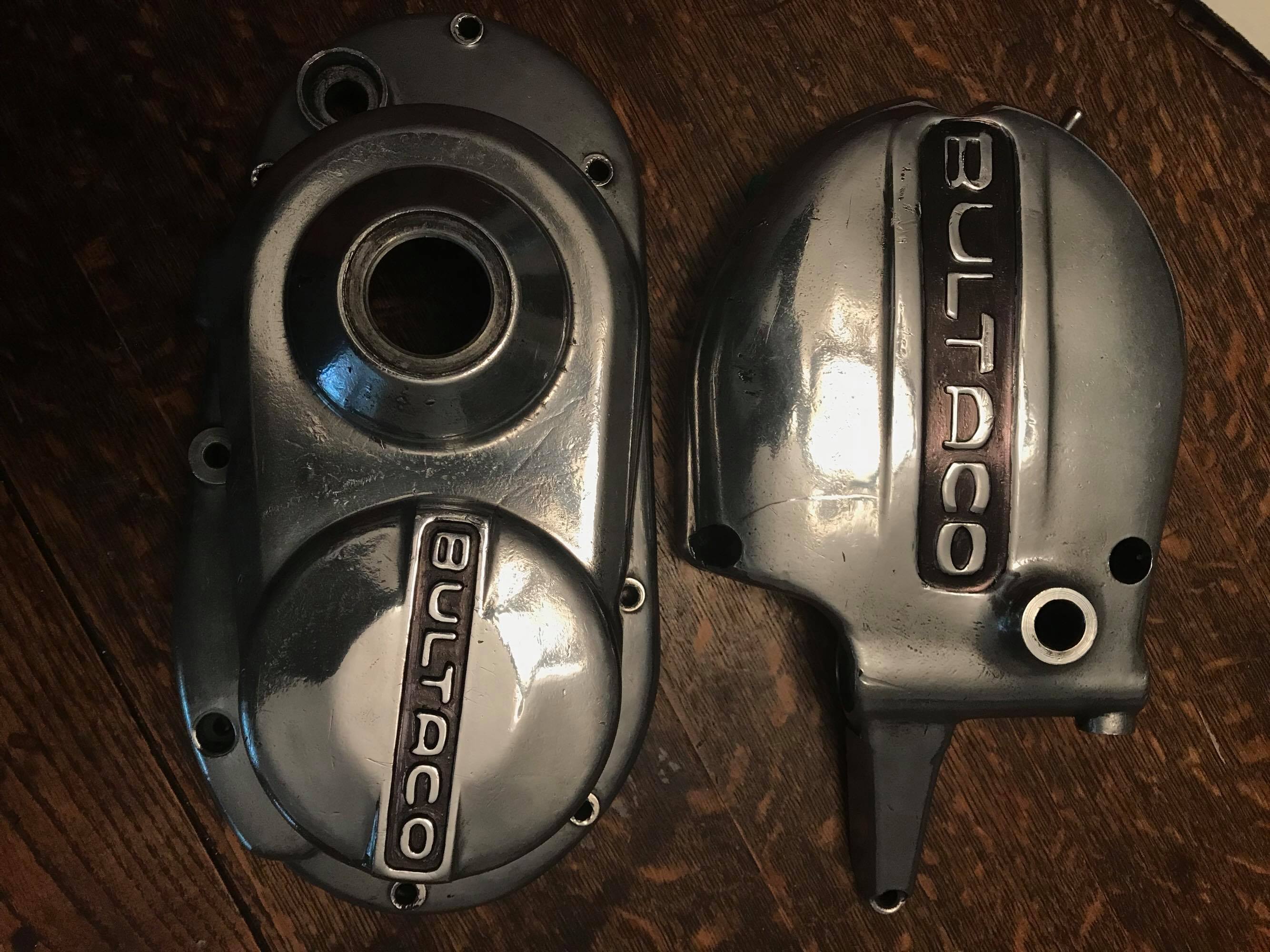

been watching good deals in winter. Purchased 2 engines projects  Astro   250 and matador model 4 both needing lot of polishing and lots oil ,, I really wanted another Astro  , after selling one for parts , so have good 250 with with great crank tight rod , just needs piston and ignition ,
I have parts somewhere , think will put on light. Frame  maby lobo , will post picture
